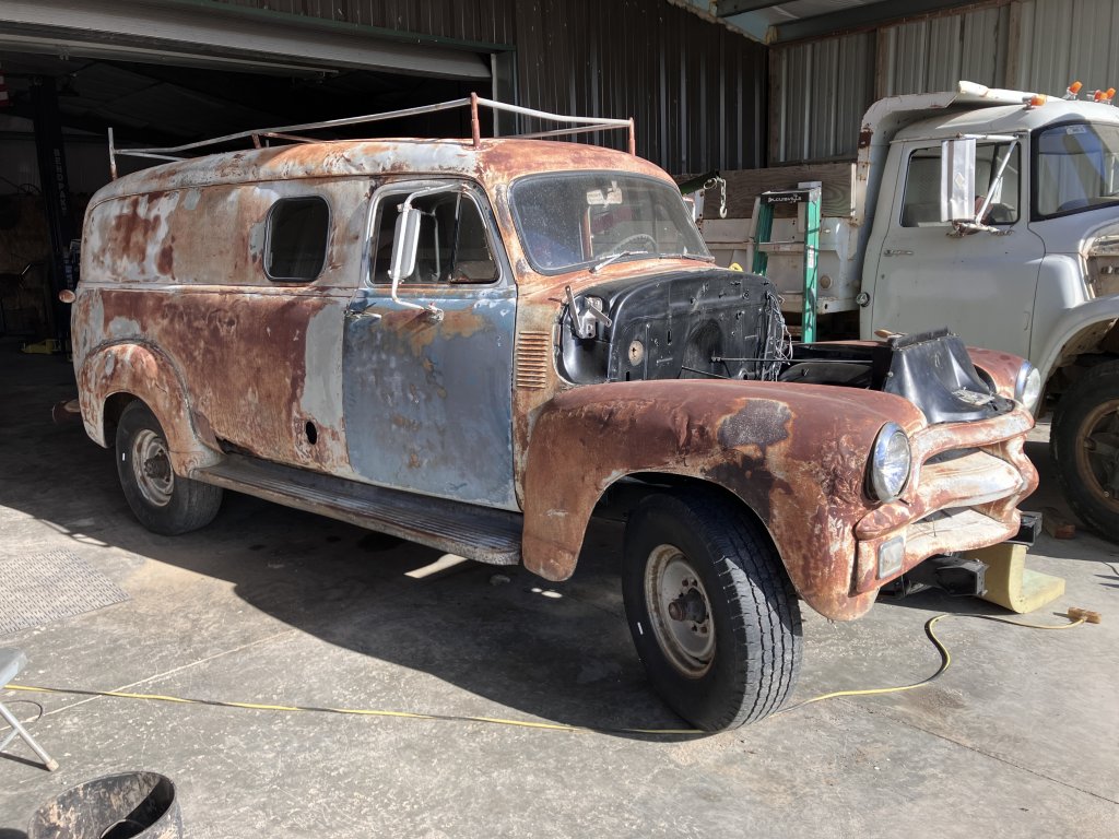

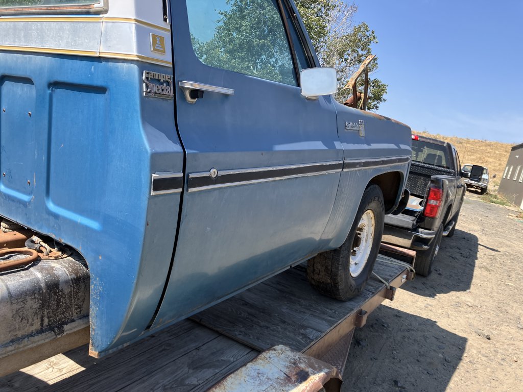

Ok,ok, I have maybe found a better solution then hacking up the truck....trucks. Nab down the road has a short bed fleet side think it is mid 70's been setting at least 10 years, the only rig of 15 that survived the big 2020 fire, though Steve, (the owner) also lost his house in that fire. I stopped by last year and he hemmed and hawed, some interest. Steve said the truck had a 454 in it. My sole purpose for this truck is for Bonneville. I will give him a visit, and see. Also, have two other nab's that have squares, and will contact them, my wife's not gonna be happy as I already have four. My goal in life was never the love of money, but I would feel semi prosperous with a few more squares. All toll, I only have eight no nine trucks....

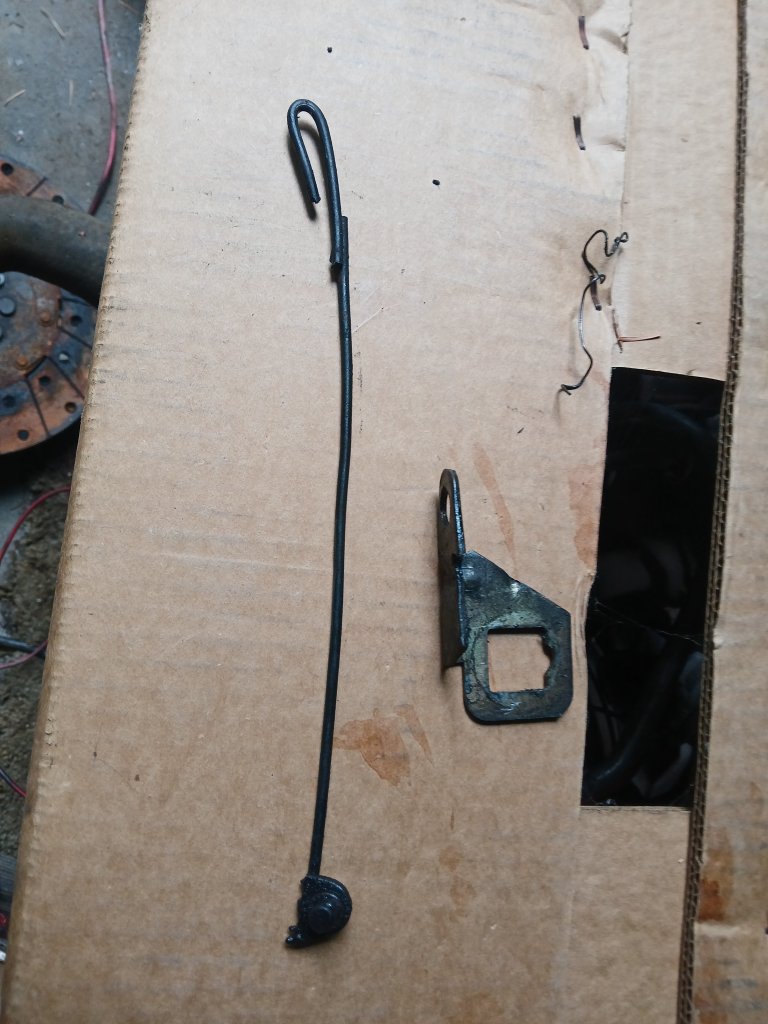

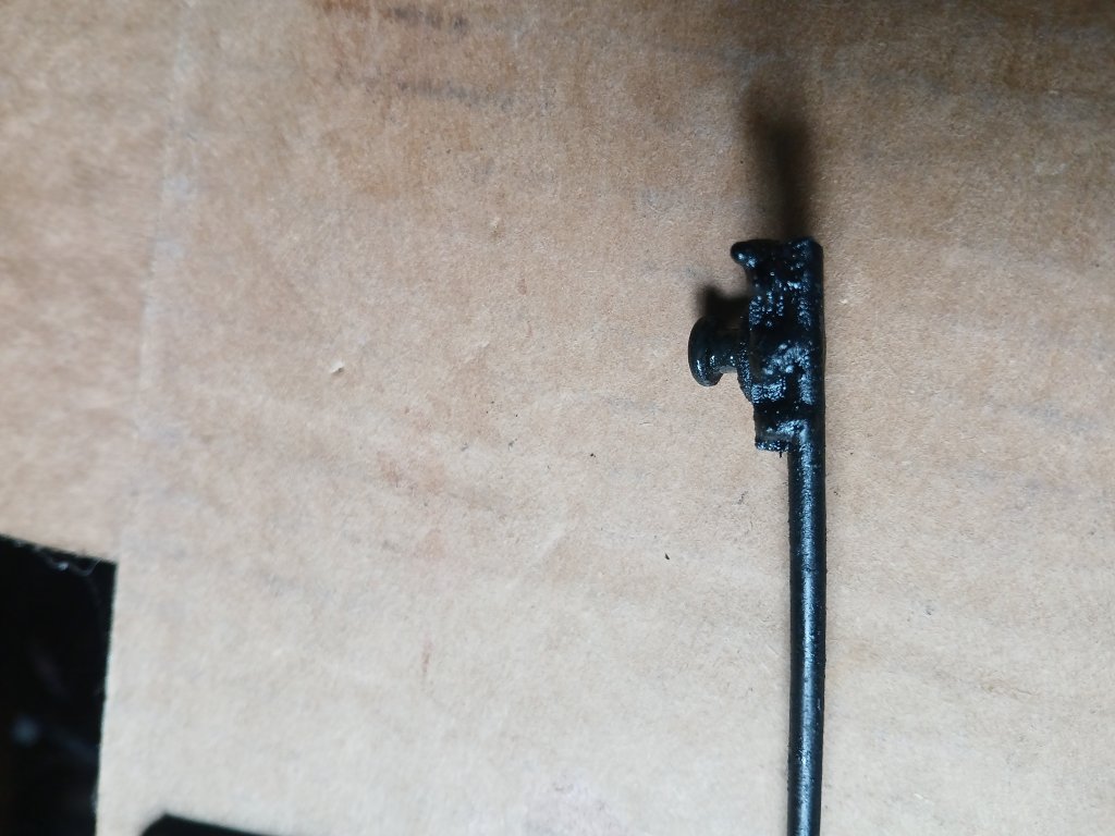

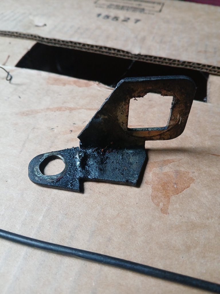

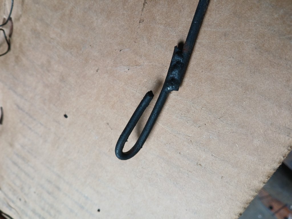

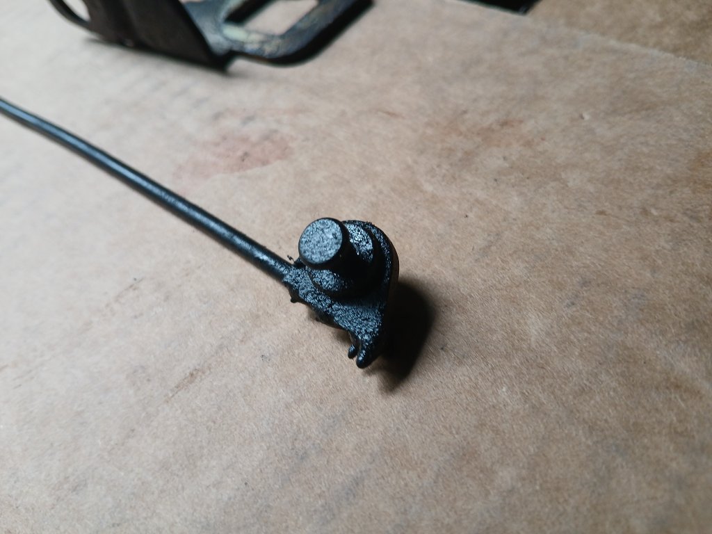

I had to make my own brackets for kickdown cable when i put the R4 in my 6.2 78. They did make them from factory but are hard to find. I can send pics of mine if you want. I just removed all those pieces recently from mine.
I would sure appreciate that Greg, didn't know there were so many little things in this swap...

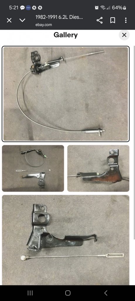

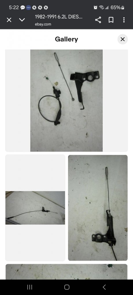

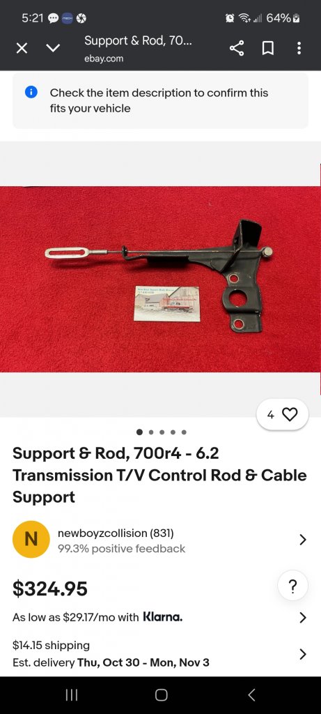

10,170
19,659

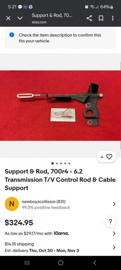

There several sets on ebay I tried to link. But the post keeps saying pardon our interruption.
I thought i didn't get one because they are hard to find. But Maybe instead I saw how much they were selling for and was like for $300 bucks ill make one lol. Only took like maybe 20 minutes to gather materials and build. I imagine The most crucial part would be the correct length.
10,170
19,659
Yep for 300 . I'd examine the Ebay ones real good for reference,but would make some based on the pics.
