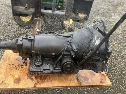

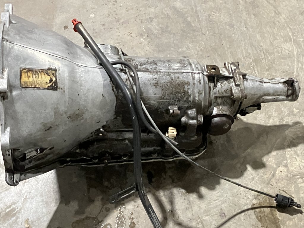

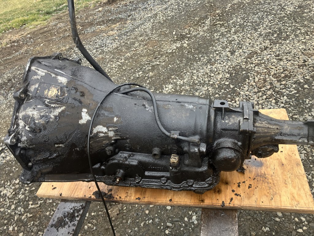

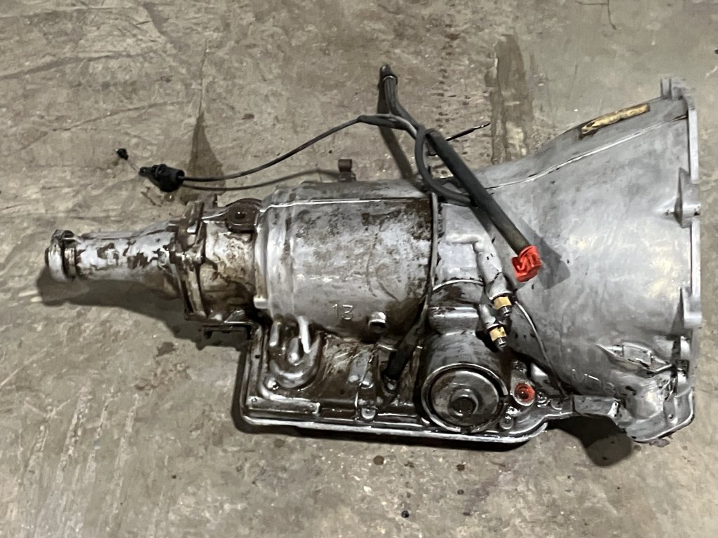

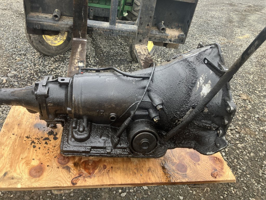

Damn you Ricko, right again…. That four wheel drive trans is just to much trouble, but I have a friend now in the auto recycling biz, has a two wheel r4. Wanted 725, got him down too 600, showed up with the truck, sold it to me for 500. Just a kid but has three squares, all he drives so hallelujah. Got it mostly cleaned up yesterday. I will order parts soon, complete rebuild, oh yeah, had the low stall torque converter as well. My plan is replace all the bushings, go through the pump, rollerize etc. watched Nick’s video again, got a book etc. busy in the shop. This will be my second auto rebuild, 1st was my 350, put it behind the 454, and proceeded to thrash it every time I drove the truck, and it worked super good. Overdrive in the diesel will make so much difference. Always open to suggestions.

Well Aasleson, I have an original bracket for the diesel, with the TH400. Ricko and others have said I will have to fab up something, and there are some pics in prior posts. The new transmission does have a cable on it, and was out of a square. I was going to fab up a bracket, but if you have the right stuff for a diesel with a r4 trans then yes, I am interested. You can pm me on cost and address. And thank you.

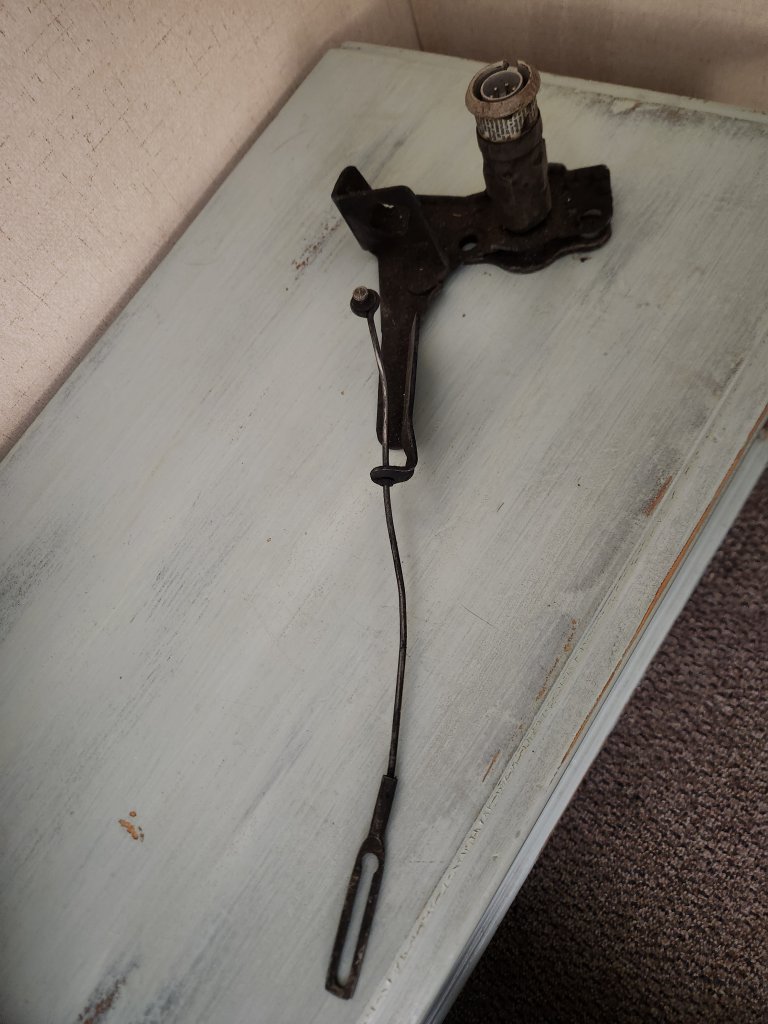

The bracket bolts to the back of the intake and has the spot for the cable to clip in and connects the TV cable to the injection pump

Here are the trans kits I am looking at:
I think will be what I buy, as I tow with this truck:
Also buying a ATSG 700r4 book. I did my 350, took awhile, but it was awesome behind the 454, when stock it broke.
Is there anything else I should buy? Yes this will be in the diesel truck
When I built the 350, I did put in a 4l60e center section, The HD Borg Warner 32 element sprag, Beast sunshell and one piece sun gear. I really don't think I need those as this is not a tyre fryer.

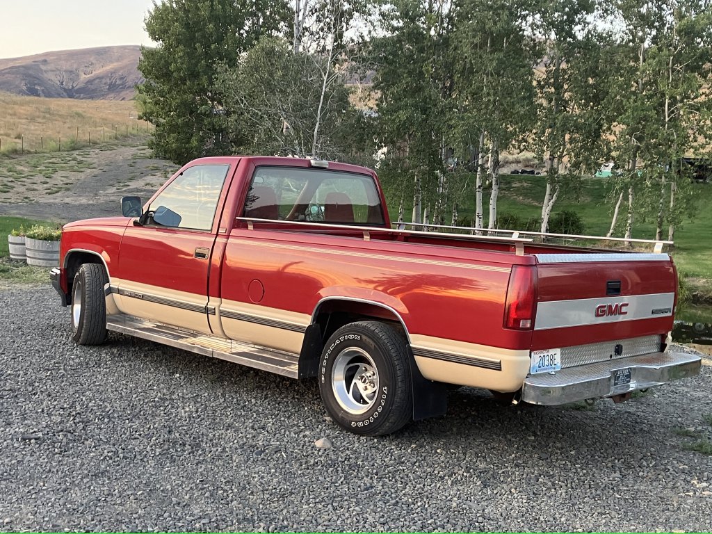

Left Sat at noon, made it to Shasta in Jans OBS truck, but stopped by storms down there, so stop and tried to sleep in the back with two dogs. Yeah, you can imagine...Up at four, made it to Plesantation by 10AM. Beautiful looking truck, but mechanically it was terrable. Bad brakes, bad transmission, engine had no power, leaking from transfer, trans, rear end and engine. He took off $3400, but we passed. Left at noon, made it N of Bend Ore last night. Few hours sleep and off at 2:00 this morning, and made it home at 7:00. Home sweet home. Jans 91 was a champ, so much so, we are keeping it. Runs strong, great trans, and looks prettry good. It is two wheel drive and we get snow where we live, but we're gonna put some good tires and some weight in the back. Only mishap was the camper shell sliding window shattered, bugger, so on the hunt to replace it. I am VERY impressed with these tricks

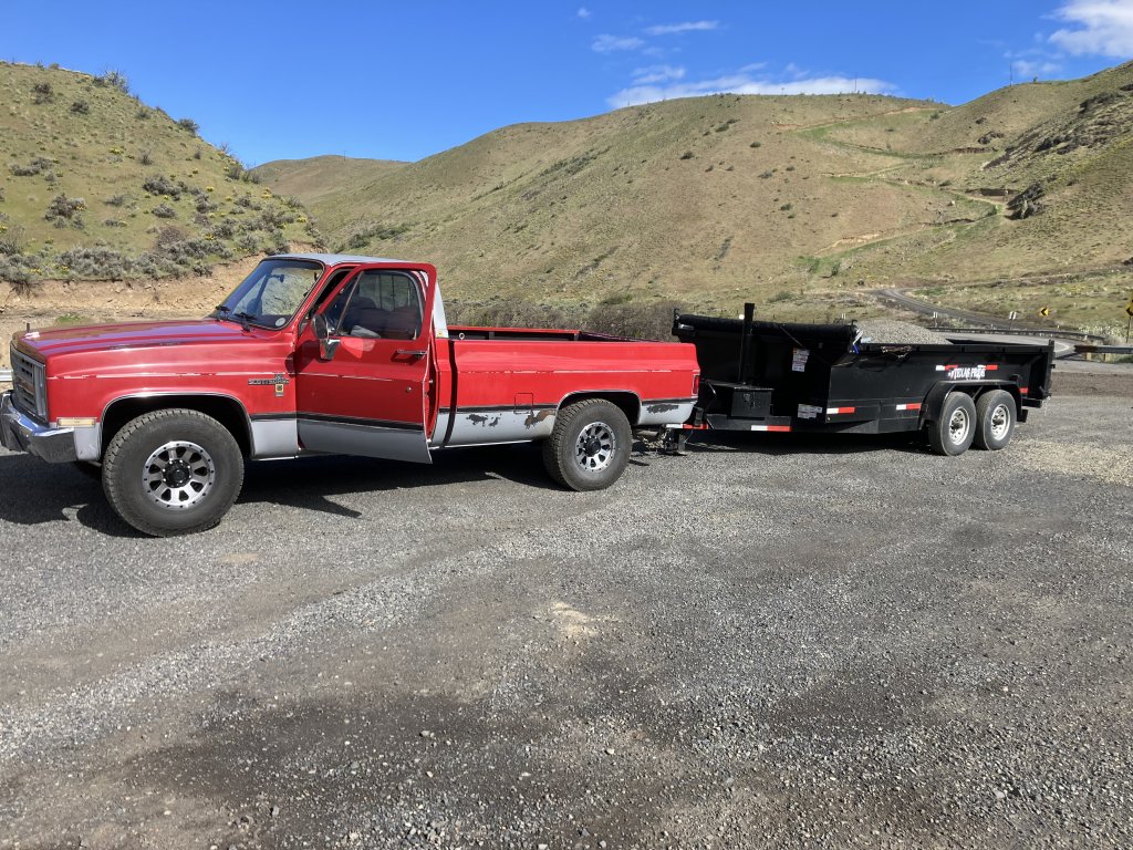

Drive the truck today. and brakes are excellent, so thanks everyone that helped, and especially Ricko, as post 190 got me going. I did gravity bleed the rears until I got nice clean fluid, and vacuumned the fronts, and fantastic! Also found a Century topper for the truck today, only 10 miles from the house, so grateful. I will paint it the same color as the truck, and needs some cleaning, so the three year search for a good fitting topper is over. Dogs in the back, boat hitched and down to the Klic to catch some springers, sounds like a plan.
