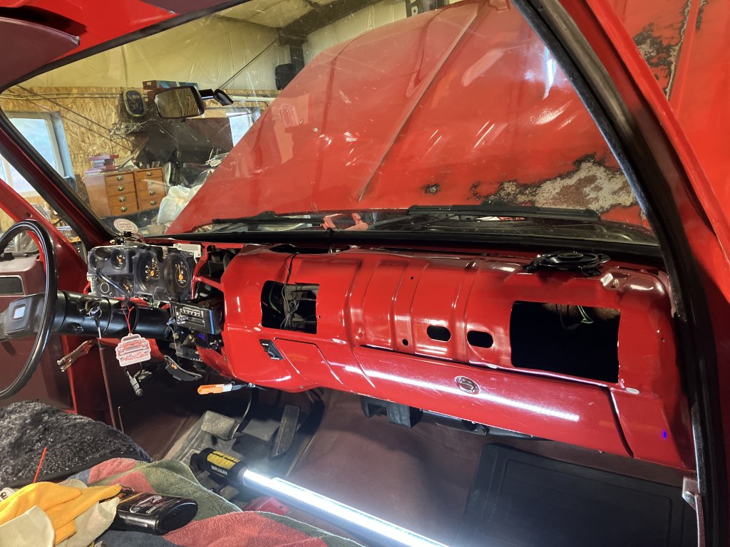

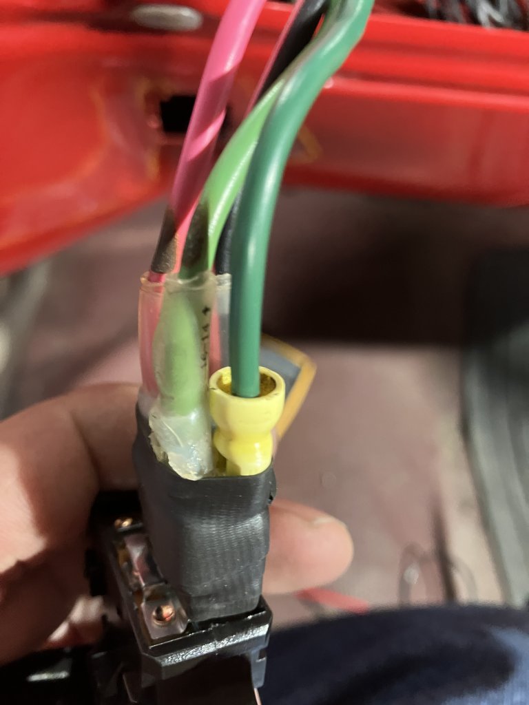

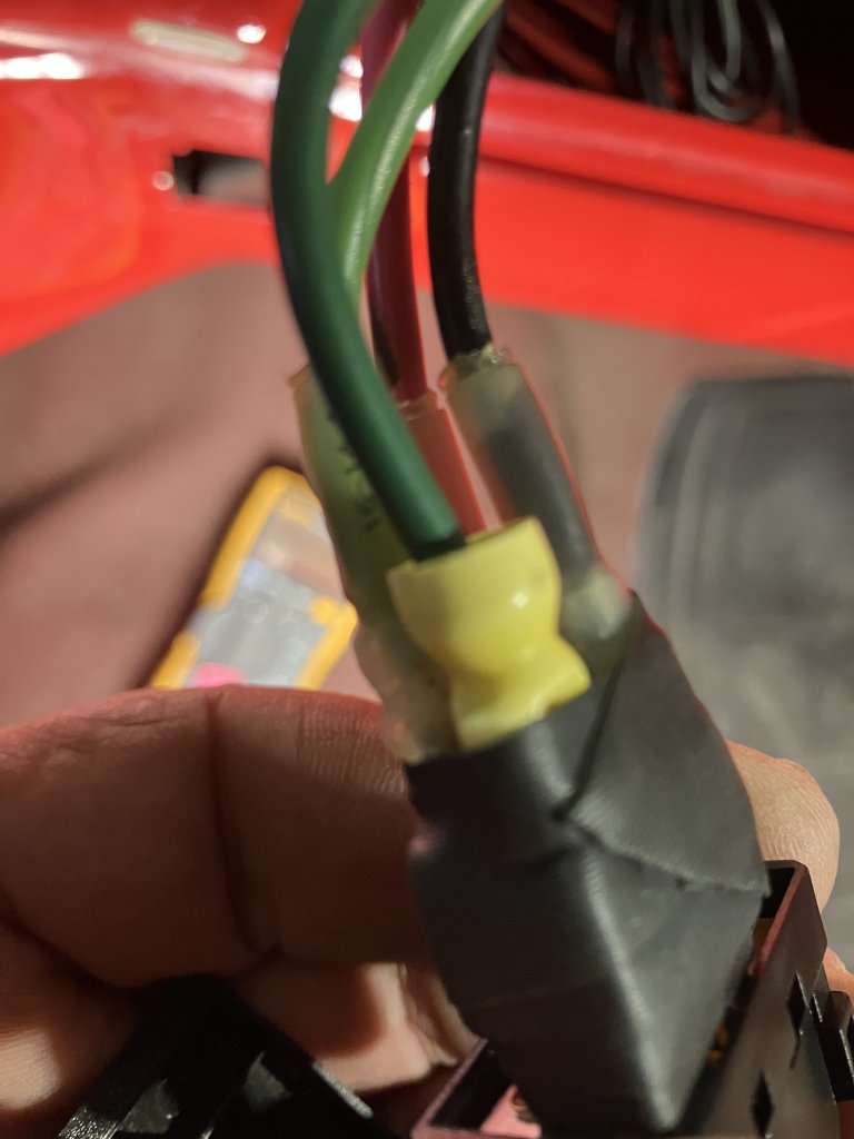

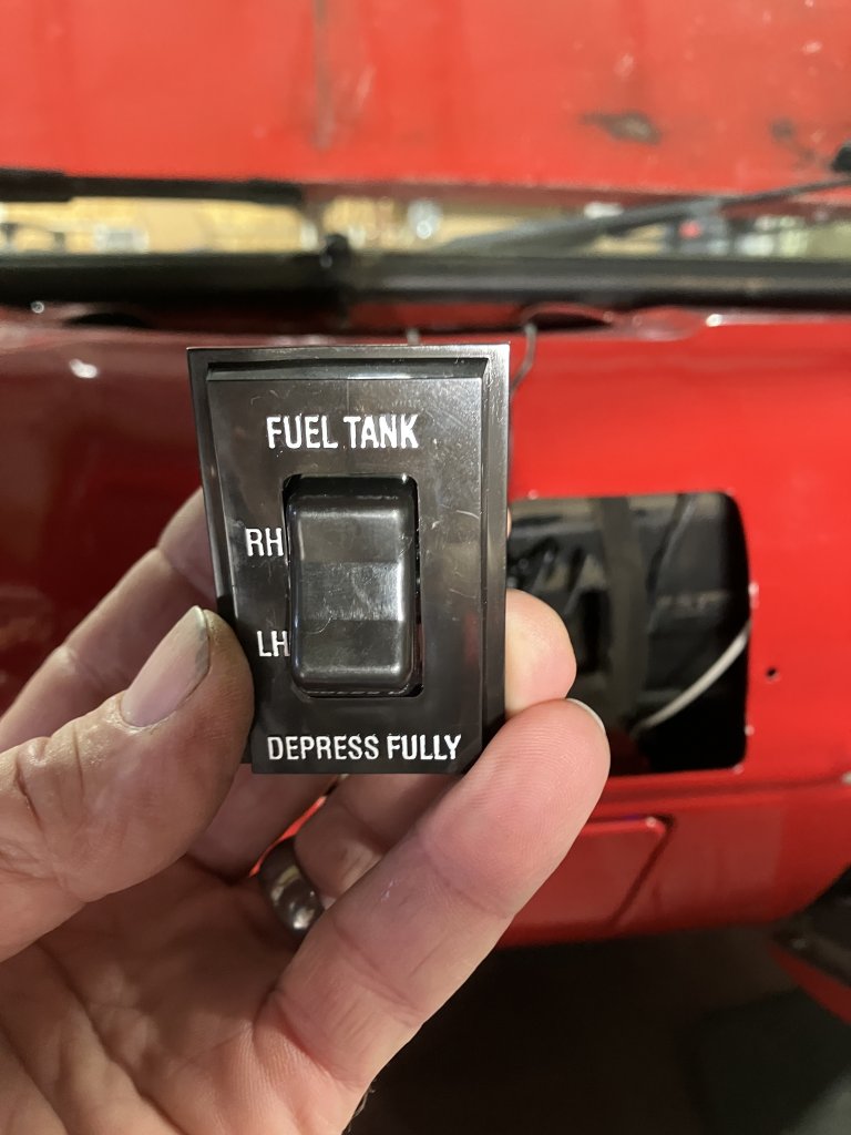

Dang, today fuel still leaking...but I did get the heater all done, but the heater controls don't seem to work, but the heater puts out plenty of air. Pics are for reference, this is how the switch should be wired, and yes, it is specific.

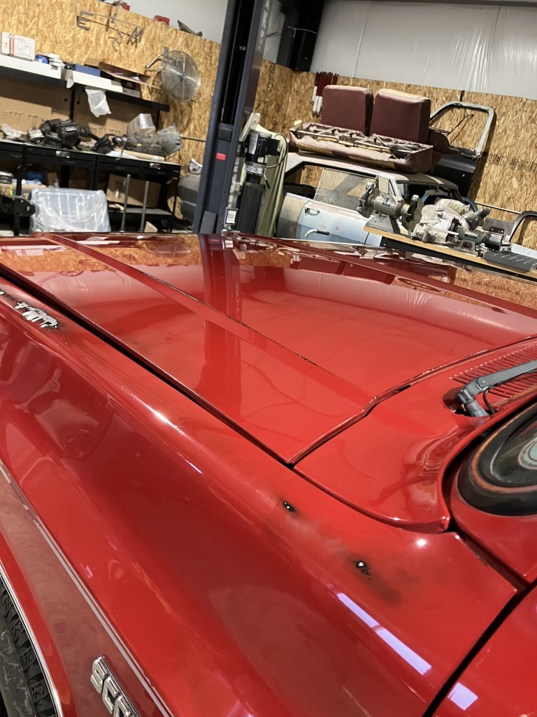

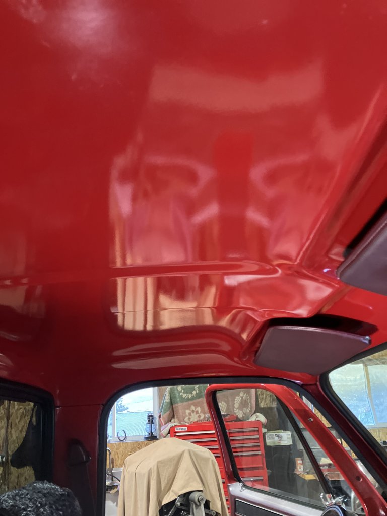

I don’t know the last time the interior was waxed, yes I do stuff like that, ain’t she purdy!

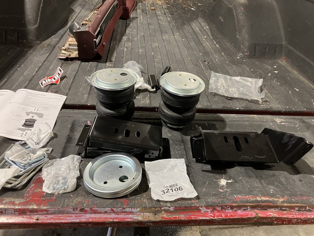

More parts to install hopefully get some of this done today, but I still need to fix the fuel leak. have ordered the late model quick connect fittings and nylon hose good for 200 psi. It’s gonna be a few days before it gets here.

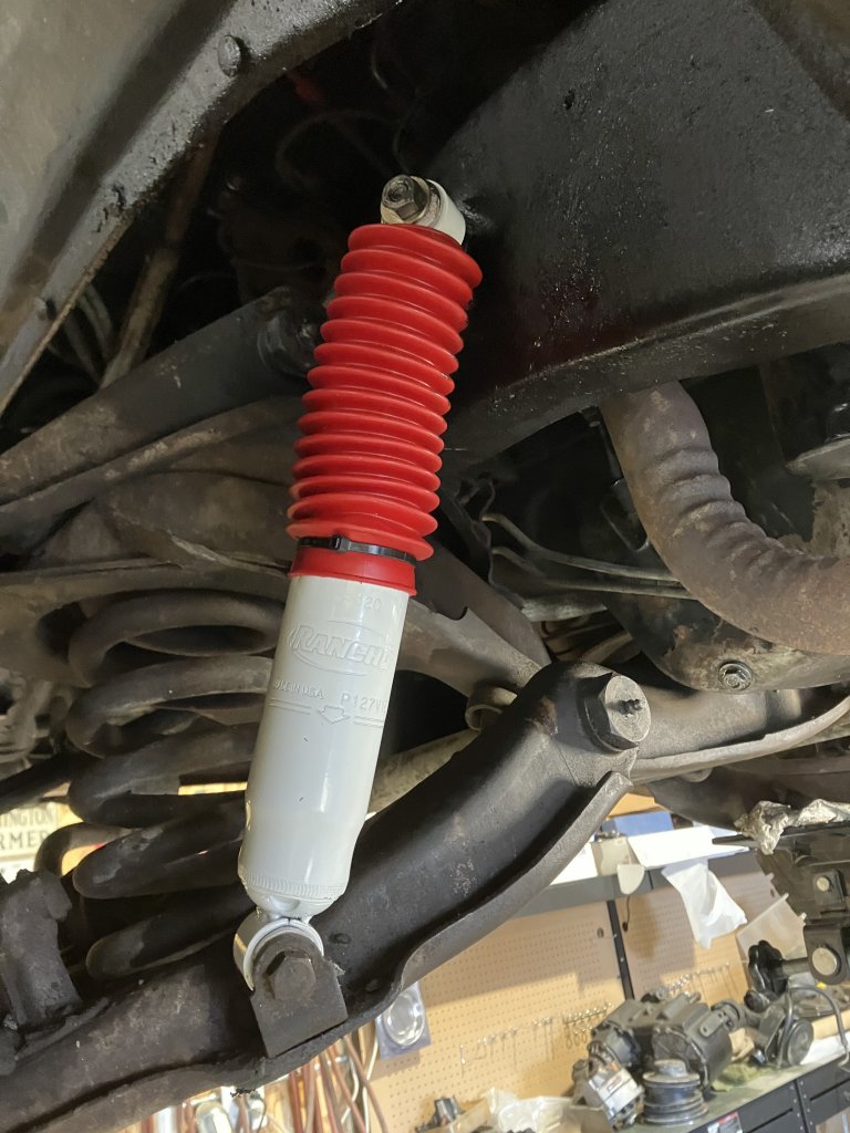

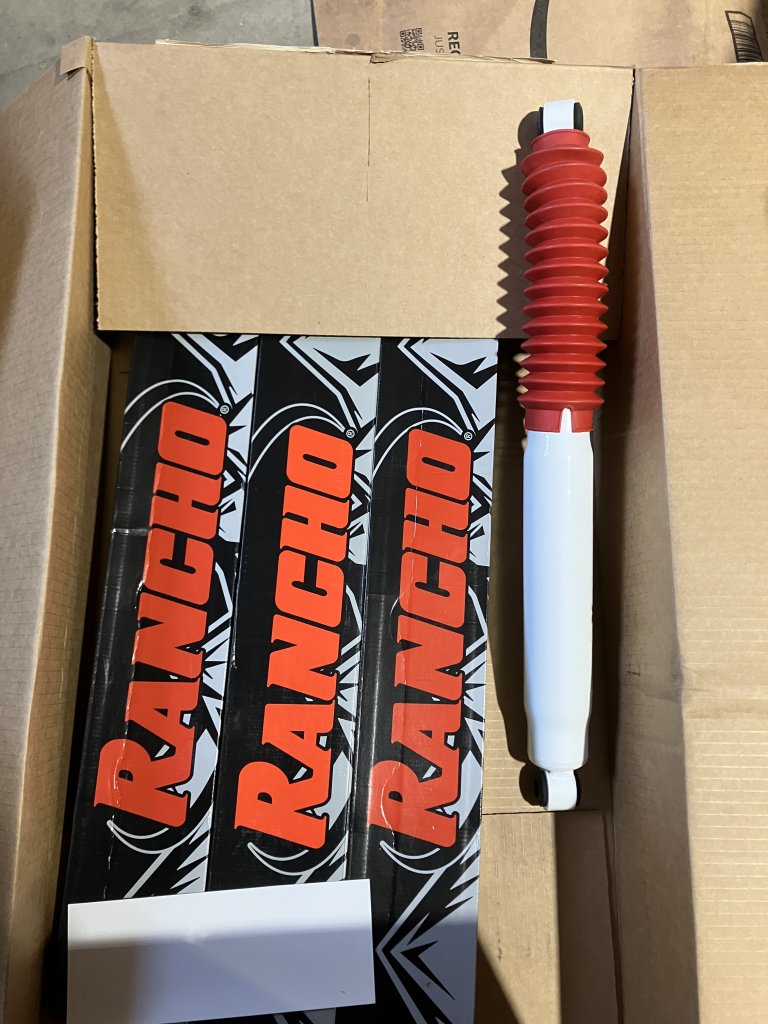

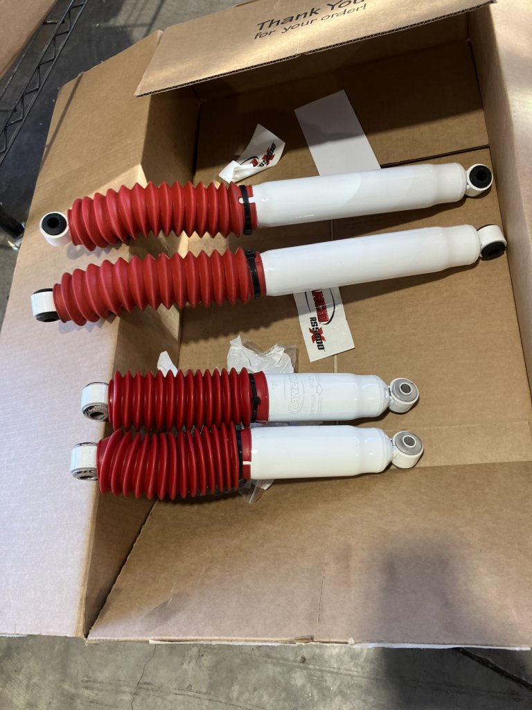

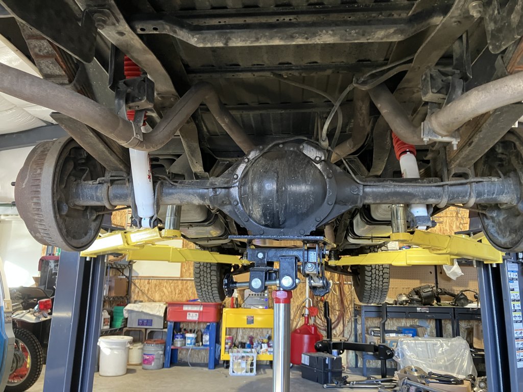

Got that job done it wasn’t too bad. Haven’t had a chance to run it much, but it seems a little stiffer which I like.

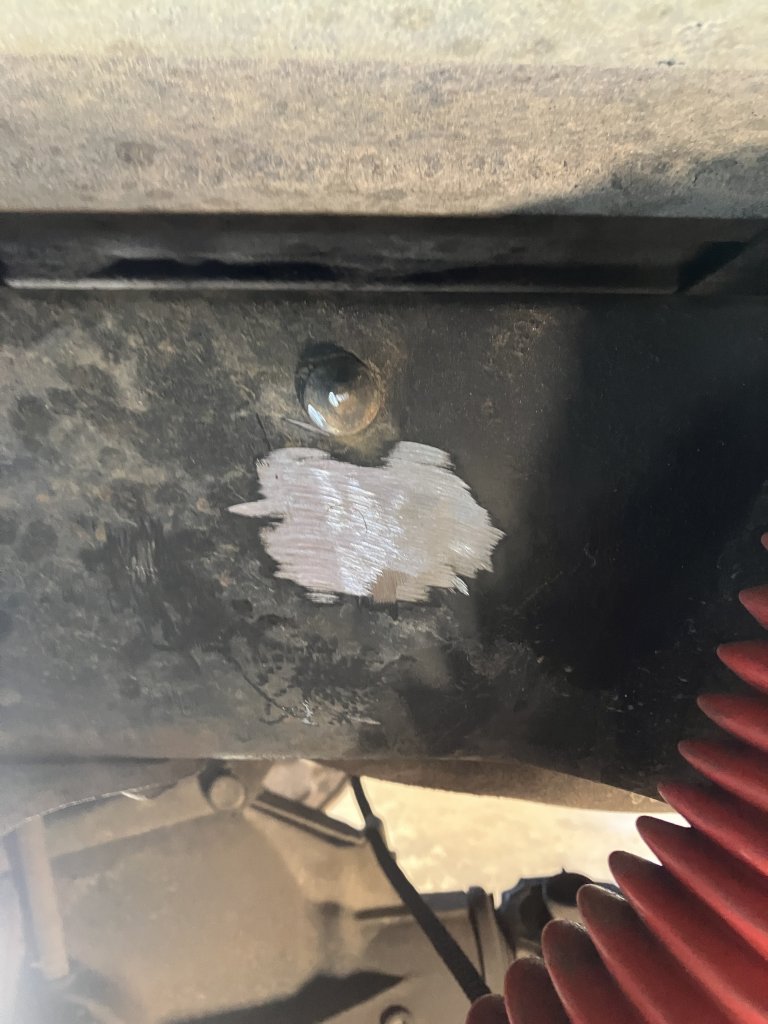

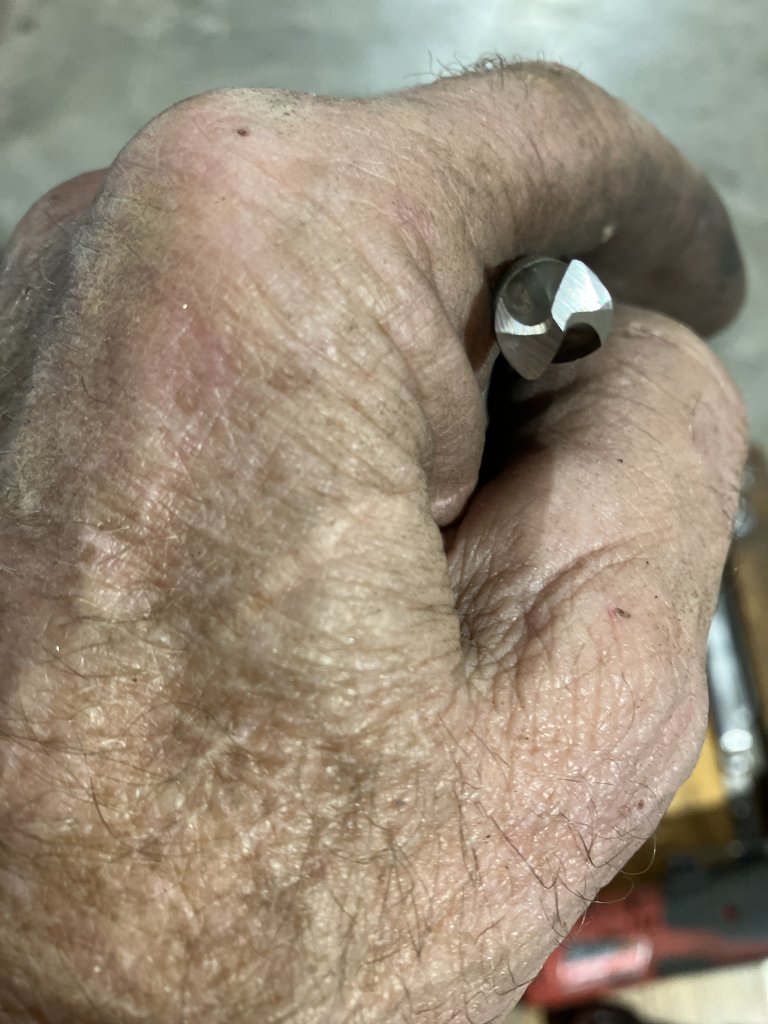

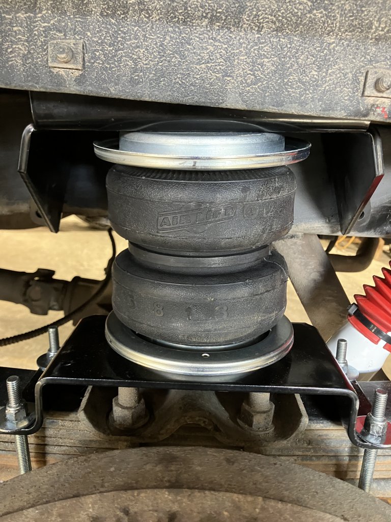

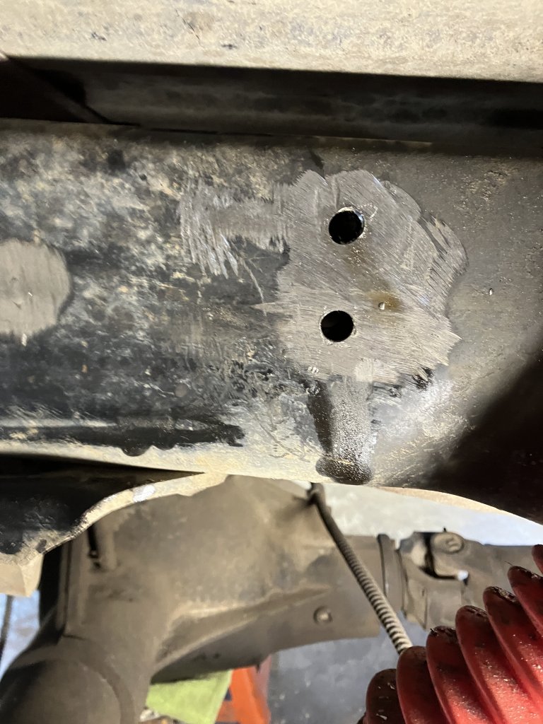

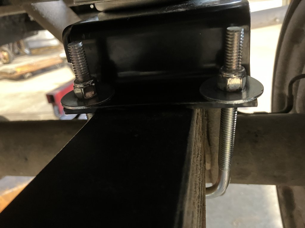

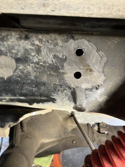

However, on the other hand, installing the airbags were kind of a pita, the passenger side has a bracket for the load sensing Brake proportion valve. It was right in the way, so you have to take those rivets out of there by grinding and then punching out. I then used those holes to bolt in the right side of the bracket. Left side, used the bracket as a templet. the brake likes were not in the way. This is the drill sharpening method I use it’s called thinning the web, makes it much easier to drill through steel not as much pressure required anyway there she is all in.

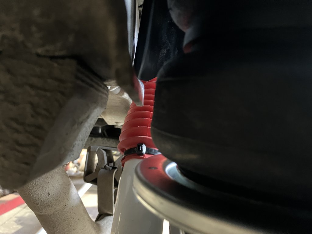

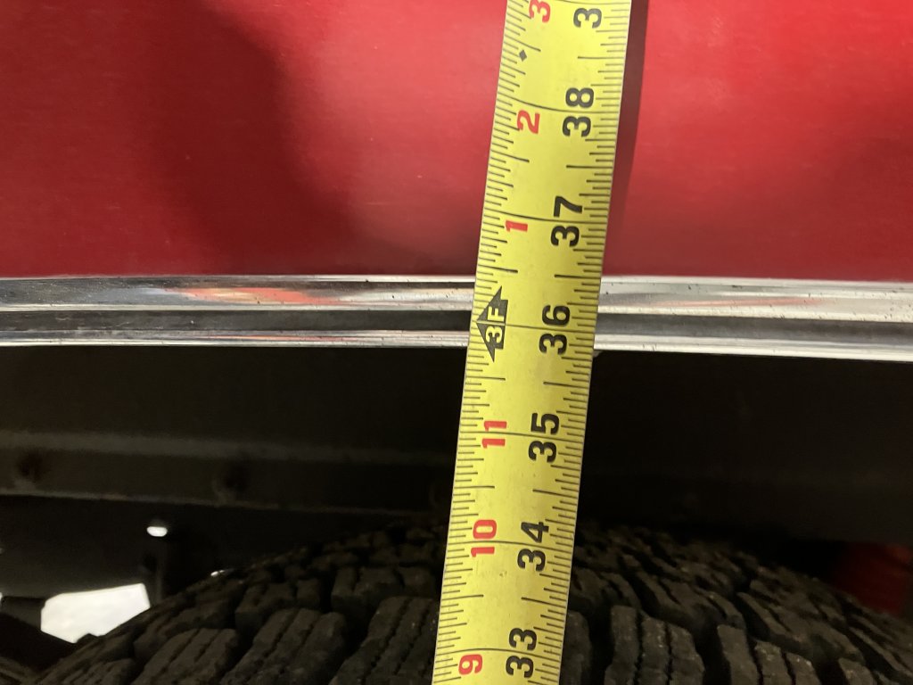

A few more. In the first picture, on this side there is a flange that is built in. I had to cut out on both sides a 1/2 deep by 2inch long channel that allowed the bracket to fit up into the bed rails so I could drill the holes where I wanted on the frame. I haven't finished with the air hoses, as I want a T in there so when I air up the bags, they will have the same pressure, the kit is individual, which I dislike. Anyway hope to get something tomorrow, and finish this up. Last picture is clearance from the bump stop to bag.
