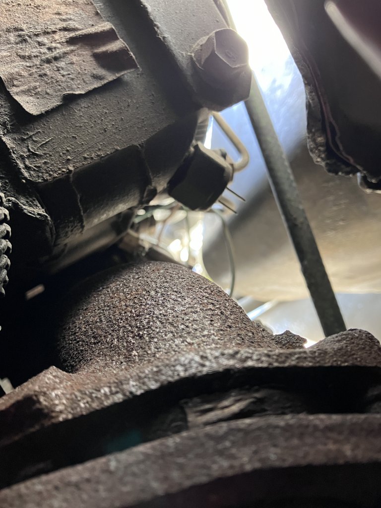

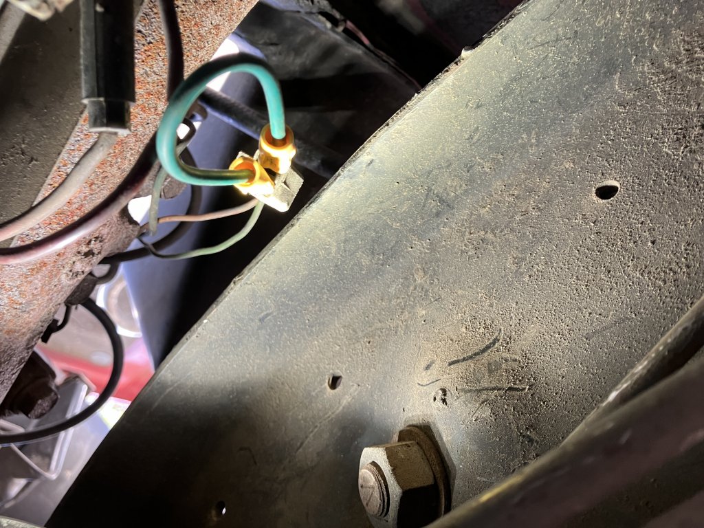

I found the problem: A glow plug inhibit switch mounted in the passenger side cylinder head at the rear of the engine disables the glow plug controller if the engine coolant temperature is greater than 125 °F. This switch/sensor is a common failure point and is often disabled by owners as the OEM part numbers are becoming obsolete. Although its function is to prolong glow plug life by disabling the system when the engine is warm, it can be safely bypassed by simply splicing both connector wires together; it is a normally closed switch: from Diesel Hub.
So I think I will try splicing the wires together and see if that works because it seems to be the fix, cheap, and as long as the controller works, (it is,) the glow plugs will cycle and the truck will start.
Craig Nedrow
NADAR UNDER THE RADAR
Sep 1, 2018
1,674
4,203
Washington State
Craig
1973 (have two), 1985
K10, K20, C20
350, 454, 6.2 Detroit
I believe this is the culprit glow plug inhibit switch, pass side behind the glow plug. I did not pull to check, just made a jumper wire to connect both sides together. See pic 2. Drove the truck today, and no problems. Also both fuel gages are working, what a blessing!! I need to fix the window washer, as it does not work, and I have not spent any time diagnosing it. Also the left side blinker does not cancel, but don't want to pull the steering wheel off right now, maybe this winter. Working at finishing the K20 frame, will buy epoxy paint on Wednesday, Hope to paint maybe later this week, the weather is ideal to paint outside, my only option. I will paint chassis black after the primer, should be a thing of beauty. It will be nice to have the frame done and out of the shop, as I want to start on the cab. Most of the body work is complete, so stripping, a small amt. of body work then primer and color sand etc.
