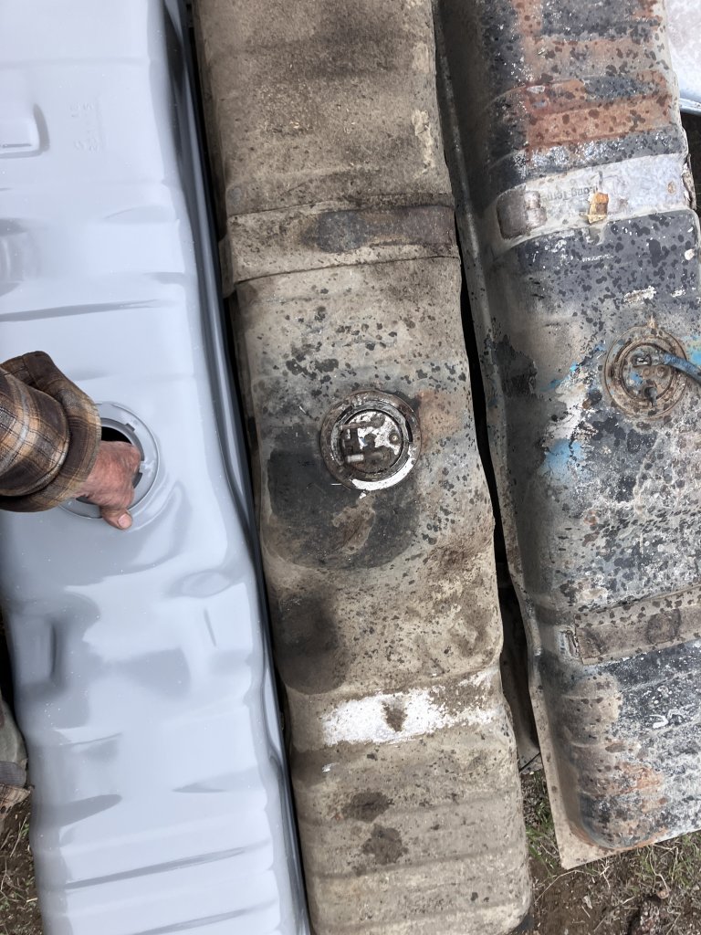

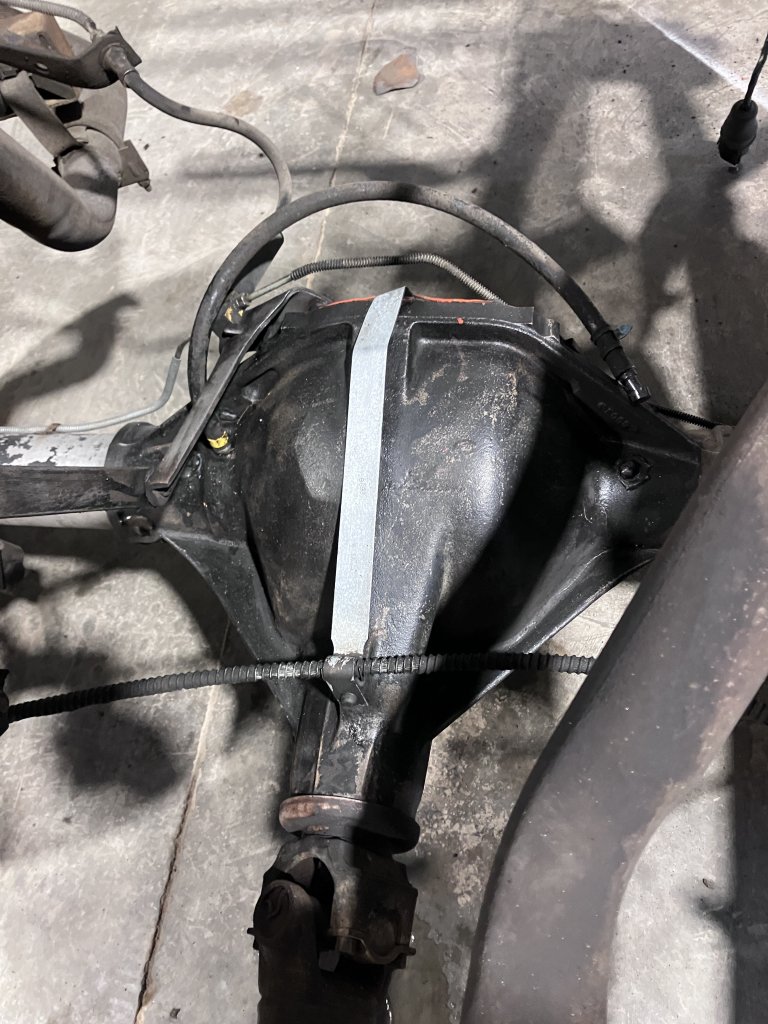

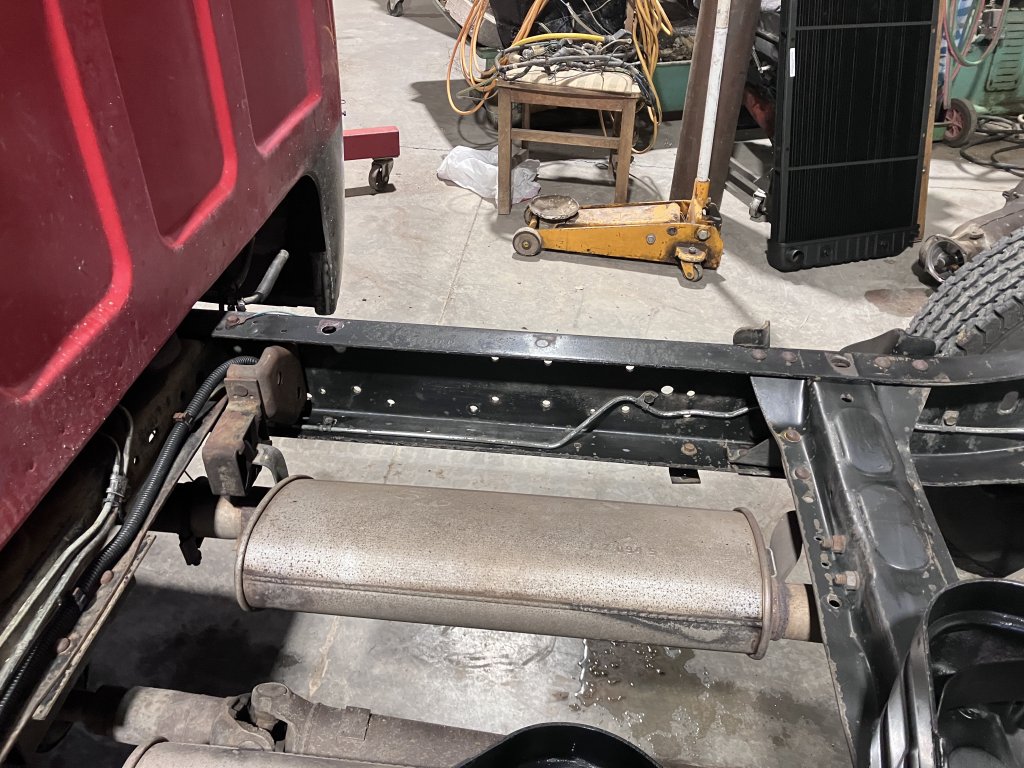

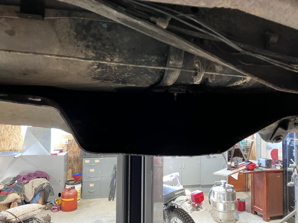

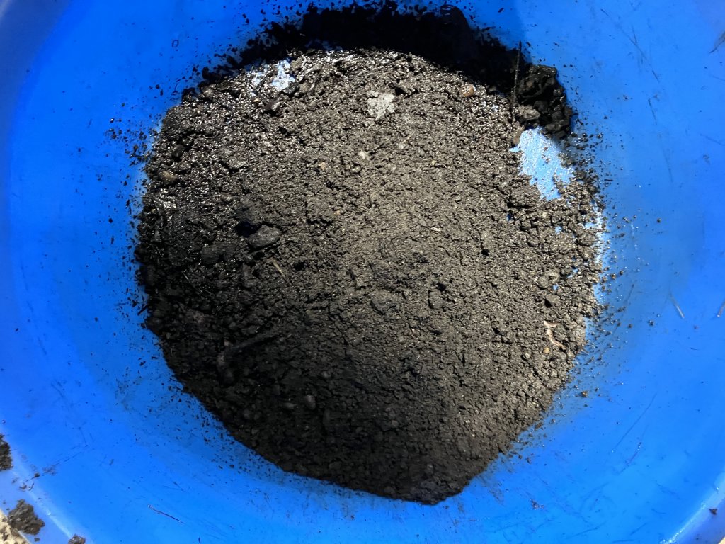

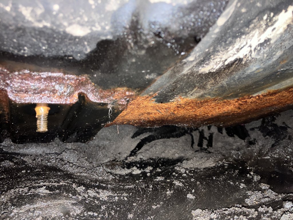

I have not been setting on my hands, have been working on the square. Pulled the rad, but shop I trust said it was or soon will be shot, it was leaking slowely from a few spots. Ordered a brass/copper original coming from Texas, be here next week. In the mean time, both tanks are slowely leaking, so up on the lift and investigating. There is dirt PACKED!!!! on both tanks, gallon on each side that was trapped by the cover. I have decided on two new tanks, rings, switch, six port valve, wire harness, but can't see if this diesel tank has two or three ports on the floats. I want to order all this stuff asap, hoping for some help.

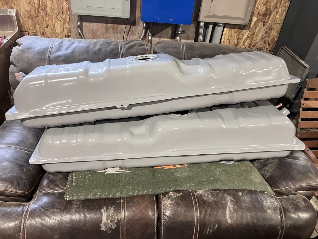

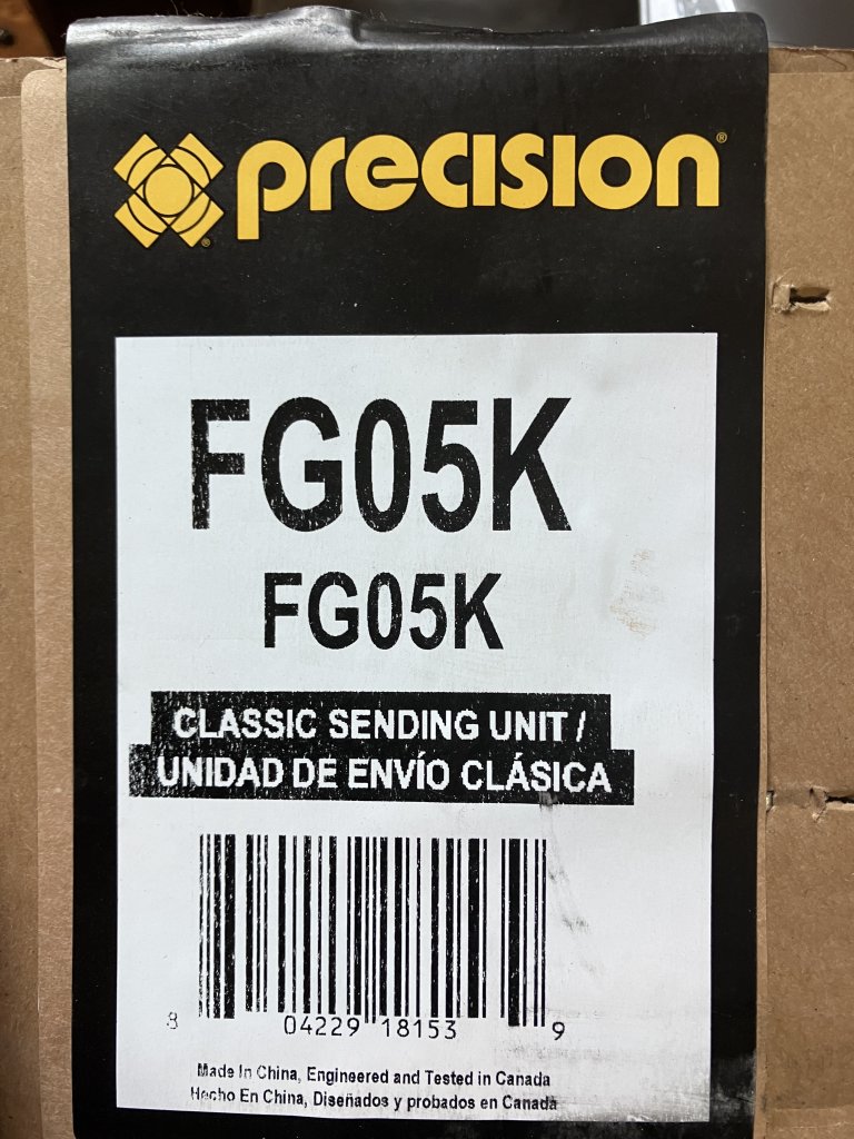

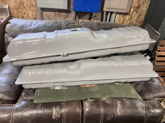

I am farther along since the last post. Old tanks out, new tanks here this afternoon. Here are the correct numbers for my diesel truck. Tanks are the same. FG are the left and right float. Mine is a two tube, these are three, so will plug the vent, as it is already vented by the fill area. The floats are from O'Reilly's, SirRobino had a post and that is where the shop gets there's. Easy to return, but they seem good. 94 ohms full, 1.2 ohms empty, close enough foe me.

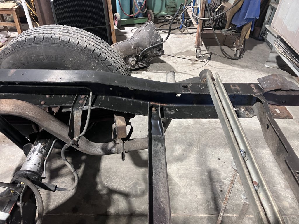

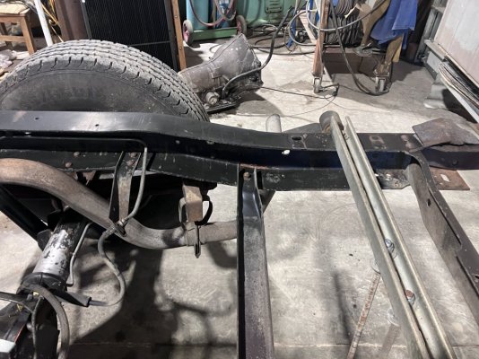

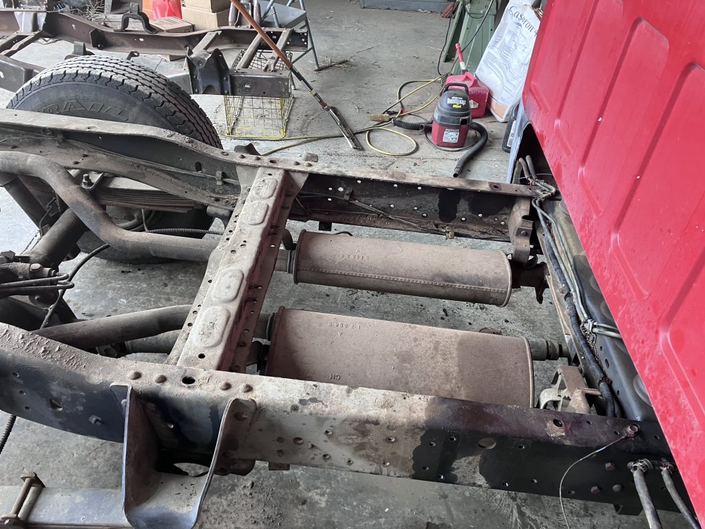

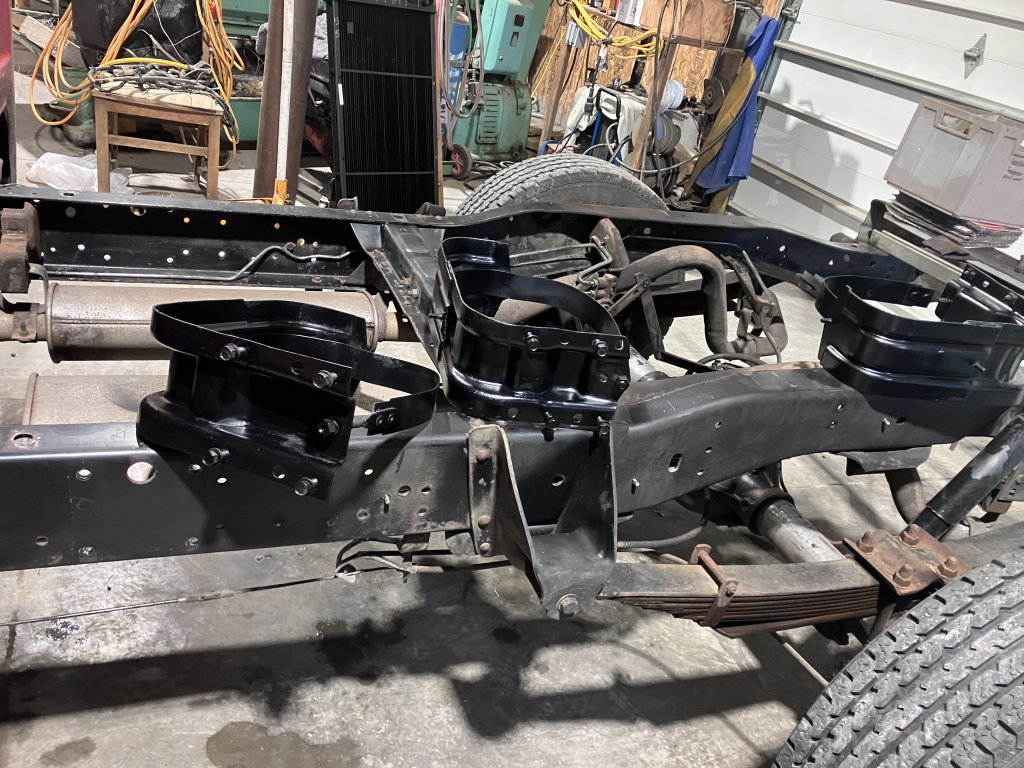

Dell has been up twice this week and today was mostly cleaning day. Washing the frame, then we scrubbed it with purple power, wash scrub, you get the drift. Frame is a thing of beauty, almost ready to paint, tank supports washed scrubbed, wire brushed, scrubbed, one more pressure wash. Dried cleaned with alcohol, and painted. Battery tray's are not perfect, but did the same cleaning routine, and painted the bottom with flex steel. it dries slow, but that's ok as they are one of the last things to install.

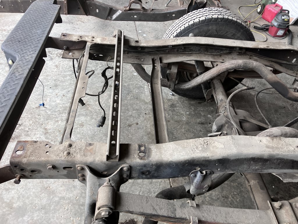

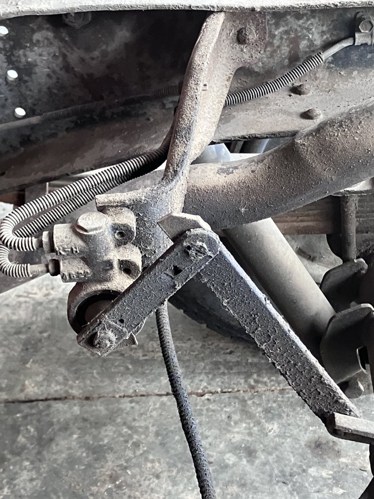

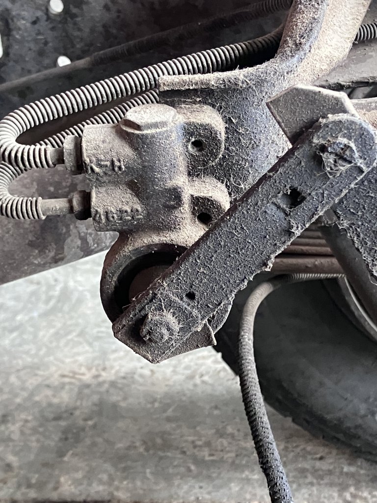

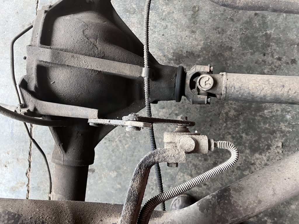

What does this thing do?

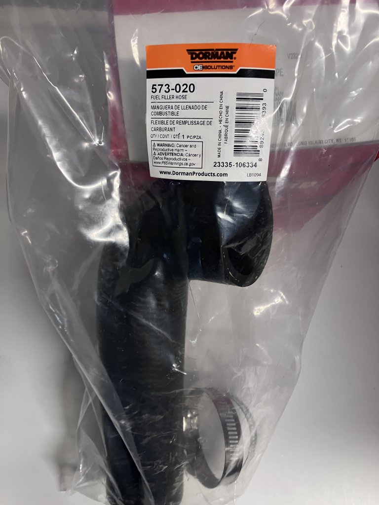

Here is the filler hose numbers, both the same, and the switching valve. Was hoping for great instructions, very minimal and very blurred and hard to read. I do believe I saw a post with a wiring diagram will look for that. The vent hoses are not here yet, coming from Rock auto.

I am hoping to get the gas tanks in this weekend, and install the switch in the dash, that looks like fun, then get the wiring straightened out, as nothing worked before, and this is the first time delving into this debunkel. My new floats have both terminals with the little studs that has the rubber hat connector that slides over the stud, I need two of those, or I will use a side spade. I only have a month till my trip to Kentucky and have a long list of maintenance items to do.
