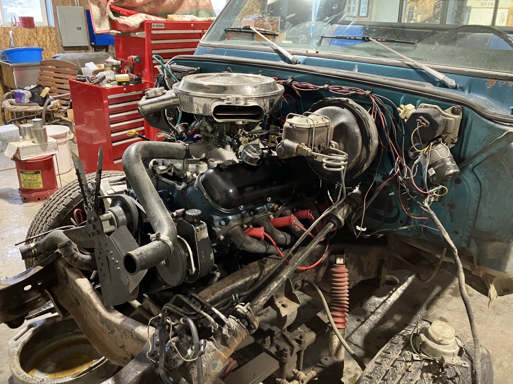

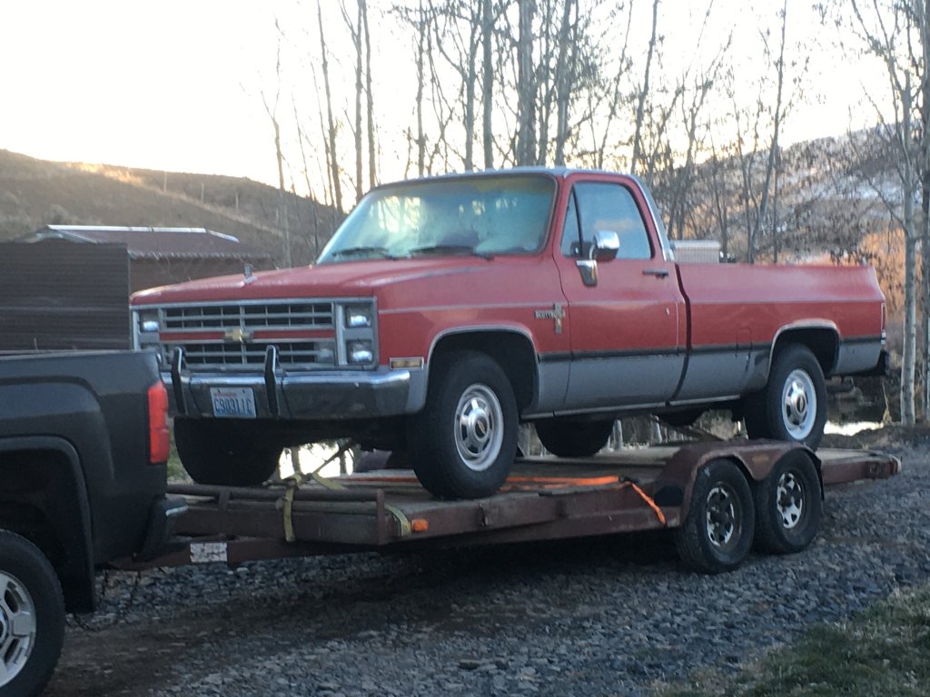

Haven't posted about this pile in awhile. I have worked on the 6.2, rebuilt the pump, new block heater new glow plug controller, glow plugs checked good. Batteries are ok, but no start. My 73 K20 is down to the frame, and my 73 K10 front end is wobbly, and getting a bad case of the square body blues. I think I will pull the 6.2 out, have it sold, and install the 454. transmission is a 400, will reseal and filter, hope that's all. Looks like a direct drop in, motor mounts on Summit are the same, and I think (because it's a GM, not a Ford,) all the dimensions between the 6.2, and the 454 as far as trans to motor mounts will be the same. Been looking at posts on here, and it's been done. Chime in if I am missing something.

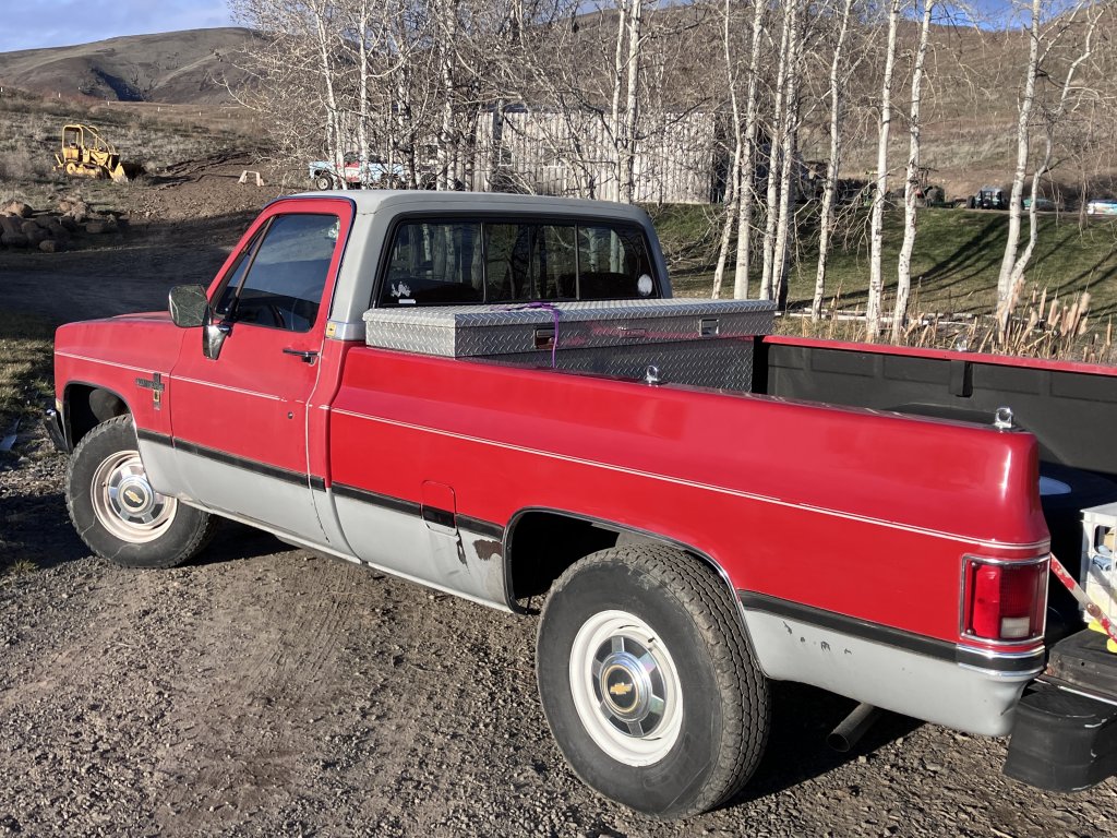

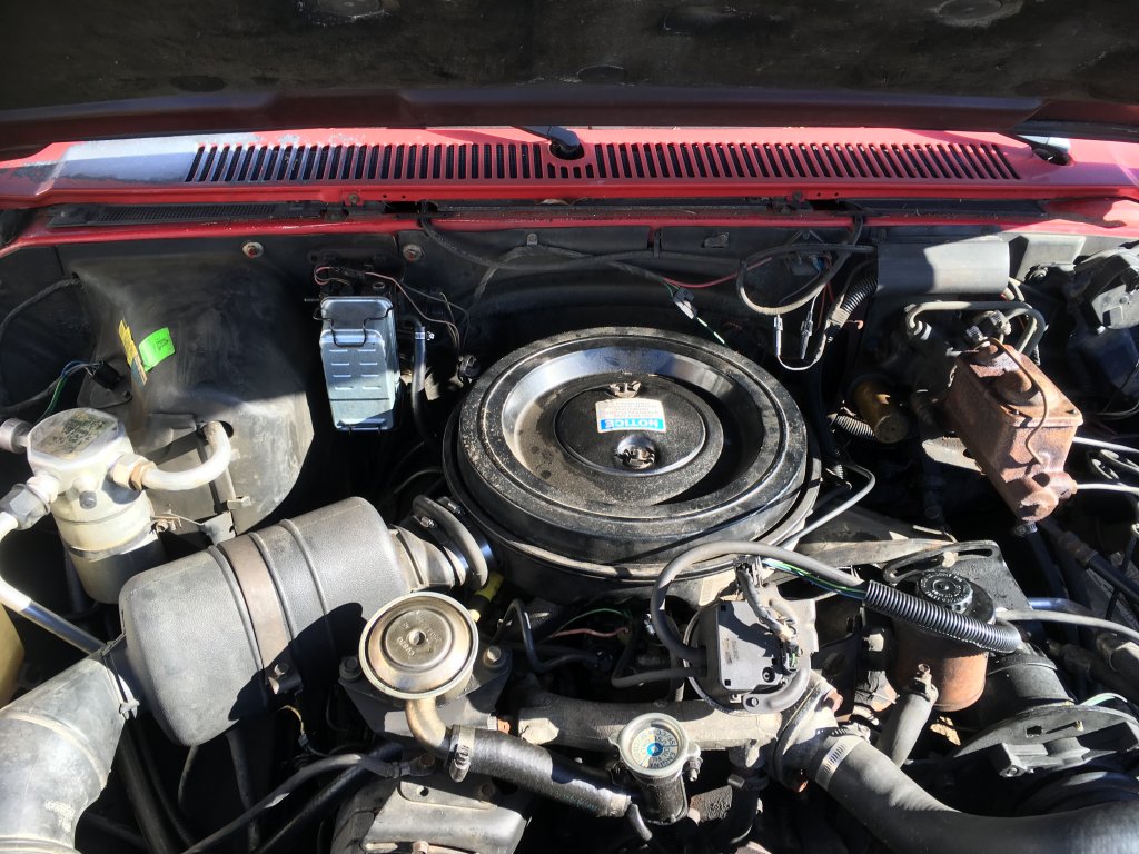

I take it all back, she's not the Hoe, POS I thought she was. Had it hit the other day, got up close to 50 degrees, had the batteries charged, and heater plugged in and it hit. Last Saturday, She started, and I actually drove it, 1/4 mile and quit. Wife pulled me home, but was encouraged. The gas gage does not work, and Not sure if the tank switches, so Put on the lift, and was able to pull the drivers side fuel line off. Only got about one qt of three year old diesel, so out of gas. Bypassed the selector valve, with a new piece of 3/8 gas line, good and tight, put in 6 gallons of farm diesel, 8 oz sea foam, and lots of cranking but no start. However later that day, after trying on and off all day, it started, and ran. I carefully took a easy run, and seems good. 40+ lbs of oil pressure, steers excellent, nice brakes. Started to put the shine on her, and hope to finish today, just the first pass, but a dramatic change. Red oxidizes so bad, but is cleaning up good. Jan gave ma a new air freshener, (her rigs all smell good, and she is very fussy about clean interior, and exterior) so should smell good inside. I will blow the inside out with compressed air, and clean up the inside after the wax job. Blue OX, I like it, I take it all back. I went on a three mile drive, had it up to 85, still pulling. Sound good around 55-60. Sets are very comfy. Will see if it starts this morning. Gotta say that I am so grateful to have a square to drive again, withdraws are the pits.
