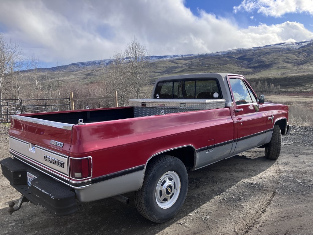

More work done today, and more to do. Finished cleaning the paint, look pretty, I like it. Gas gage, horn does not work, but will look into that tomorrow. Need to continue cleaning, first the interior, then the engine, and lastly the underside/frame. She is running great, filled her up with diesel, must have a 20 gallon tank. Ok Diesel people on here. On the engine, the manifold has tubes that are on both sides, and then go to the breather/oil fill. I need a schematic of those hoses, as what I have does not fit. I will look in the archives as well, but so far no dice. Sooo anyway, this feels good to get another square salvaged and on the road. Wife loves the truck, and the dogs went for a ride today, and gave me a thumbs up. The radio works, it's original, speakers are not what you would call fidelity. Hope to order all the stuff for the tank switching, and get the gas gage working, (it is open pegged full.) Now that this truck is running, doesn't look like I will be swapping in the LQ4, this was going to be my Bonneville truck. Got my eye on a couple others, could always make the 54 3400 my fast truck, it has D60, and a Modern front suspension with rack and pinion steering. Set up for a chevy motor, so easy swap. Was going to put the 235 back in, split the exhaust with dual pipes and Smitties, those sound so cool.......
