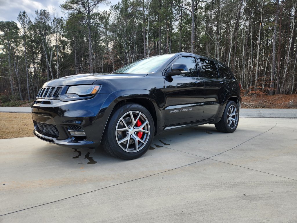

Before that while hers has been down she's been in mine all week. It was nasty from all the winter storms but then she also took it out on her friends farm the other evening because "it was cold" an she didn't want to walk.
Needless to say I wasn't very happy. This is a vroom-vroom/Iamspeed jeep, not an offroad one. It took me almost 3 hrs to get all the mud off underneath an in the wheelweels. I didn't get a before picture I was so ticked, I cant stand getting a vehicle muddy...
Here's an after though :cool:
