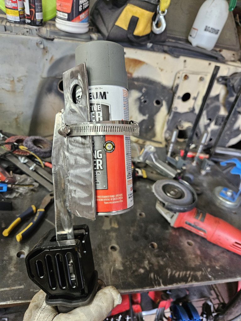

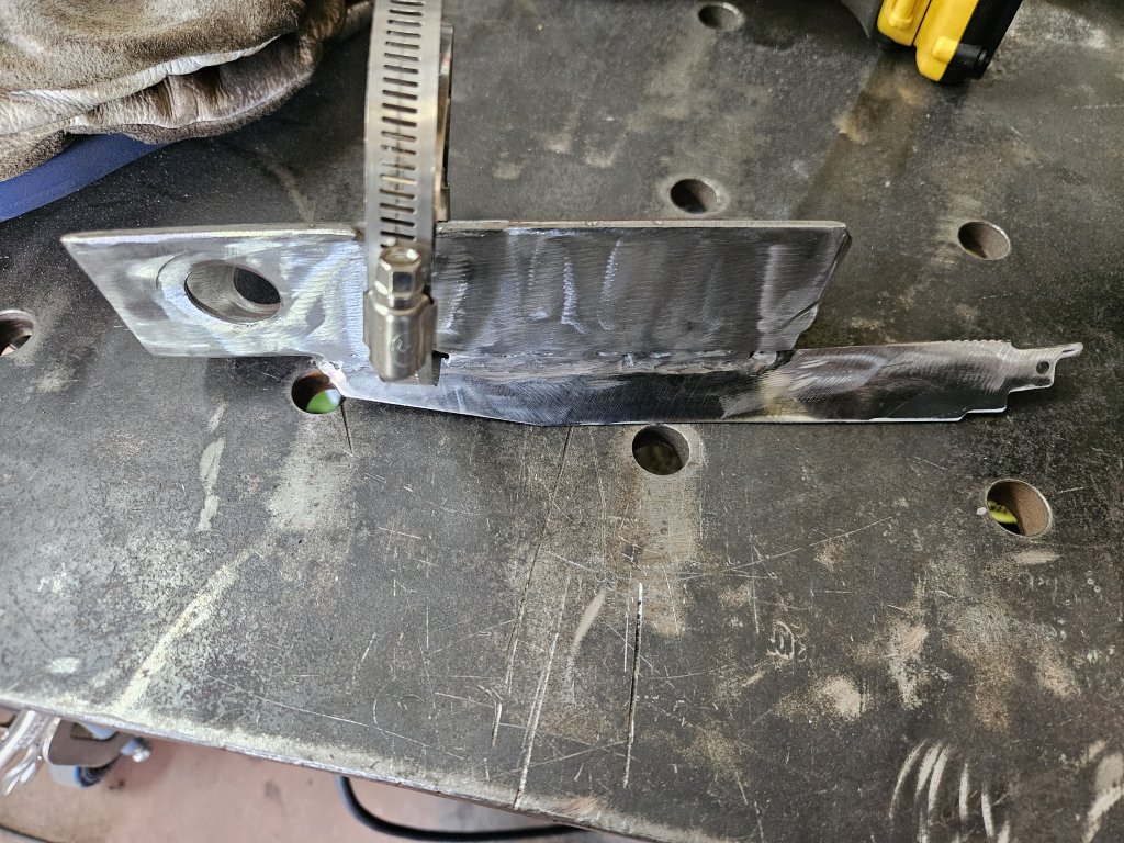

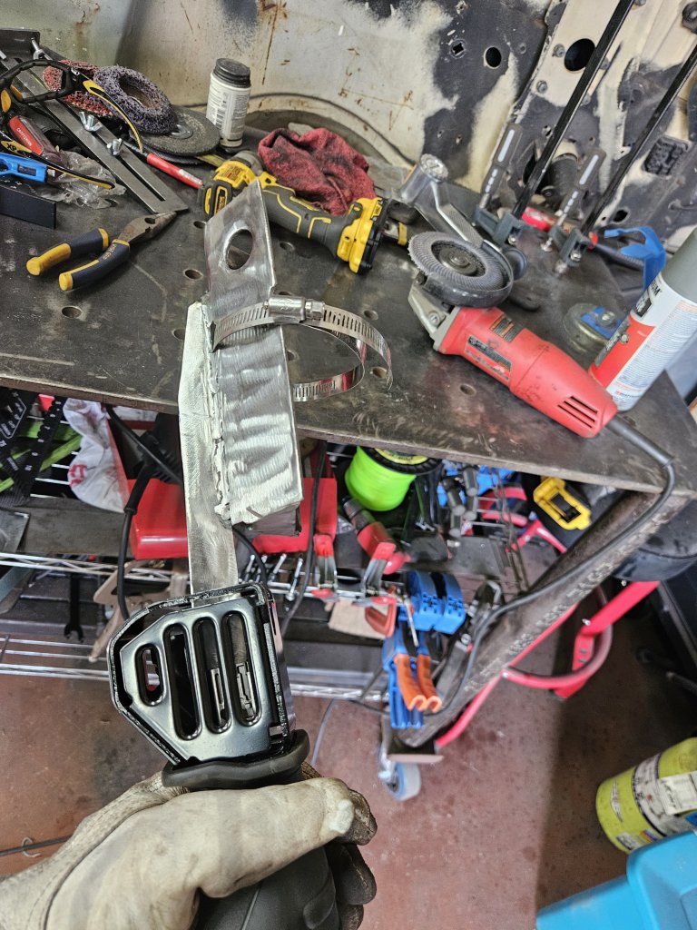

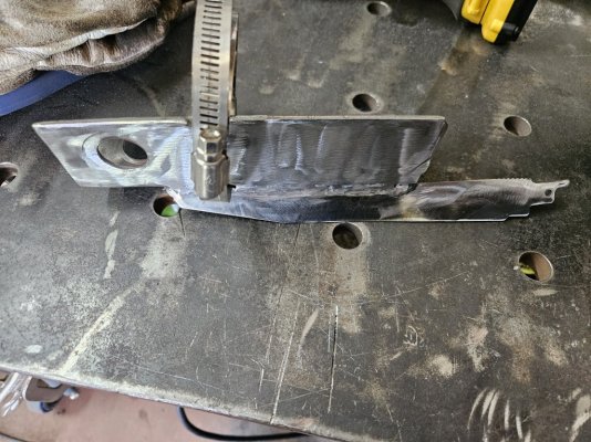

I saw something like this on a YouTube video. Looked at the link to buy one. 45 plus 15 shipping seemed a bit steep to me. My wife said you can make that. So I got to use my new finger brake, hydraulic hole punch, and a Dimple die. Reciprocating saw paint shaker... Will probably sand blast it, and powder coat it.

I made and you should too. A Sawzall blade that you screw a regular old wire brush too.
About 3 screws? Did you do a write up on it. I just combined to two threads.
10,175
19,683
Yep I put up a pic and said what I had done the day I did it. I can't find it though. I think I just drilled 2 holes in a junk Sawzall blade and screwed it to a wire brush.
