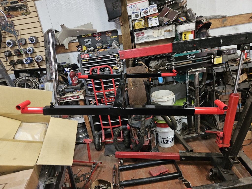

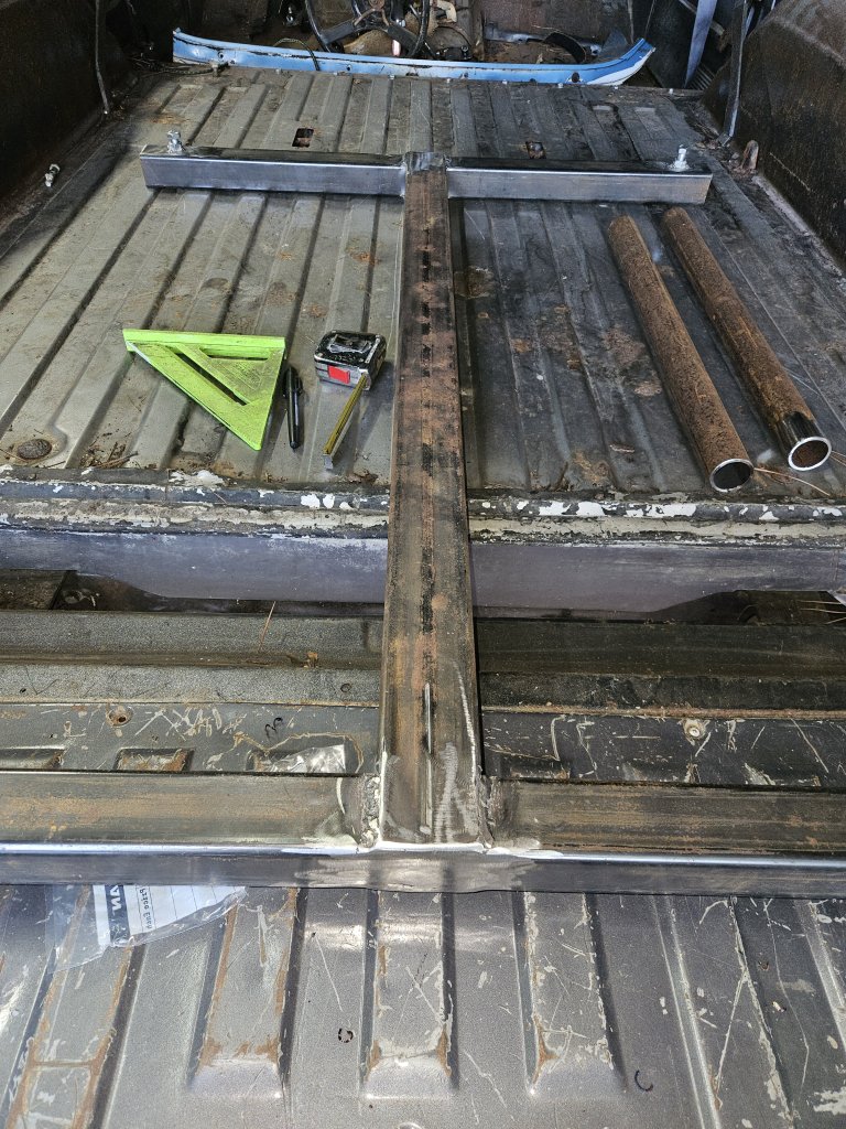

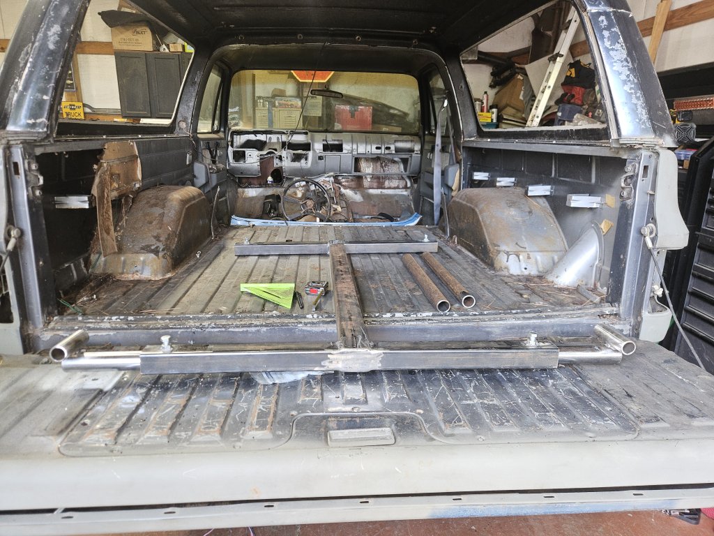

I've been looking at adjustable truck bed removal tool, that you use your engine hoist with. The cheap Chinese ones are like 100 bucks, and says they can support 500lbs...yeah right. The good ones are about 225. I had some scrap metal laying around, went and bought 41.00 of round tube. Not quite done, but this is what I came up with. Please don't give me too much crap about the welds, it's flux core wire, and I hate that stuff, but I can't justify buying another bottle of mix gas for a welder I'm only going to use once in a while.

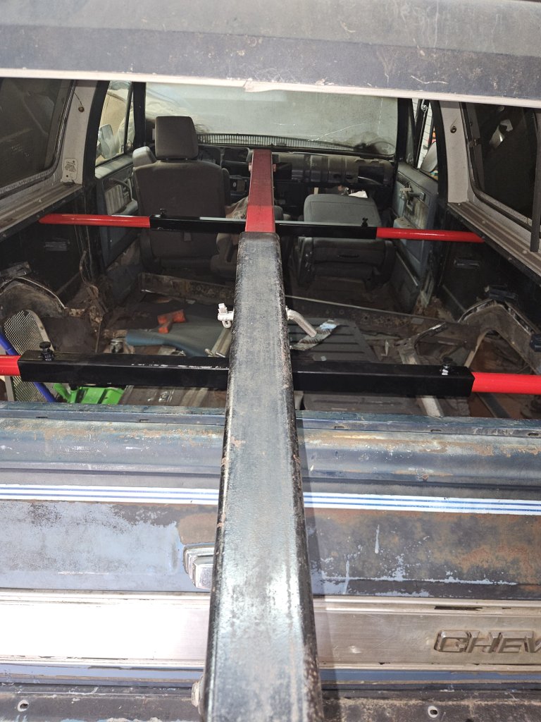

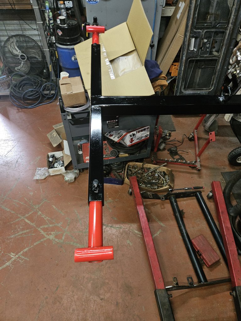

Got the adjustable bed lifter finished and painted. I think it came out awesome. It should do what I need it to do. Edit: I don't now why the other Pic didn't post.

Nice! So you're using the 4 tubes of that tool under the bed caps for lifting?
Yes, I went back and posted a Pic that shows what it does. I don't know why it didn't post with the other two...
