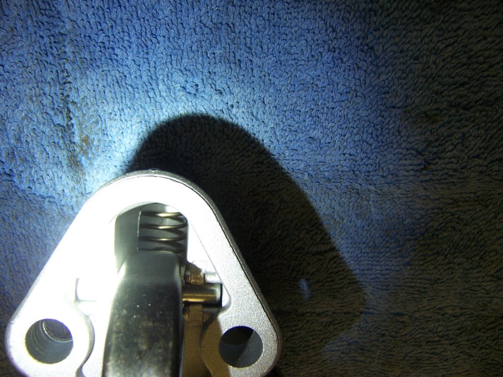

I'm working on replacing my 2nd bad Napa fuel pump.Since December '23.

Have posted this before. After going through 3 new pumps in about 200 miles did a little research. Appears some manufacturers have omitted the return spring on top of the pump arm. First few did not have the spring. Pump arm would stick at about mid travel resulting in next to no fuel volume. AC pumps still have the return spring. Bought spares now. Picture of spring below.
Ethanol was not causing the issue; this truck only gets E free.

My pump has the spring under the arm.The ones I bought did not.At the time could not find one with return spring.Advance Auto has them.Just got one with the spring and installed.Truck runs! For now? Lol.This one pumps and doesnt make that knocking noise

Second day(02/25/24) running new fuelpump.All is good so far.Maybe it'll last another month!
