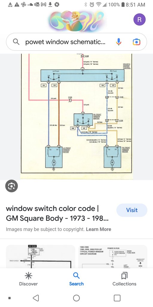

It appears the window motors ground to the door probably through the window motor body itself like a starter. On another post I told you where the most important 3 grounds are battery to body so the entire body is a ground for anything attached to it. Battery to frame so the entire frame is a ground for anything attached to it battery to engine so anything attached to the engine has a ground.Notice your starter doesn't have a ground, to the battery it grounds through the block to the battery. Notice your headlights don't have a ground wire going to the battery they ground to the body. Everything on that truck grounds through the body, the frame or the engine.
