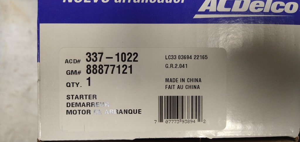

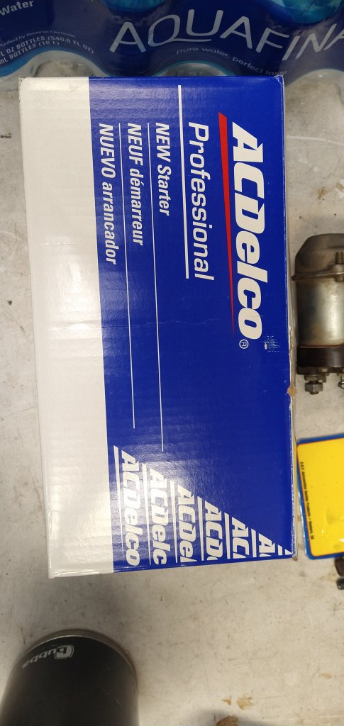

FWIW, I put a new AC Delco, Permanent Magnet High Torque starter (98) on my truck (85) today. Nothing wrong with the OEM 85 unit. OMG! What a difference. 2/3 the size, twice the power, 3 times the reliability. The sound difference is amazing. Worth every penny.

Do you have a link to the one you used? I didn't know AC Delco made a better starter for these trucks.

Love those little starters!
Starter for a GMT400 truck…. They’re technically not for our squarebodies but came from a SBC so they bolt right up.

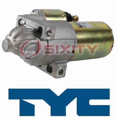

Thanks! I'll see if I can get one. Got more time to work on the truck now, so I'll see if they have one at the local starter rebuild shop. They'll know exactly what I need to upgrade I'm sure. Especially if I tell them the info posted here.
EDIT:
Basically this one. If it bolts right up, I guess the only concern would be the gear teeth matching. That pic says 9 or 11 tooth drive gears. Guess I'll just count the teeth on my starter.
