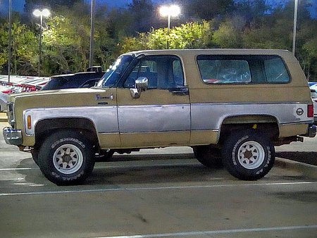

3 inch Rough Country on 32x11.50. Wrapped on a 15x10, they measure out 30.5.

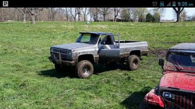

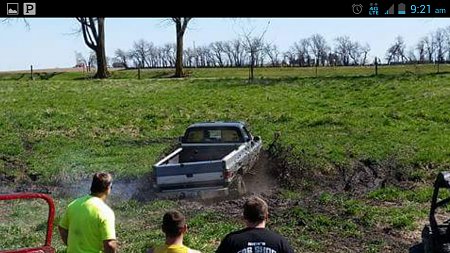

7Ich 4 suspension blocks on rear 3 body on military 36 12.5 16.5
Big block comin soon and i got a truck ned camper so thinkin gettin rid of body and goin all spring

I'd go for a combination of a smaller body lift (~1" or so) to allow for that little bit of extra clearance and then go all spring. From there, run a set of ez rates if you really do need an extra inch after all is said and done.
