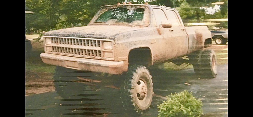

‘83 GMC ( wrong grille ) K-3500 with a double stack of Superlift 8” front springs and a double stack of 56” long 30-series rear springs with a OEM Dodge W-350 5-5/8” block out back. It came out to be right at 11” of lift - but it did sit slightly high in the front and no possibility of tires rubbing.
With 38x12.50 Super Swamper TSL’s on stock bud-wheels.
