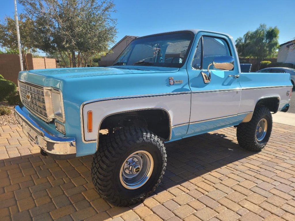

15 GMC Royal Sierra
2" RC, 33x12.5x15. No issues

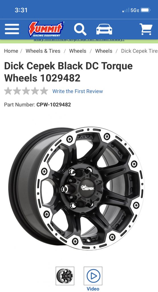

Planning to put these 20 x 9 on my K20 with 4” lift. What tire can I get away with before I get into clearance issues? I wasn’t planning to put aggressive treads on it.
My 20x9s 3.5bs are basically a -25mm offset (1” neg offset).
Those are 1/2” neg offset.
My old wheels were 0 offset (16x8, but that doesn’t matter when talking offset vs backspacing. Rim width is largely irrelevant. Whereas the same backspacing is a different offset with different rim widths.
0 offset with half wore out 315-75-16s (closer to a new 33” mudder than a 35) did not rub at all under normal daily driving, but had in the past. (I repaired both bottom fender corners from light tire damage).
The wheels and tires I have now, tires are a true 35” mud tire with ALOT of tread depth will rub at full lock with the slightest little suspension bump.
You’re halfway in between the 2 scenarios for rims, so a not so aggressive AT tread may just work barely without rubbing. But something a bit narrower like a 295-65-20 I feel would work without issue for daily driving.
As all lift springs are a bit different and tire profiles/actual sizes also vary, what I said above may be slightly better or worse than I estimated.
Even the trucks are built a tad different or worn or not or bent up at some point or not.
Example, I’m 100% confident that my truck has never been in a major accident or beat on excessively. Yet 1 side is shy of 1/4” different than the other, when the tires are closest to rubbing. Yet with wheels straight, the measurements are the same.
If you have the chrome fender trim, the tires will rip that off instantly. But if the trucks not all gussied up and restored, you could probably get away with minor rubbing say turning tight into a driveway approach.
