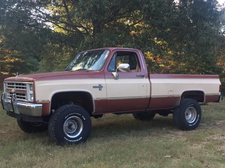

Our '86 finally got 33's gonna rock the Rallies. 4" Superlift Soft ride lift. I like it and rides like how I remember these trucks rode when I was a kid.

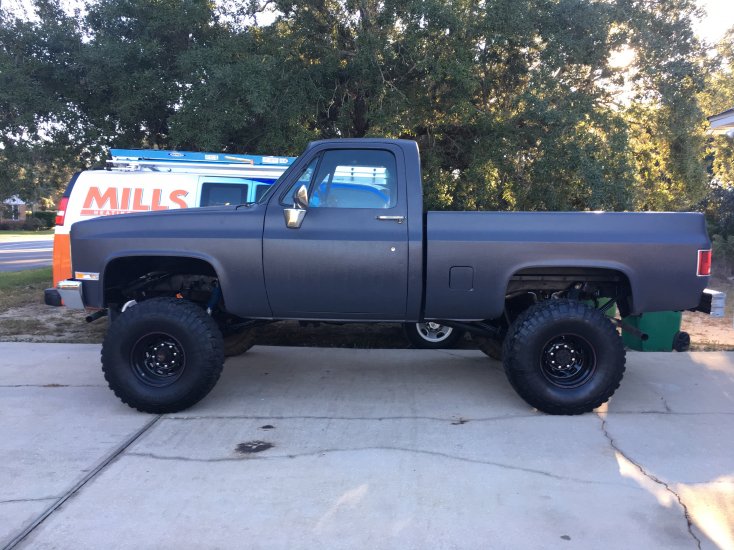

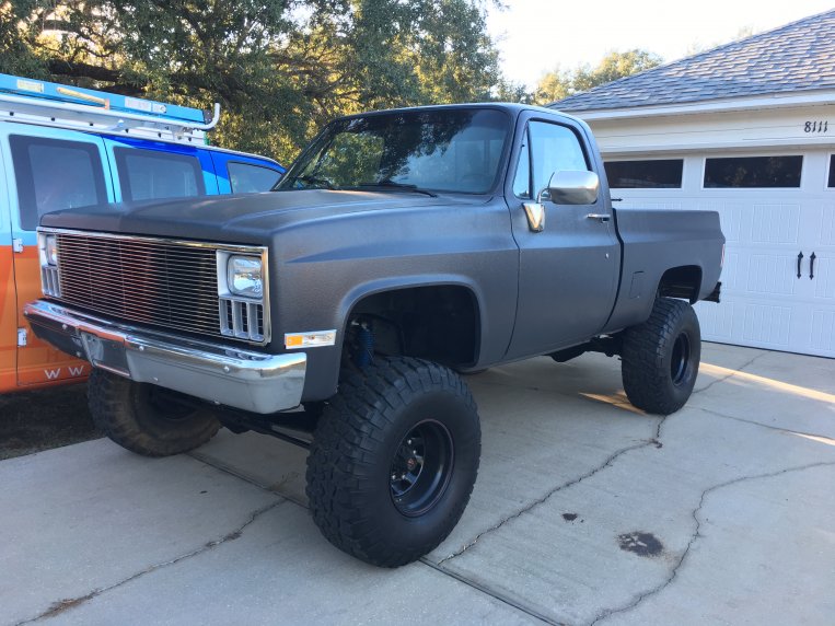

82
6" lift, 35" tires. All spring no blocks

Looks sweet , perfect set up , 6 and 35's
:cheers::cheers::cheers:
