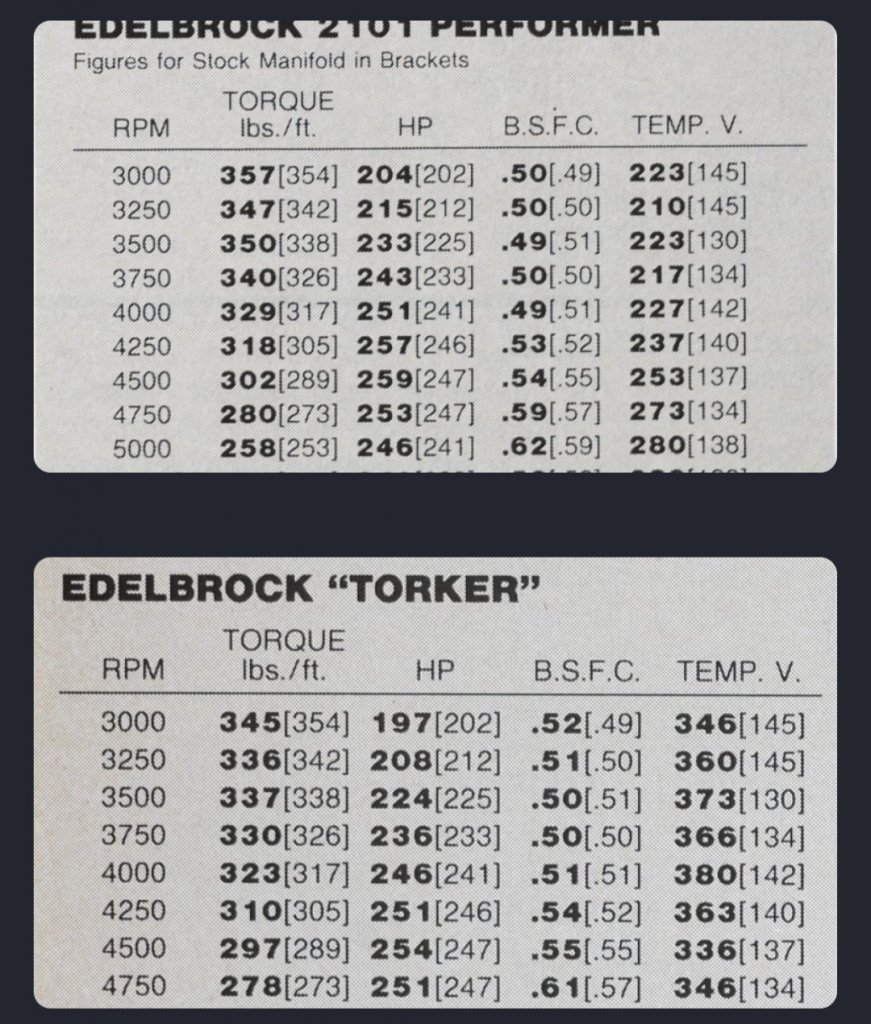

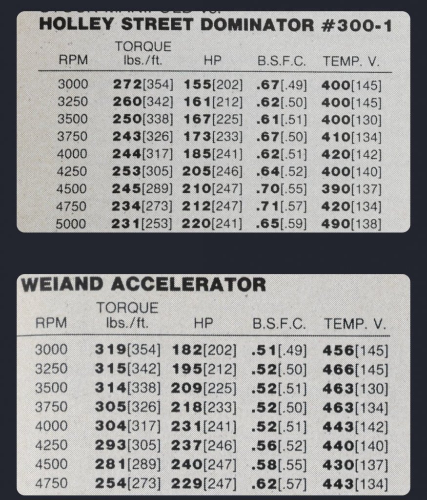

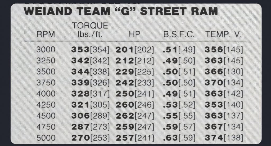

I had to laugh,not at what you said,but at the dyno numbers. The street dominator is just a crappy manifold,it made me laugh. I still think he had an intake leak,and probably not enough initial timing as well as a crappy manifold. But look at these numbers OE manifold is in parenthesis. Torker single plain,a 650 Holley and headers was everybody's first mod 1980ish. Not saying it was the smartest combination but we all made them idle and drive.

We ran single planes with nothing more than a carb and headers on stock small blocks. It would be a bit lazy just off idle but a cheap stall converter even a small one would help it not be as mushy on the bottom end because it'd allow the engine to rev up into 2000+rpm range bypassing the off idle issue.
The cheap mods we ran were intake, carb, stall converter, shift kit, and sometimes a mini spool if we didn't just weld the gears up. If you had the money later on it was cam and small chamber cast heads. We were doing this in high school with our first or second ever cars/trucks.
