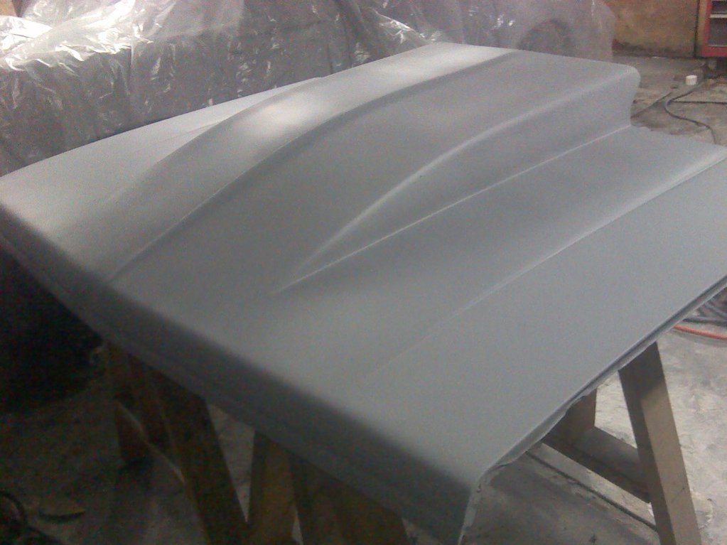

hoods getting a scoop, it was a crap aftermarket replacement anyways...

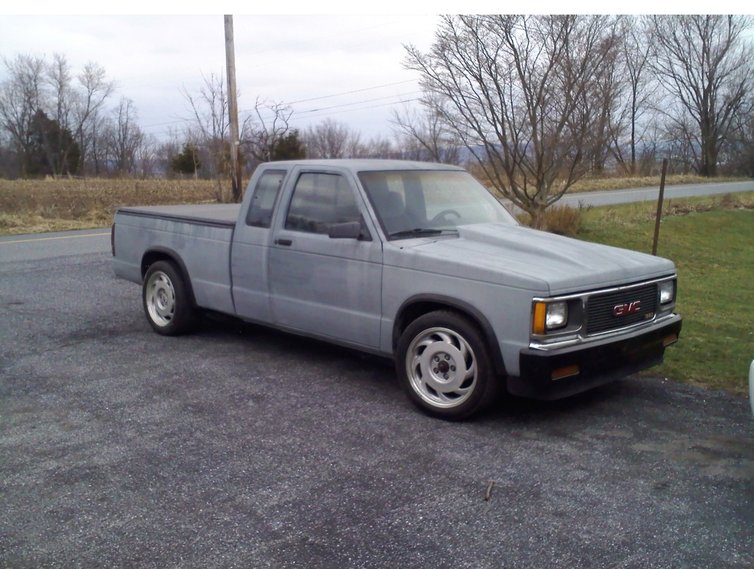

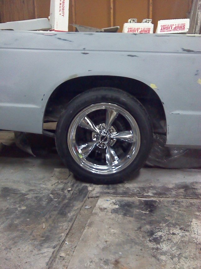

I did order some wheels, got a great deal on em, gong with 17's (eeekkk) I was never a fan of big wheels but I got these 2 cheaper then any of the decent 15's I liked, so gonna try em. I got 2 17x9.5's for the back need some 7's up front. I'm looking into some 275/40-17's out back of maybe 50's for it to have more sidewall, I need some up front but can't get much more sidewall due to not alot of clearance up front.
I've got an inch or so clearance up front with 26 inch tall tires
back the ps has 4 inches and the ds rear has 3, but the truck is sitting weird, need it on level ground to check

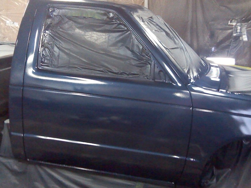

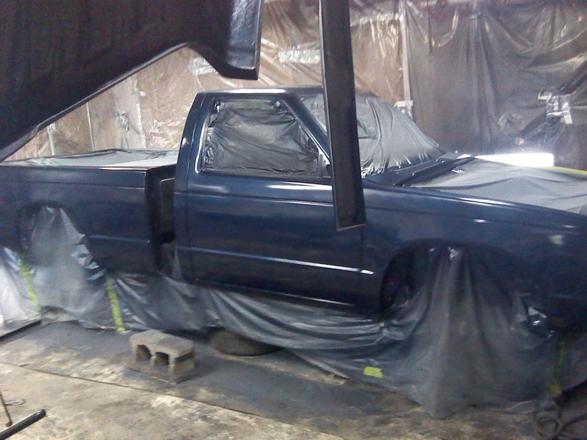

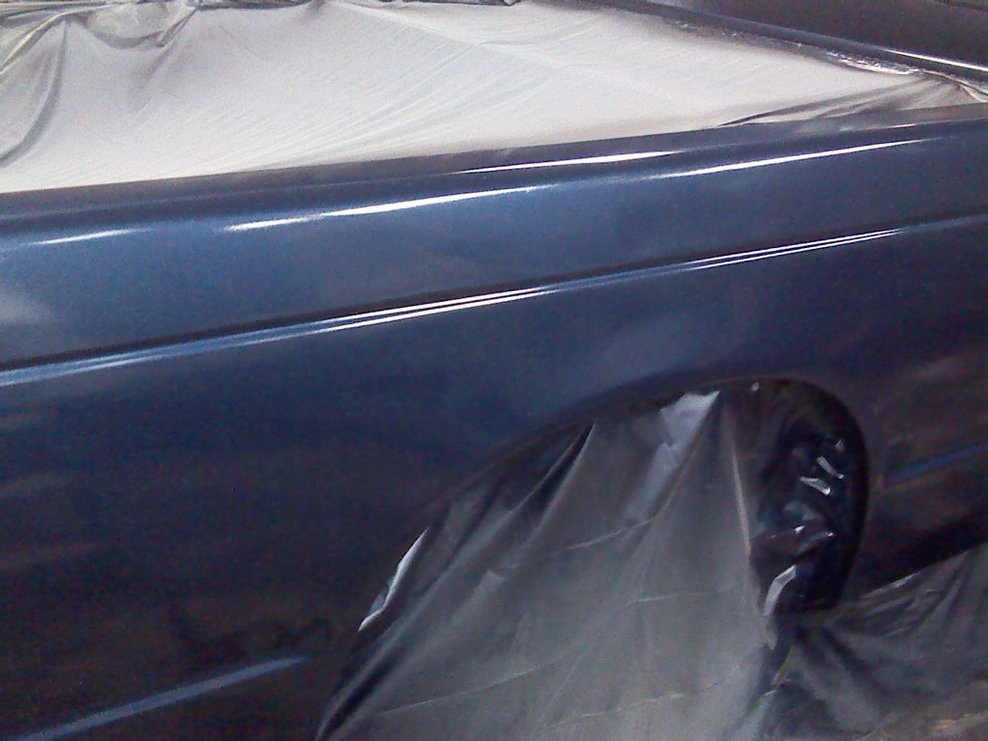

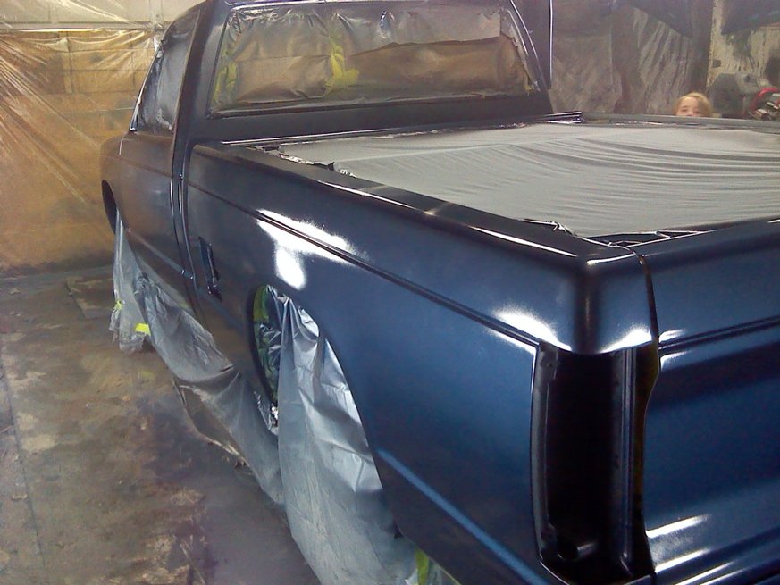

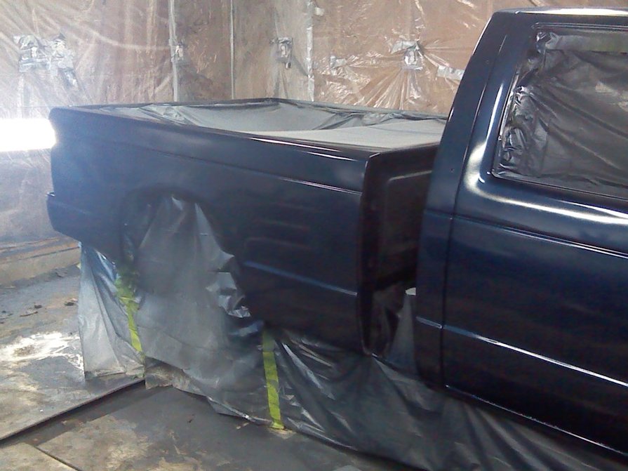

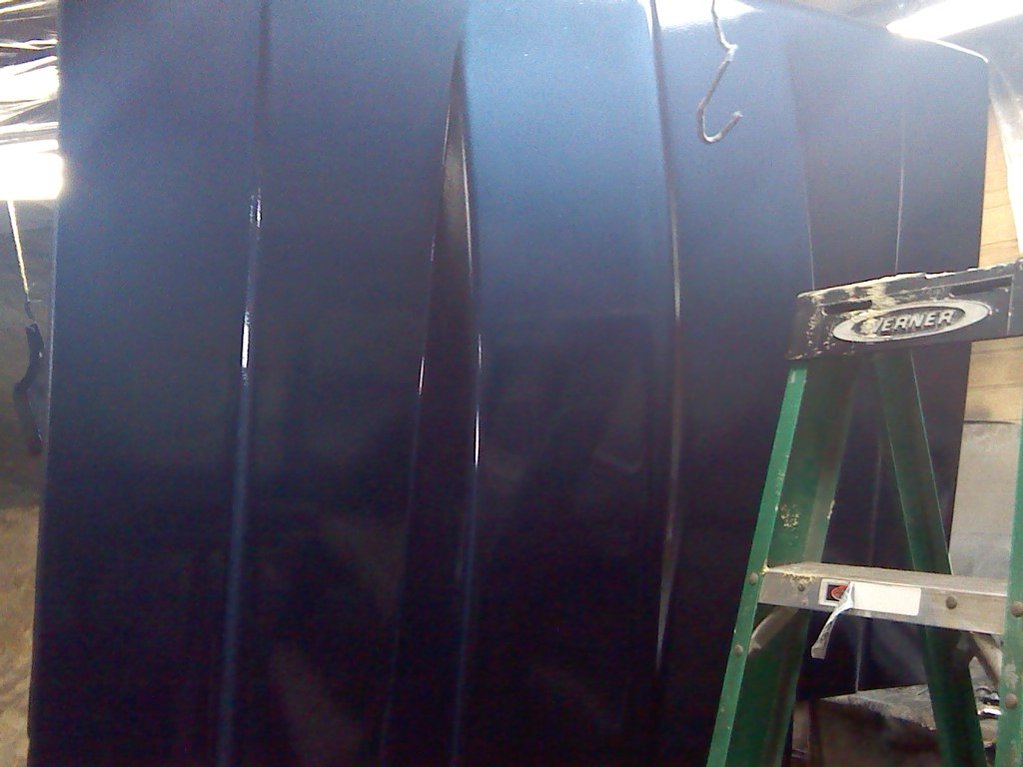

didn't realize I never updated with the hood pics or when I got some tires for the back

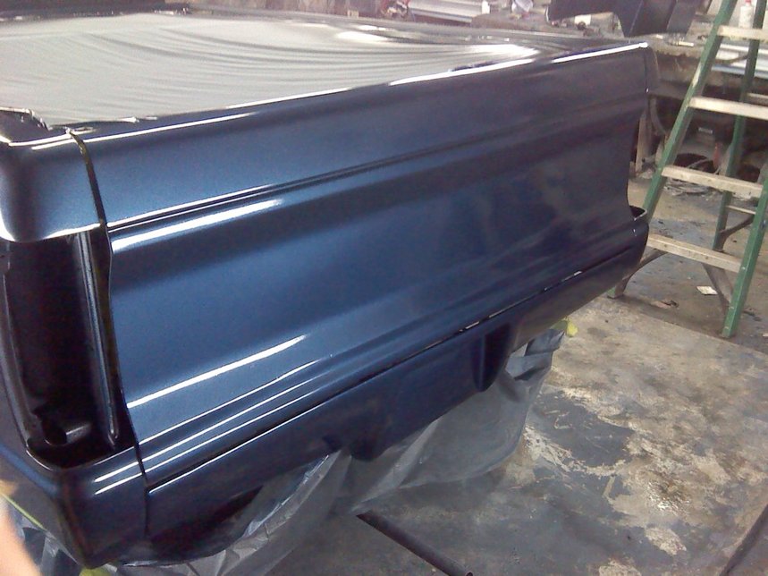

thanks truck is all wet sanded down ready for another gallon of clear to be put on.
The body shop supply guy recomended I put on the first gallon I've had, let it dry for a few days wet sand, reclear and it'd look like it was laminated. I figure it's better also because for one I always cut and buff once done anyways, and I only got 2 coats because my gun was acting up not laying down good. That and the first gallon I had for years was a euro clear and only thing they have now is a high solids clear by the same company. So it has one gallon of euro clear with 1 quart of hardner laid down on only 2 coats, and will have a gallon of HS clear and quart of hardner hopefully I can get 3 or 4 coats this time, I got both my guns cleaned good so hopefully one of the 2 will lay it down nice.
There's gonna be new guns bought for the next project, one dedicated primer gun with a 1.8m or so tip and another good one for laying down base/clear. Hopefully I can get more pics tomorrow. I'll be waiting until next month before I can cut and buff, got some dr. appointments coming up and things and I have to buy another buffer
