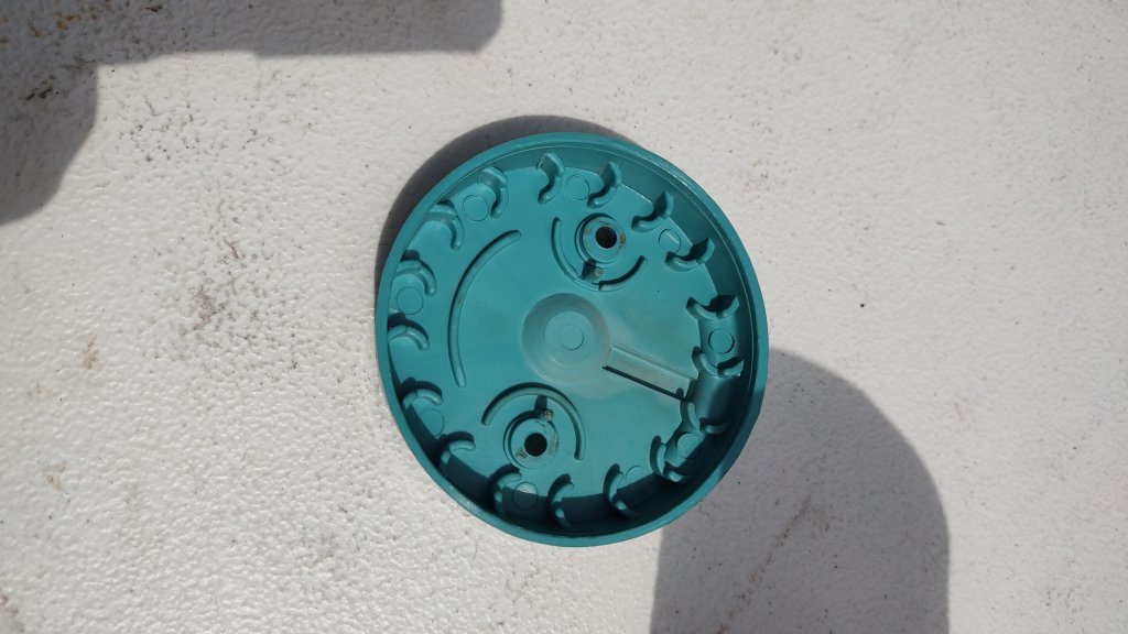

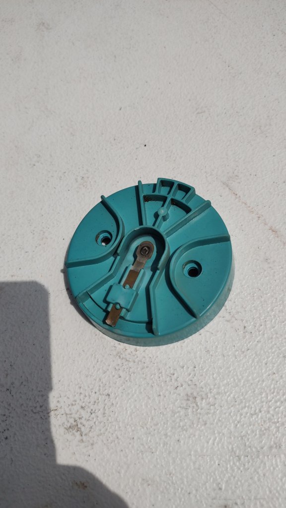

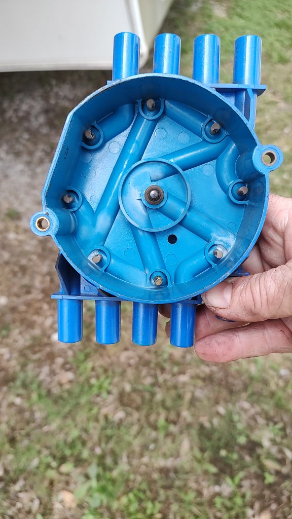

Yes, also needs a good battery and distributor cap and rotor. If the cap and rotor look like this, it's "time for a change"....
This is off my '97 C3500 Vortec one ton, truck actually ran pretty decent with these parts. Ran a LOT better with a new cap, rotor and wires though!
The United Motor Products cap and rotor set are around $30 at Rock Auto, well worth the investment.
