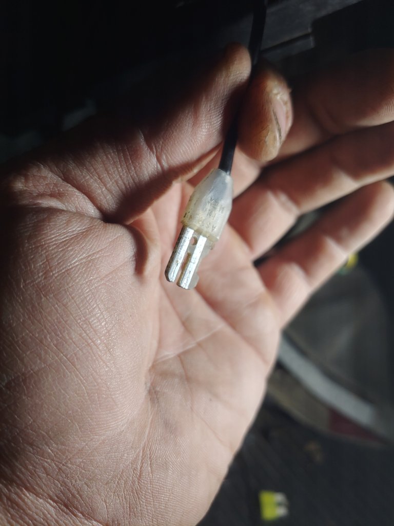

ooh.....what does this plug into? It's running through the column. Is this my problem?

That’s from the turn signal stalk, for cruise control.

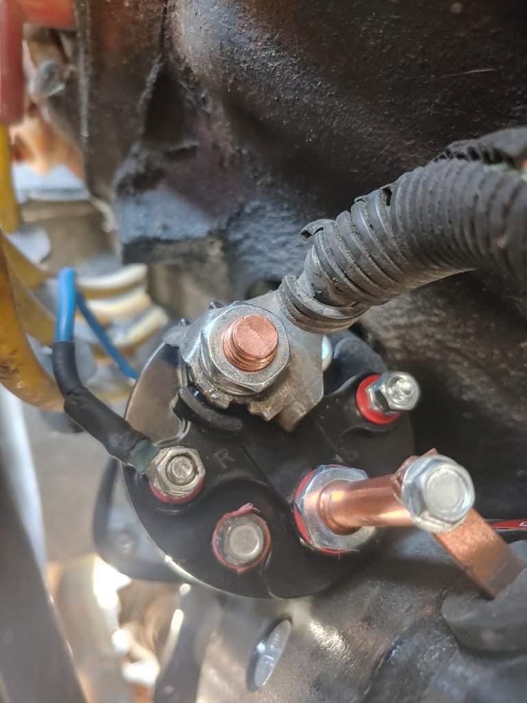

Did this. No luck. Traced all the wires to the starter....found the problem. My buddy had installed the starter for me. Along with a bunch of other bits. Turns out not all of the starter solenoids are the same. The "S" terminal on this starter is on the opposite side of the one that came out. Swapped them and it cranked.
Poured some fuel down her throat and it fired and rand for a few seconds. But the old Mr Gasket fuel pump has failed. Thankfully I keep 3 spares lol.
I may be 20min away from getting to grab 5th in an 83' Suburban.
