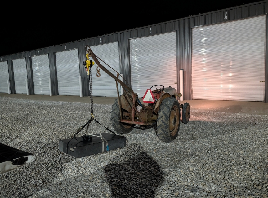

On the 8N I rebuilt the carburetor Monday when I was off work, now it doesn’t flood at idle and will idle down to the 400 ish rpm idle it is supposed to be at.
I shared this photo in the new tools thread, but got this boom pole for free. A nice addition I think.
