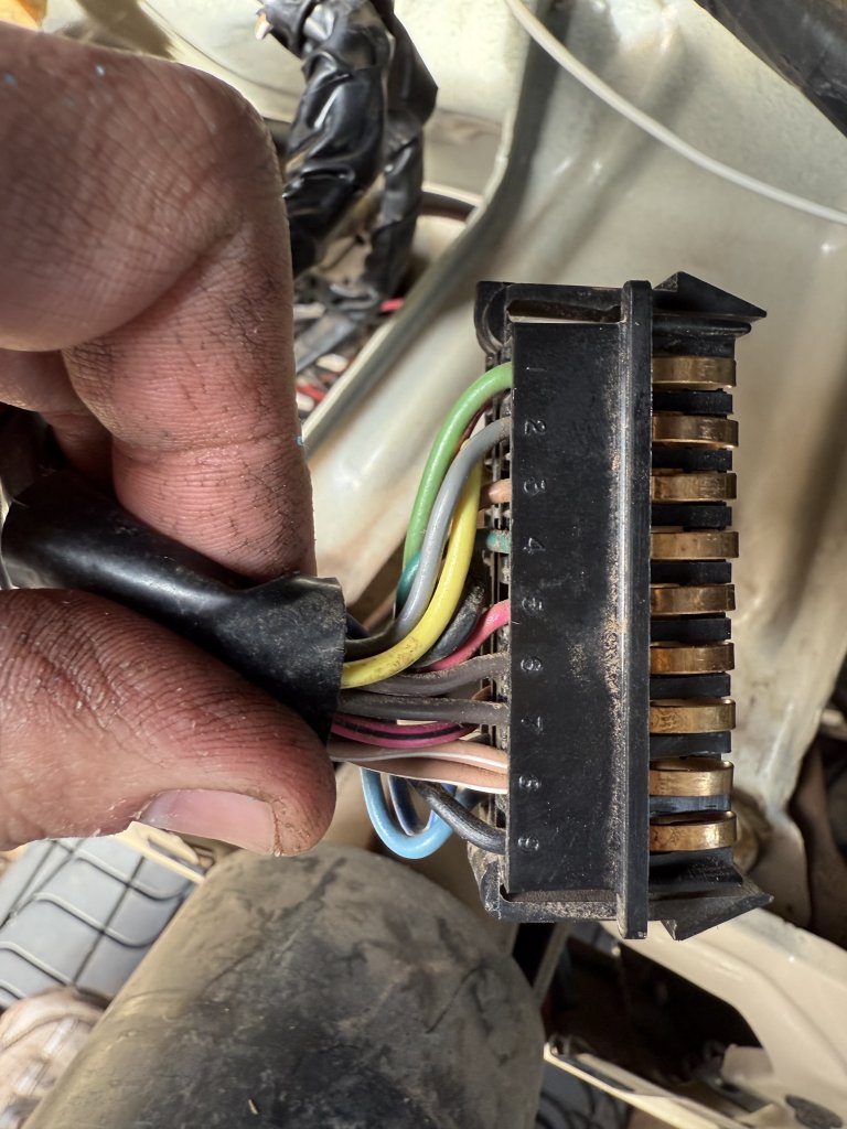

I’m trying to swap my idiot lights to gauges in my 86 k5 Blazer. I tried moving the pins around The big connector but I can only get the volt gauge to work. I used a pin out on another post but some of my wire colors don’t match. Fuel, temp and oil are all pegged and gauge lights won’t illuminate so I must have a few pins in the wrong spot.

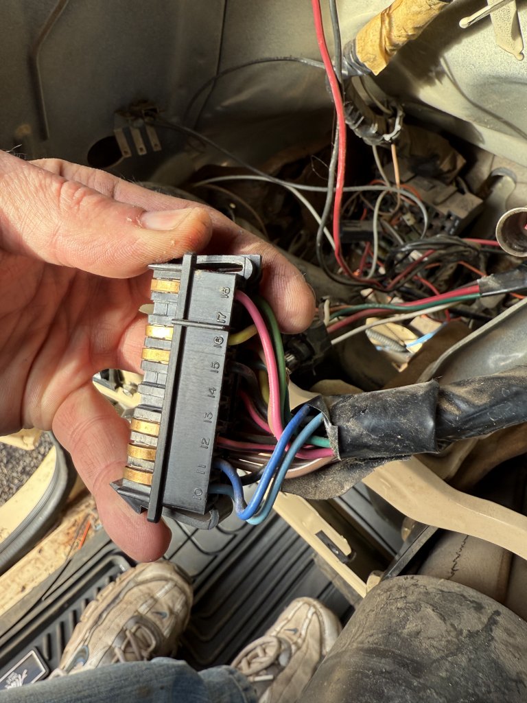

Here’s what my connector looks like. Pic before I moved pins around.

Besides moving pins to the correct locations, you will need a temp sender and an oil pressure sender to replace your temp switch and oil pressure switch.
