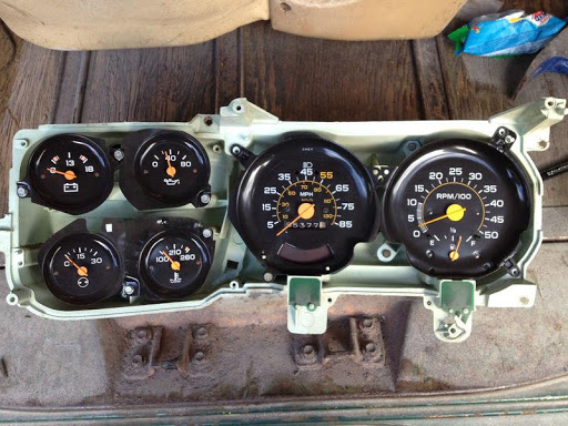

i try to find a C60-C70 cluster for tach with small fuel gauge! :)
If you don't have the clock in your cluster, you still have a blank space.
That is a great-looking setup and I’d like to have the same thing. Did you ever find one?

nope but don't have anymore a blank space! :)

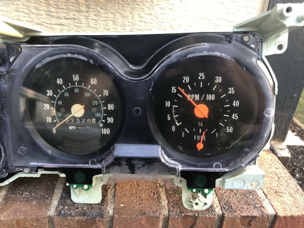

humm in a metric C70 ? loll :)

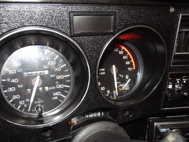

Not a good picture, here's mine. Turbo boost gauge in the lower left.

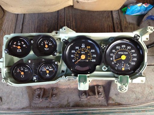

not shure but '73 to '87...for mine period correct is '81 to '87 ;)
