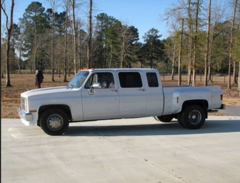

Apparently been done before.

A crew cab will bolt onto a Suburban frame, but using a regular cab will require some work.

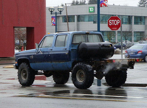

With a frame stretch and lots of body work, you could try to recreate this monstrosity:
