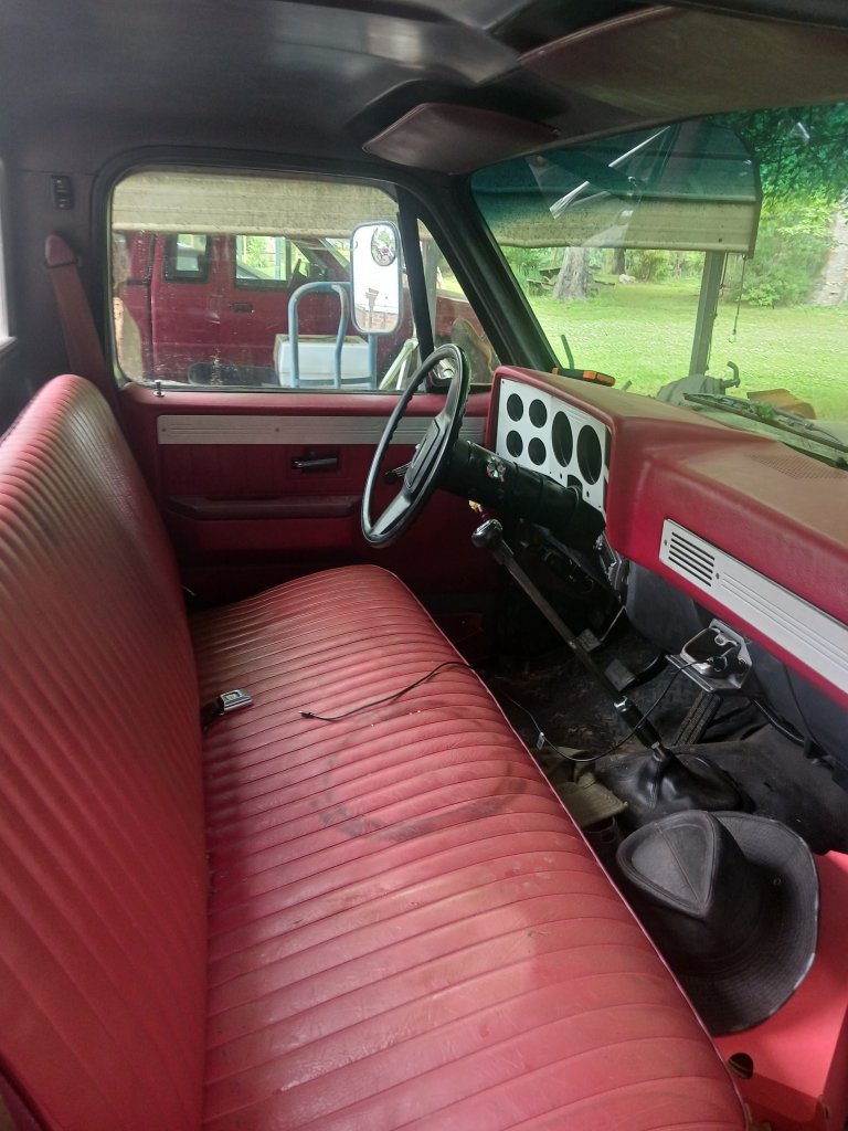

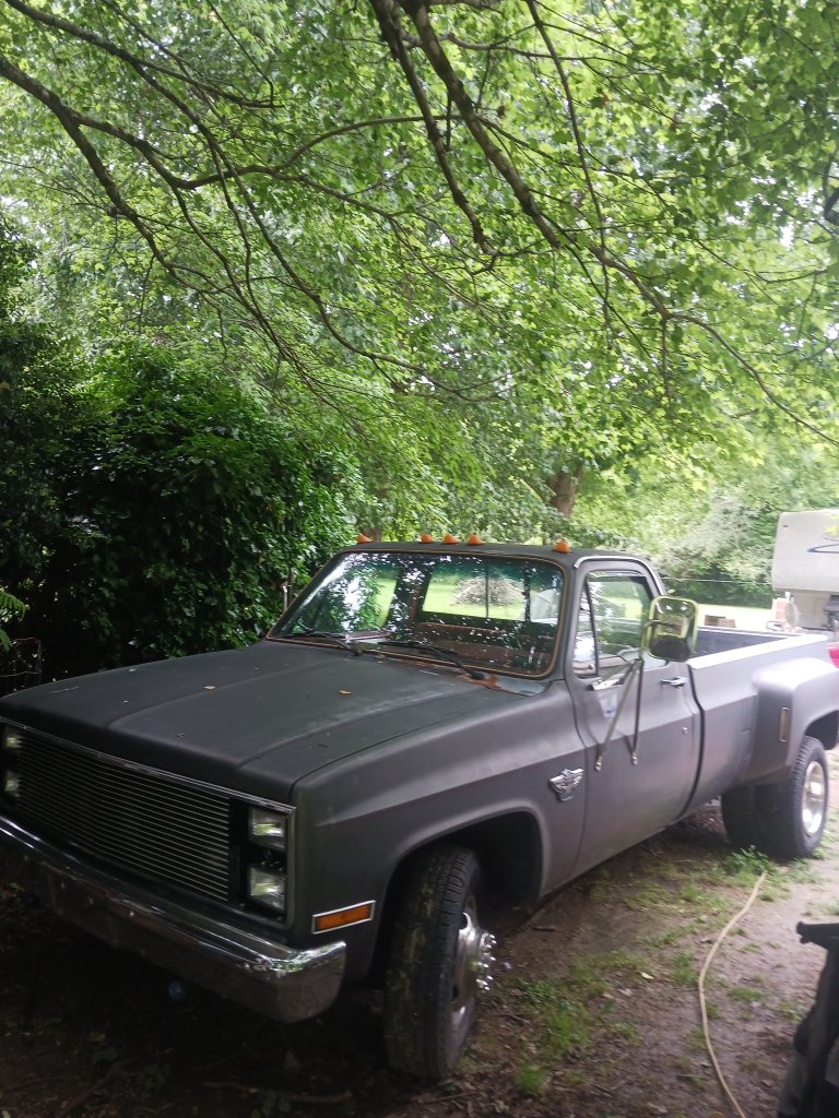

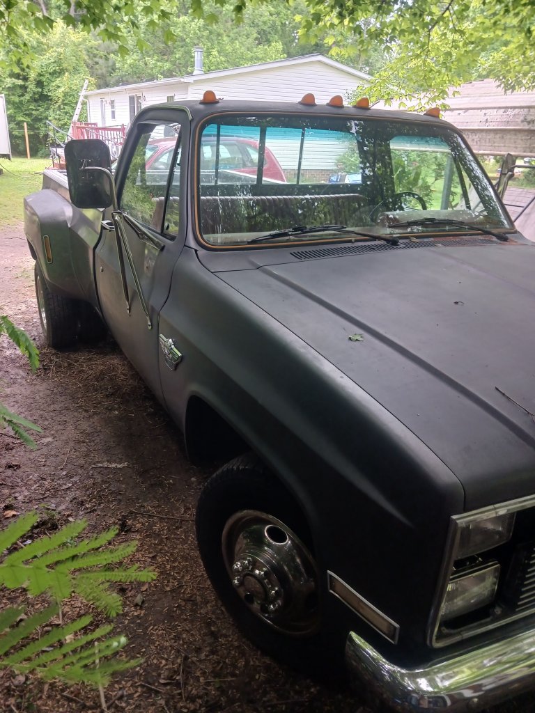

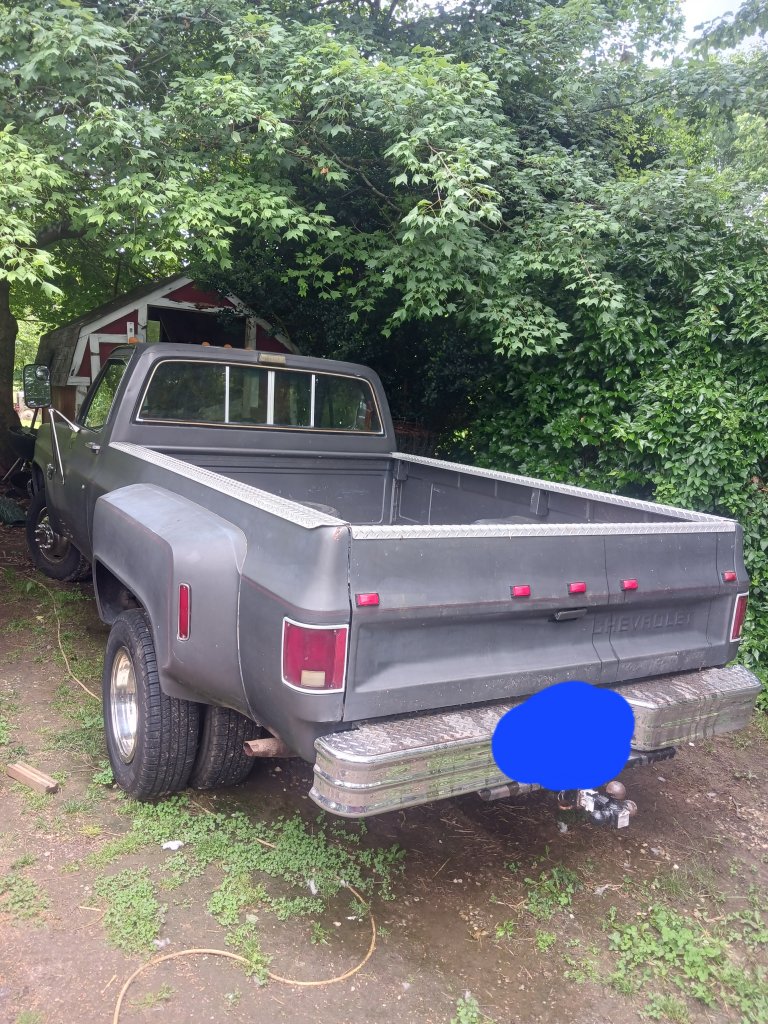

It's a 86 c30 454 with an nv4500 that has about 2-3k on it now. Po's mechanic did his work for him. I first got it, and discovered the positive stud on the brand new starter was overtightened. The engine is tired, keeping me from running 70 without blowing a quart of oil out of it in 2 hours.
So, I want to rebuild the 454, rewiring the truck while engine is out. No emissions here. I would like 500 hp and 600 tq. I'm also new to this transmission. It's a 5 sp, but actually 1st is granny, giving r normal use gears. I'm thinking a stand alone od unit for a lower rpm at 70, which with out a tach, can't tell. Just keep it under the vibration now, around 75ish.
Ford fan, that found it and had to have, and want it updated, but still semi original. There was a lot of work done. I just pulled the fuel tank, discovering lmc brackets, because it started dumping fuel when shut off from the tank. All lines were rotted.
Don't think the factory heads could get me there, nor the comp ratio. What's a cast head, cam, comp ratio combination to get that power out this 86 454?

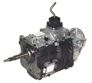

As for the NV4500, there's 2 different gearsets apparently. A Gear Vendors would be a good option to get the RPMs down on the hwy.
