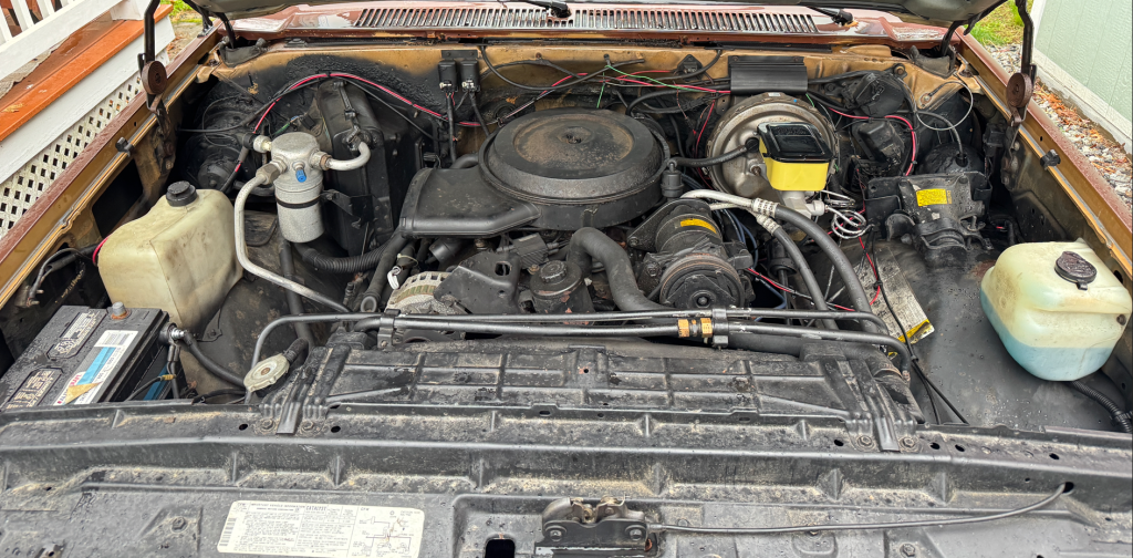

Hey Yakko. Yep, my alternator is on the passenger side (see pic of the engine bay). Note that I removed the intake tube which leads to the front of the engine bay because I needed more access while troubleshooting that electrical issue.
What wire gauge do you recommend? I'm thinking 12ga or thicker, silicone jacketed, routed around the engine in a pre-existing wire bundle on its way to the positive terminal of the battery.

If thats the primary power output, I'd consider 10 gauge or maybe even 8 (10 is normally good for 30 amps, 8 is good for 40 amps but in a hot engine bay wire resistance may become a factor and shorter is better). If that wire is only the exciter (gets 12V from key on power source to energize the coils in the alternator) than a smaller gauge is probably fine. It probably should also have a fusible link in there somewhere.
On my truck the alternator is where the A/C compressor is on yours, so the power wire just runs inside the valve cover along the intake straight back to the firewall (I used some old heater hose as a conduit to protect it). There is a second wire going from the back of the alternator over to the battery. I belive both are 10 gauge but I wouldn't claim either of them to be original - I'm also not convinced my alternator is original either.
