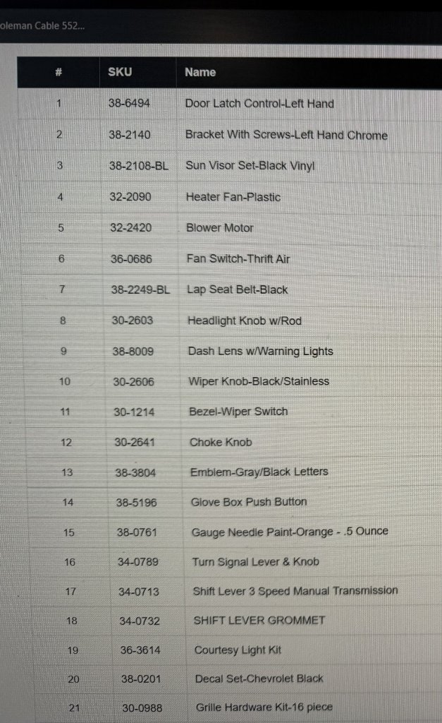

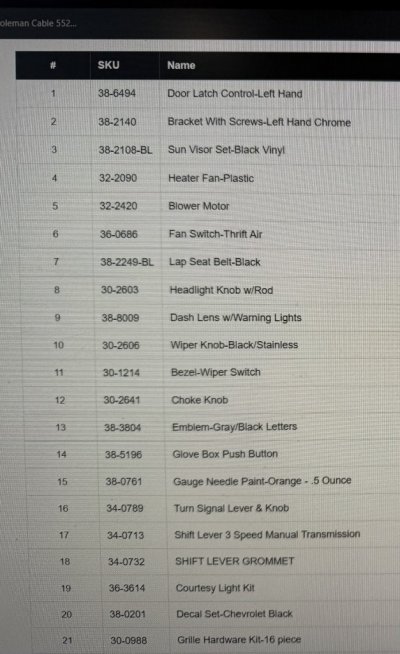

Yeah gonna get that corvette pcv and get the breather changed to a tube to the carb
Bought a long list of crap I’ve been wanting to fix. Also ordered new windshield wiper arms and blades, and a NOS Chevy steering wheel cap. This should make a lot of stuff functional again.
I was thinking about it, I’m probably not going to spend the $250 on a performer intake for this engine, since I’m probably not going to run it forever. I’ll just fix the leak and be done with it.
As far as I can tell, I am $4170.87 into this truck since I bought it. Which is insane, because there really hasn’t been any huge changes. Just goes to show you what restoring/rebuilding a classic vehicle takes. Seems like I’ve done it a dozen times now, but this is the first one I’ve had that’s going to need everything. Square bodies spoil you, they already have a lot of modern amenities.

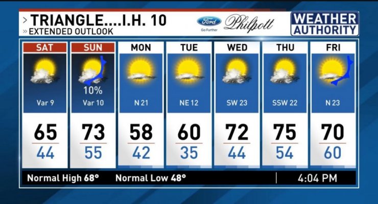

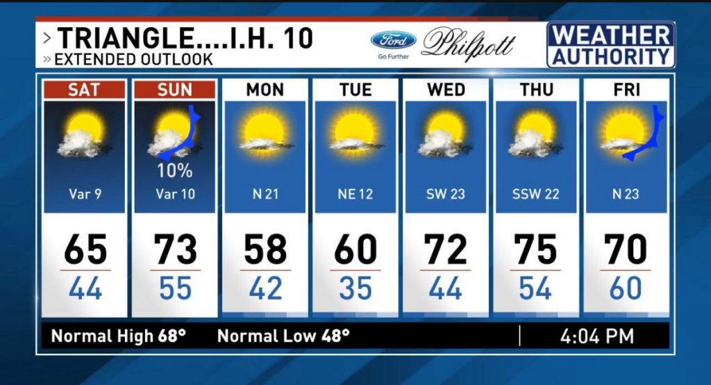

I was excited to try out my new windshield wiper arms and blades that came in tonight. Been raining a lot lately.
Maybe next time
