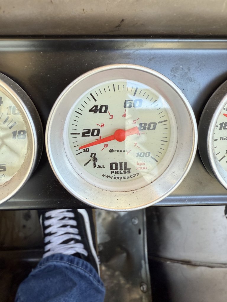

Crazy to me how this is the oil pressure at idle and the engine seems to not care. 40 pounds of pressure at 70 miles an hour or really any miles per hour other than idle.

10psi per 1000 rpm is the general rule. Oil pressure is also heat and viscosity dependant.
60 pounds cold, 40 at all speeds when warm. 20/50 VR1.

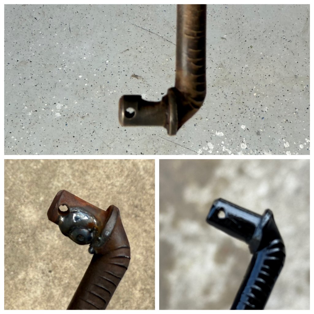

Been working on Zach’s square body, so haven’t done much to mine. Did take care of this clutch rod, though, connects under the dash and goes through the floorboard. It was like this on both ends, 60 years of wear and tear. Beating around all loose, Louder than two skeletons f%#*ing
