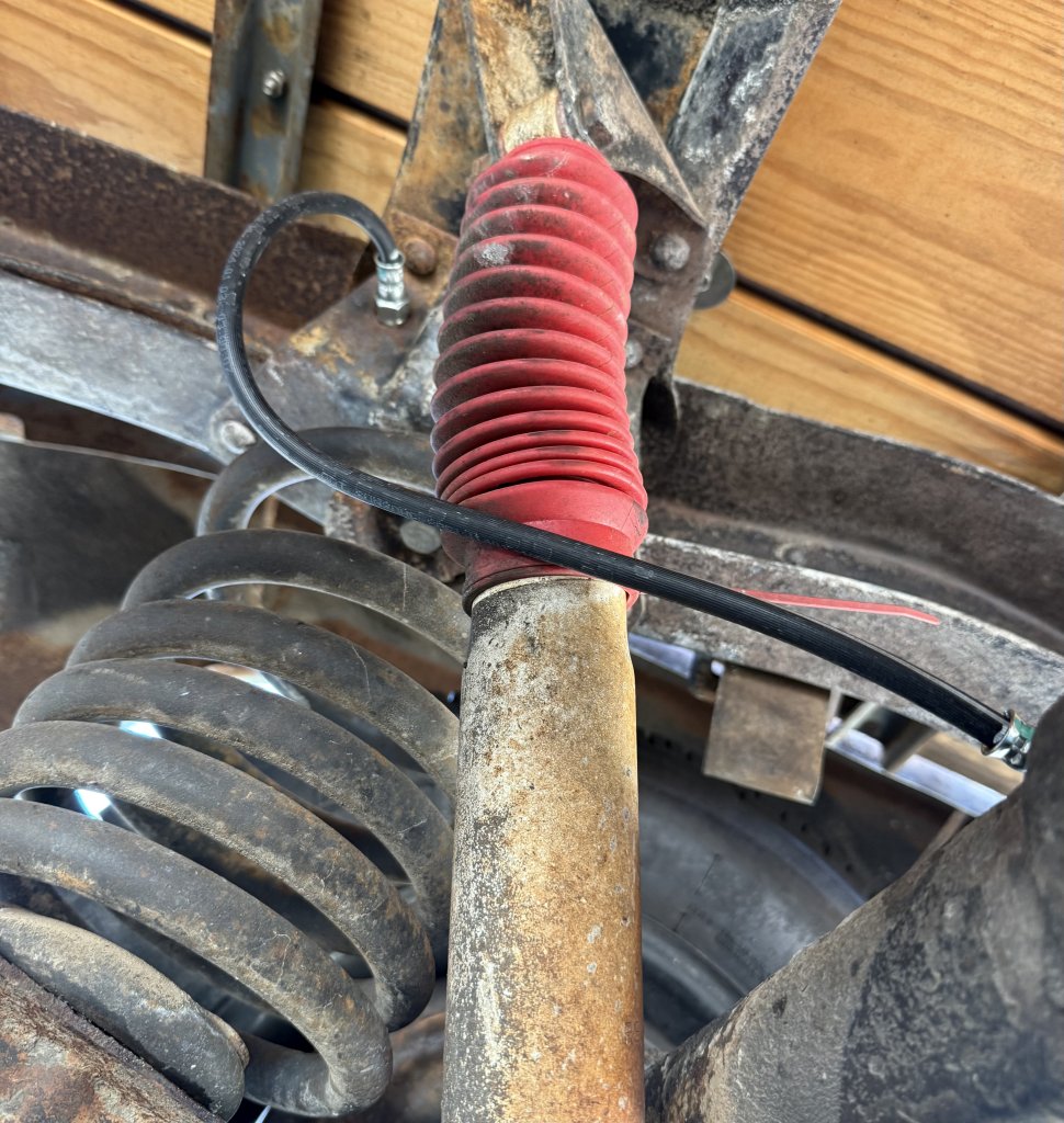

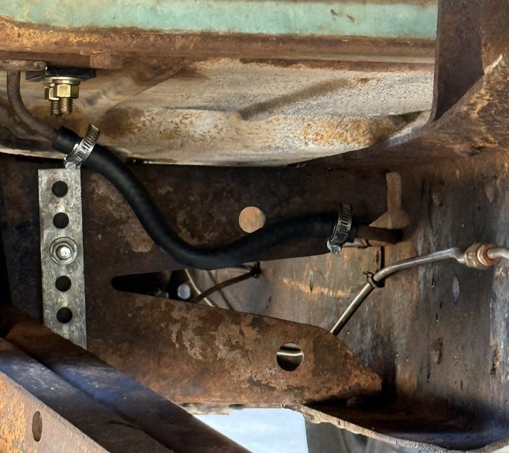

Got the rear brake hose on. Noticed several weeks ago that the rubber fuel line from the tank to the hardline is old as hell as well. Got a foot of 3/8 fuel hose while I was at O’Reillys. Got everything ready, took the hose off, but the new one on, won’t seal, it must be 5/16 line. Went to put the old line back on and it’s split. Gasoline all down my back and in my hair, running down the driveway while I drive across town to get the right hose.
14,030
24,148
Keep in mind you'll need a 5/16 to 3/8 reducer if you install the 350. It'll go between the hard line and the fuel pump. Sucks you dumped all that fuel. Been there, but I was removing the cab and thought I'd drained the tank completely.

Yeah, it almost completely emptied the tank.
