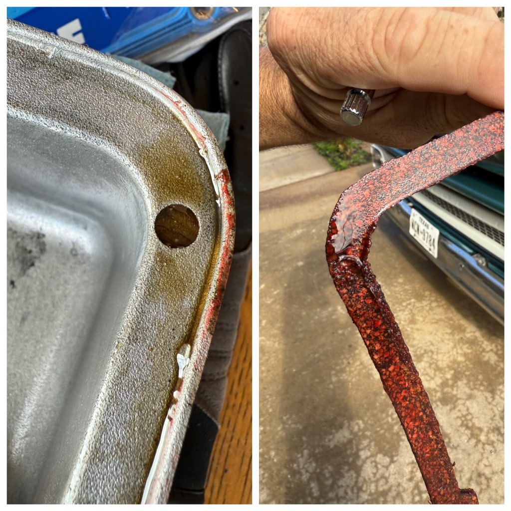

I bought an installed a new PCV valve, even though the old one rattles when you shake it. I removed both valve covers, sure enough both of them are leaking in the back lower part. That’s just crazy to me, because I literally had to pry these off with a pry bar. Permatex gasket sealant on both side sides.
What kind of crank case pressure could do this? Or is that even the issue? I just picked up the $75 fel pro blue with steel core. While I was at O’Reillys, I bought some of the steel chrome 4 inch long wing nut valve cover bolts, but of course the threaded part is not long enough now because the blue gasket is so thick. Wasted money. Need to go to the hardware store to get new bolts.
Also going to pick up that breather today, hopefully it has the draft tube with it

And something I just noticed, why is there a hole on the valve cover in that back corner? I’m away from the truck right now but when I get back I’m going to look at that
