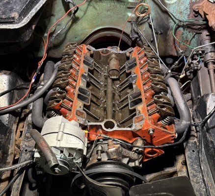

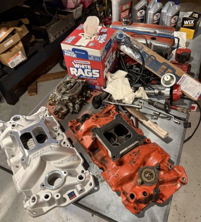

A rinse off before getting a new intake

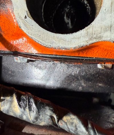

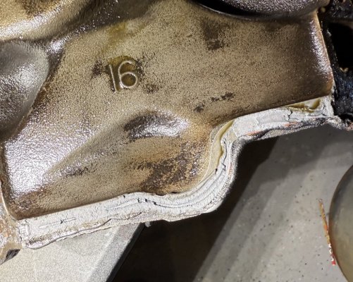

Call me crazy, but I don’t think I have an oil leak from the front valley of the intake manifold. If it’s leaking, it would have to be from that left side that is wet. That’s the side. It seems to be coming down the timing chain cover, and going everywhere on the crossmember.

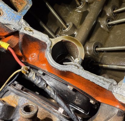

Could it be coming from the top of this cheesy timing chain cover on high RPM? Find out on the next episode of Dragon Ball Z. Or at least after I put this intake all back together and it still leaks lol

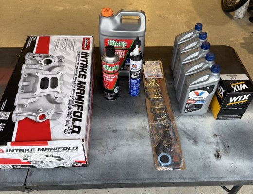

I was going to put this thing all back together tonight, but I decided to do it right and order some more stuff from Summit. ARP stainless intake manifold bolts, same for the water neck. New water neck coming, two new stainless heater hose fittings
Should I make a hardline fuel line from the pump to the carburetor or just keep the rubber I have? Dammit, I meant to buy a carb spacer. Back to Summit. Kids aren’t getting a Christmas this year.
BTW, the high dollar fel pro valve cover gaskets seem to have done the trick. They arent wet.
