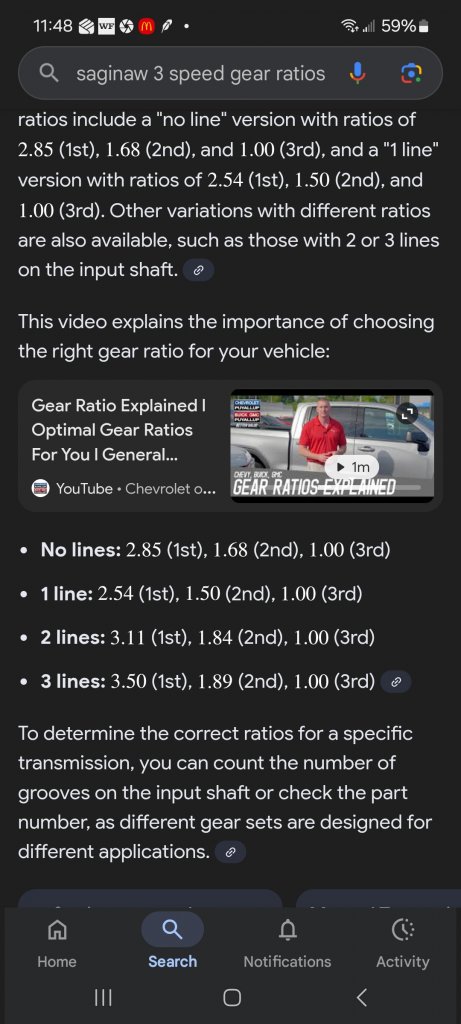

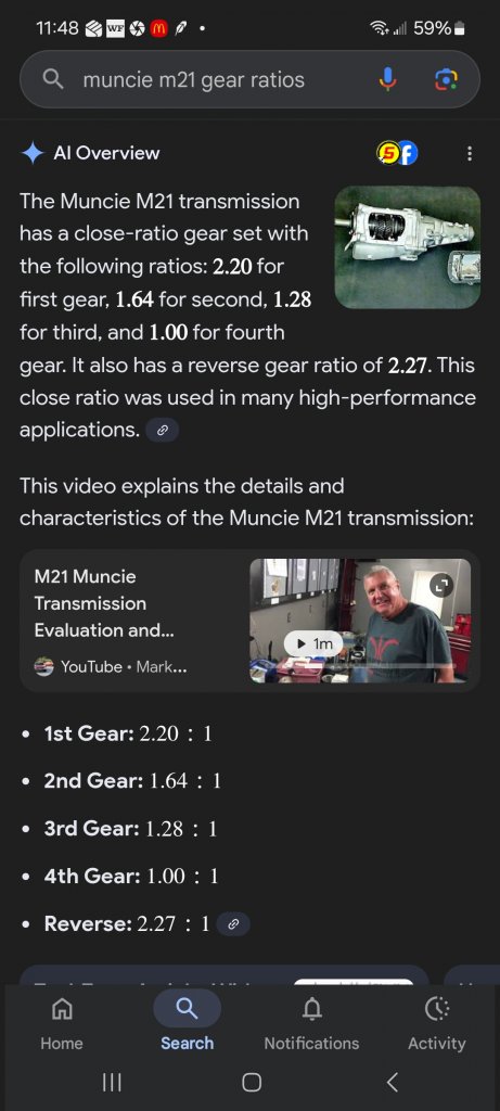

That wouldn't get him a better take-off gear, just an extra shift to get to 1:1. Fun factor is higher being a floor shift, but clutch slipping to take off, and no better highway gear.
That will depend a whole lot on which saginaw 3 speed he has,there are at least 3 if not 4. Now the m21 was a real good transmission for a 4 speed car. Camaro,Chevelles,442s. I thought his problem was 1st gear was too steep.

Well I wish I could have grown up driving trucks/cars with these transmissions in them but all were automatics, except my moms 1991 toyota corolla lol (which I learned to drive on), so I have zero experience with any of them.
Yeah I mean I can shift the 3 on the tree as fast as anyone, I've certainly had the practice, and the bushings I made got it smooth, but like I said, those first couple gears dont care how much hp you have, you aint getting out of anyones way. I understand the rear gears play a part too....
I'm not building a race truck either but it needs to be able to move out. Maybe I can youtube videos of guys installing/driving the different manuals to see
He has borg warner 3 speed
And yes, the Muncie 4 speeds are great.
