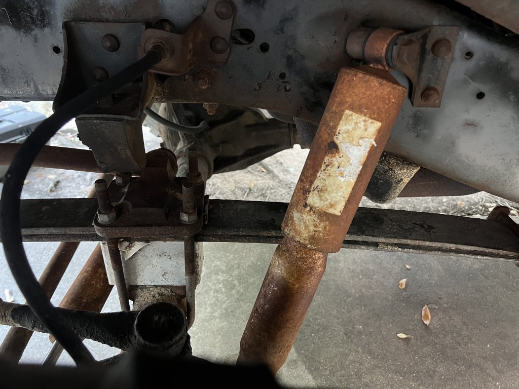

If I’m not mistaken, there are two different bumpers- one at leaf plate and the other right there behind shock. The ones near shocks left marks on leafs.

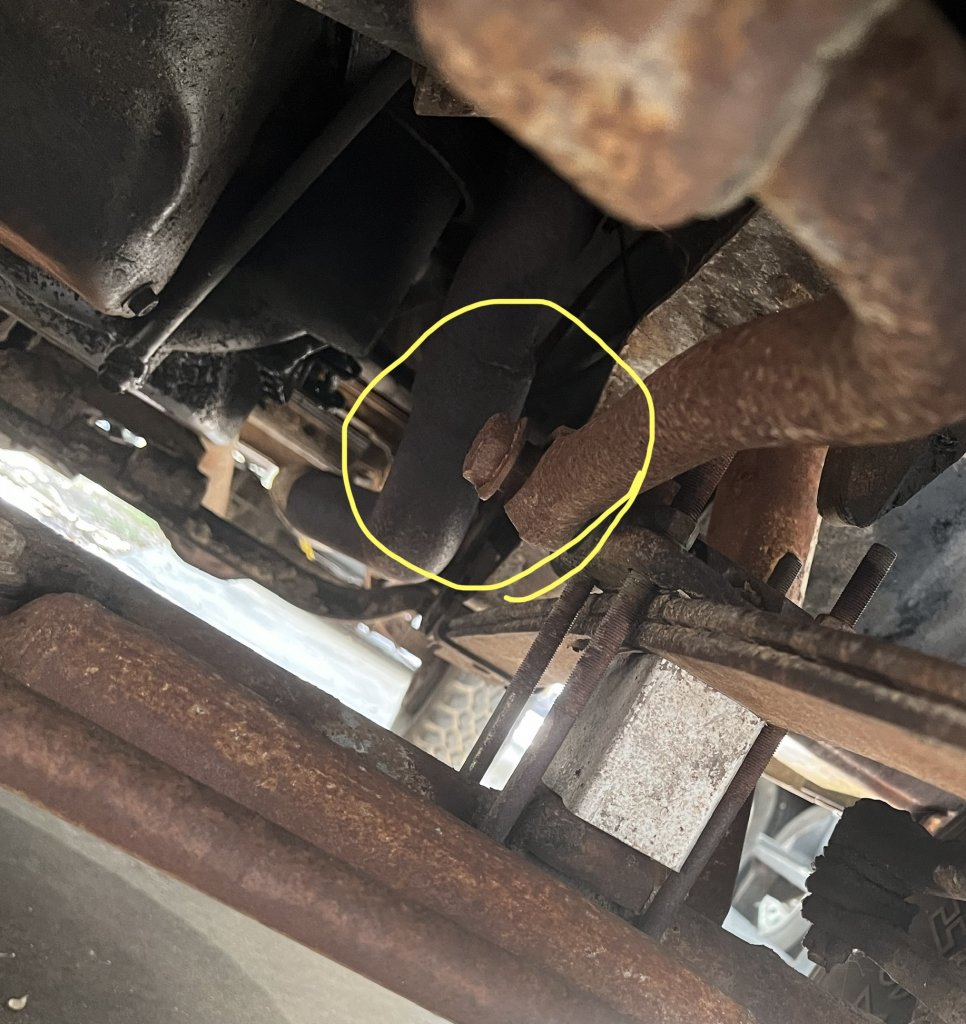

You should absolutely NOT have a block like that under your front springs. That is okay for the rear but not for the front.
Looks like the bushings are gone for your sway bar.

And those shocks are probably maxed out on length. Front blocks are a bozo-no-no, And are probably half the problem with your steering

Ok, so remove the blocks. What is normally used for body lift up front? like cab mounts/ bushings & look for a bushing kit.
Maybe the missing missing swaybar bushing is more the cause of the sloppy steering than the steering box?
1. New springs from the supplier of your choice. I went with Skyjacker SoftRide springs with a 2.5 inch lift. Measure your block thickness, decide if that is the amount of lift you want and get new springs. Order the bolts, U-bolts and correct bushings also. In my case, the Skyjacker used a different size bushing than the OE springs and factory bushings wouldn't fit.
2. Nope. If those bushings are gone, you probably have a lot of wear on other parts. Get someone to sit in the truck and move the steering wheel side to side while you crawl around looking at every steering component. A very tiny amount of visible movement translates to a lot of slack at the wheel.

Check the ball joints as well. Check everything, that spacer is scarry.
Probably needs a complete rebuild.

Is that a picture of the truck on the ground with tires on? If so those shocks are pegged out just like that.

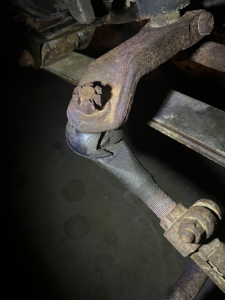

I glanced over it all and didn’t find anything else missing/ torn, except this., although there is no play at all.

Dan, I surely don't want to discourage you but that truck needs a lot of money and effort to get back in decent driving condition. Please remember I am trying to help you here, I promise you I am NOT criticizing you, your truck or your situation.
The blocks under the front springs are a definite NoNo. Seeing that and the incorrect U-Bolts from your previous thread on the rear tells me that someone did some sketchy things with that truck.
The pic with the torn rubber boot on that steering joint also tells me a lot. That steering arm needs to be roughly parallel with the springs. You see the extreme down angle from the solid arm coming from the steering box? That makes your steering difficult and wonky right there. Most lift companies sell a "drop" arm just for that. Really, any front lift over 2 inches needs that drop arm.
Your front shocks are not helping you at all. They look to be almost fully extended right now, although I could be wrong. A set of shocks from any of the lift/suspension companies built specifically for the lift height you have will make a huge difference in ride quality and safety.
I have been in the situation of not having enough money and time to do the work my vehicle needed. I can absolutely see that someone who owned that truck was in that situation. I hope you keep working on it a little bit at a time until you get it like you want it and like it needs to be.
Honestly, my own truck would be a lot nicer if I had enough money to do it completely right. I have to make improvements a little at a time. I probably won't ever get mine perfect.

Great advice from everyone. I just have to add, I've never seen a spring pack with just two leafs. Maybe an attempt to soften the ride, leafs were removed causing the suspension to bottom out much easier.
Yes! So, this must be the reason for the bottoming out. That makes sense. I will be removing the blocks and switching to 3" lifted springs, so I guess that will take care of that. Thank you!
