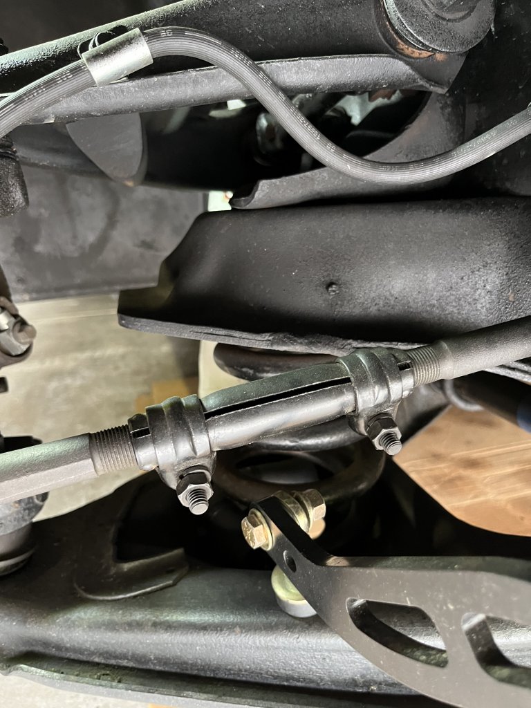

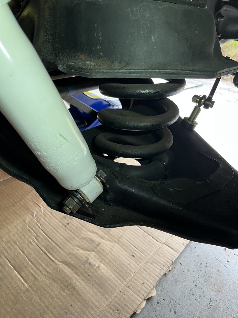

And another 2 photos of the front end

It may be hard to photograph but look at the back side of the spindle where the axle is pressed into the knucle casting. If it's down by the lower ball joint then it's a stock spindle. If it's closer to the upper it's a lowering spindle.
Coilovers are not a bad option but their ride quality is very dependent on how you setup the shock an what spring rate you choose.

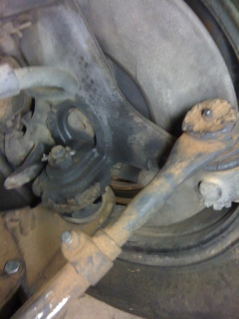

Does this pic show what you mean bluex?
I might have to get back under the truck and get another pic
No you need to get a picture like the one below. If the axle is low like that then it's a stock spindle.
If you could get a picture of the back side of the spindle thats the best way to tell. Kinda like this one. Which is not a drop spindles.

This is my formula for a decent riding lowered square, it won't ride like a caddy but everyone I've done the customer is always pleased with the out come an I believe they ride better than stock setup like this.
For the front start with a drop spindle. They don't alter suspension or shock travel an should always be the first choice. If you want more than the 2.5" or 3" the spindle gives then get a drop spring. Avoid the 1" ones though as they usually will actually raise the truck over a worn out stock spring. Go with a 2" or 3" spring for your desired drop amount. Top that off with a stock length, replacement shock without an extender. I use KYB GR2s. The spring is the only thing that affects shock travel an the KYB Front shocks have enough travel to lay the crossmember on the ground. There's no need for a drop shock in the front.
On the rear I use a flip kit, the notch is optional if you aren't hauling or towing but the factory bump stop an bracket must be removed an replaced with a low profile urethane bumpstop. Shock extenders an stock replacement KYB GR2s here as well. You've got to have the extenders to use a stock length shock on the rear. They also correct the working angle of the shock so it can perform better.
If you follow this, an align the front end to have as close to +5* caster, -0.5* camber an 1/16" toe in you should have a good riding an handling pickup. Add a front sway bar too if it doesn't have one.
Good luck. Based on your description an the picture you probably have el cheapo drop shocks or bad/worn ones an springs that are either cut to much or heated in the front. I've seen it alot unfortunately. The front doesn't look low enough to have a drop spindle on it from the picture.

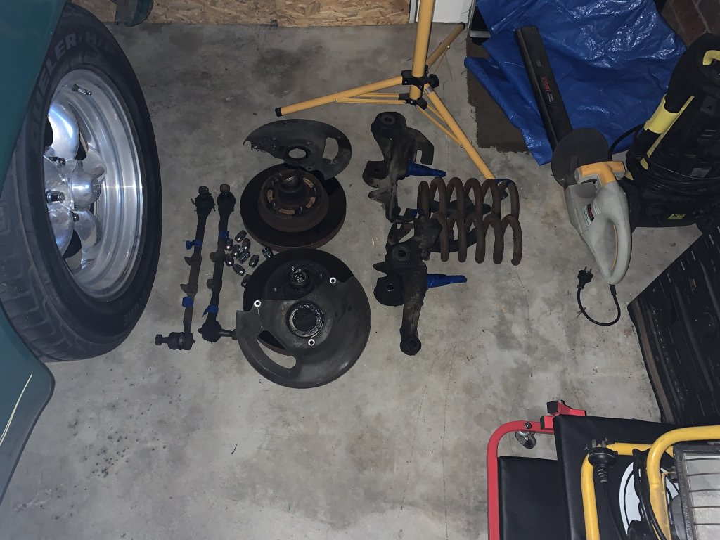

The axle isn't hitting the frame, I'm not putting any weight in the back of the truck, it's just a sunday driver.
I'm looking into a new set of springs for the front, I'll have to pull the front end apart to try and work out what spindles are in it.
