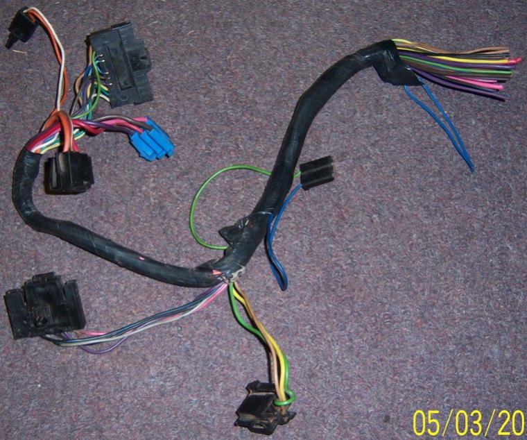

Hey Sportsmom or Mr. Sportsmom??? Where you guys been??? This thread got so old I lost it and couldn't find it. Had to jump thru hoops to find you and your posts since its been so long.
But, I got something for you guys. I wanted to get the whole steering column harness, but it all hooks into mega differant places behind the fuse block. Its not just a simple plug in at one end then hook up all your plugs and done. So I cut it off right at the fuse block. This way you can see all the wires, all the plugs, and where they go. Just match up your wires in question and follow this harness as a schematic by color and size of wire. Also, if you need to splice some wires, then you can rob wires from this harness and use them if yours were cut off to short.
This harness if from an 86 with V8/700r4 Silverado with PW and PL. Should be very identical if not exact.

I posted this originally for Sportsmom to get her son's truck wiring figured out. Mr Sportsmom has it all worked out and the truck have been running for a month or so now. Problem solved.
