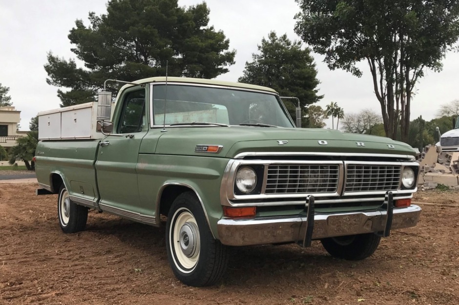

I feel like you would be the guy to inadvertenly own a set of tool boxes off an old f series contractor special.
and probably dont even know it.
