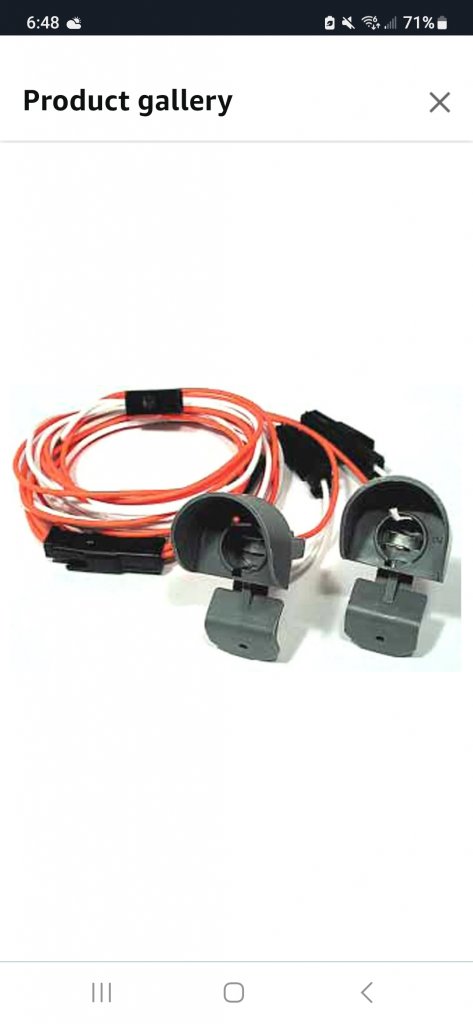

One of which is the courtesy light,
Shown here purchasable from summit etc...i dont even know where it goes, if anybody has it set up properly I'd love to see your setup

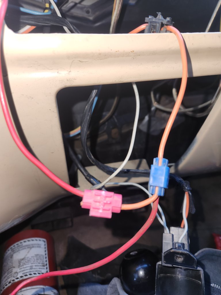

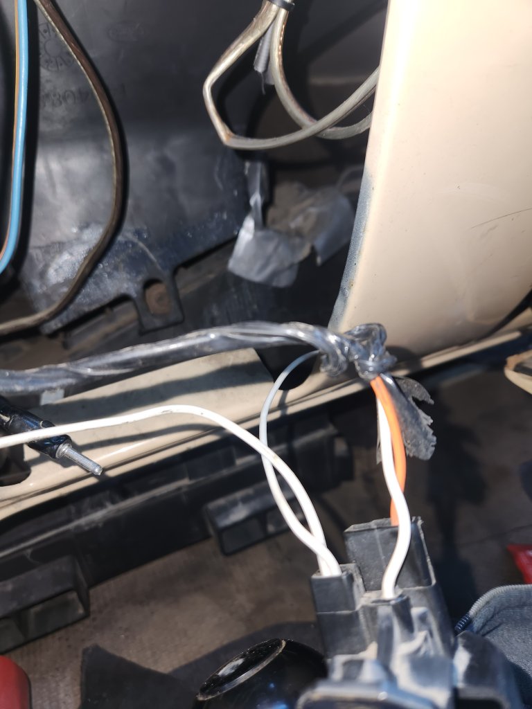

Now, ill jist explain what's what here, there's 4 wires, 2 per group
1st group: Orange wire and white wire take off taped up (badly) and I lose it under the steering column...I image it's a power wire, (orange) and the white is no clue..
And the two white wires go to driver side door grommet, and passenger side door grommet.
I dont have the buzzer (cicadas) woth key on, either that's been removed or doesn't work.
I have 12volts at this light plug at all times. Doors open doors closed. Key on, ACC, Run, and engine running. I put a bulb in, and nothing, so bad grounds?
I think the door jams are the grounds, but how the heck do I remove these grommets to inspect them, or check them? And if orange wire is power, (12v) whats the other white wire, buzzer???
And what's the correct function of a light like this? Is it like modern cars where when door is open the light turns on?
I have a dome light, that ONLY works when I turn the light switch dial to click on that's it, stays on until intirn dial other way.
Im useless at electrical and any help is appreciated. And where would a courtesy light like this bolt up to?

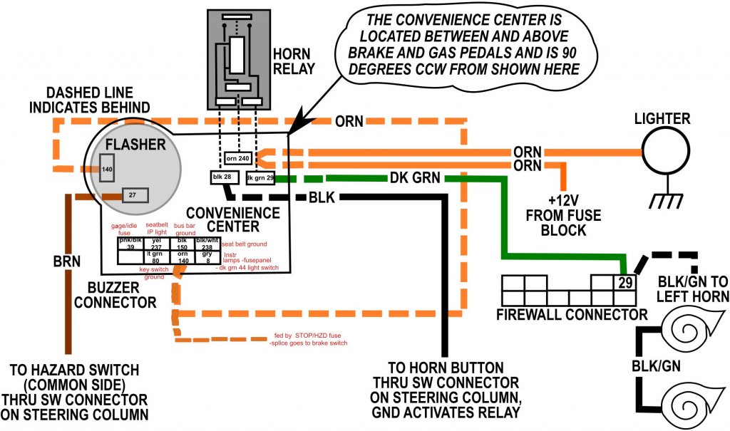

A
The door switch gets constant 12V from the orange wire. When you open the door, the switch grounds, completes the circuit and powers the courtesy light

The convience center is next to the gas peddle. Turn on the hazards and listen for the relay. It is plugged in right there.

For dome and courtesy lights orange is hot always hot and white is switched ground operated by the headlight switch or the door switches. Unmolested there should be 4-5 grounds bundled and grounded under the dash and the orange splits somewhere under the the dash I think above the pedals ish.
Cig lighter is a different circuit

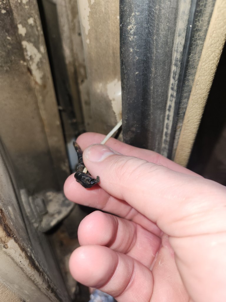

Well... this explains a lot. Lol ummm guess I'll be ordering two of these. This is driver side. Passenger has one but I think it's rusted more innthe 3 mins since I last looked at em...
