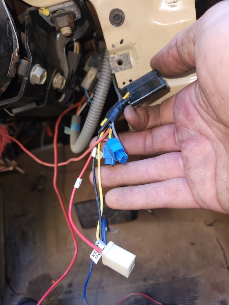

Yessir. Driver side is all tape.
Passenger side... last time it was touched i was probably in diapers lol.
My napa seems to have em, so I'll hold onto the receipt in case i need to swap it out.

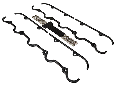

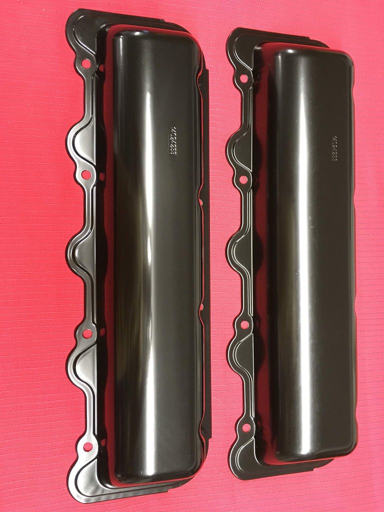

Yeah yeah I know the one, i recently installed these valve cover brackets (pic attached) on my 6.2 the valve covers were just a colander.
Any 6.2 owners there, I did, permatex - cork gasket - permatex - valve cover - brakcet.
Let it cure. Dry. No more leaks. The brackets are lil pricy but worth it. Also applies to 6.5 turbo diesels.
But yeah i remember removing the ground you're talking about.
Coz i removed it for that job. But I'll take it off and clean it up again. Cleaning and tightening grounds is easy and the results are often really noticeable for the amount of work you gotta do.
