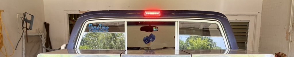

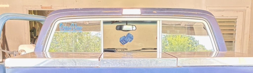

Any advice on how to get this done? I’ve got a factory cargo light, and I bought the United Pacific LED replacement for its bulb/lens. This thing also had red LEDs in it that work as a 3rd brake light. I know where to wire it up at the brake switch, or at least I think I know hahahaha! What I can’t figure out is how to fish the wires down to the floor to run under the door sill plate and up to the brake light switch. I took the cargo light off and also the cargo light switch out and tried to push some baling wire through but just couldn’t get it. Any tips on how I can get this to work?
