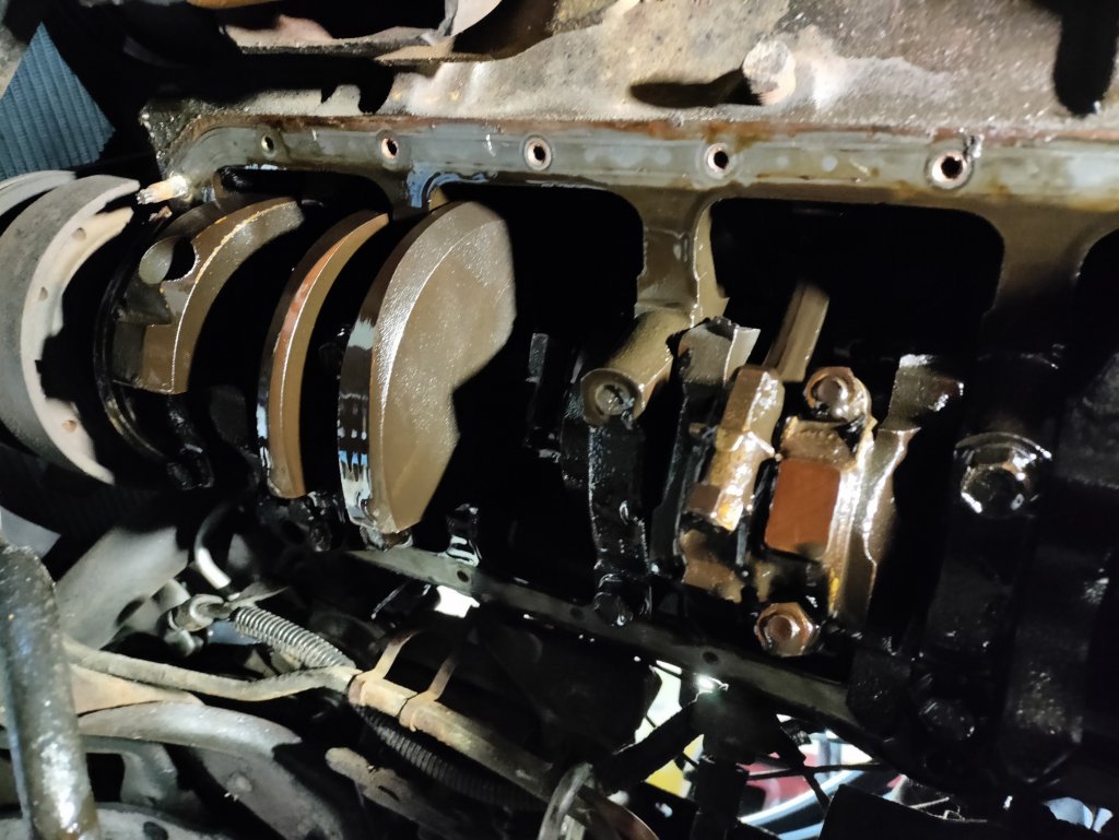

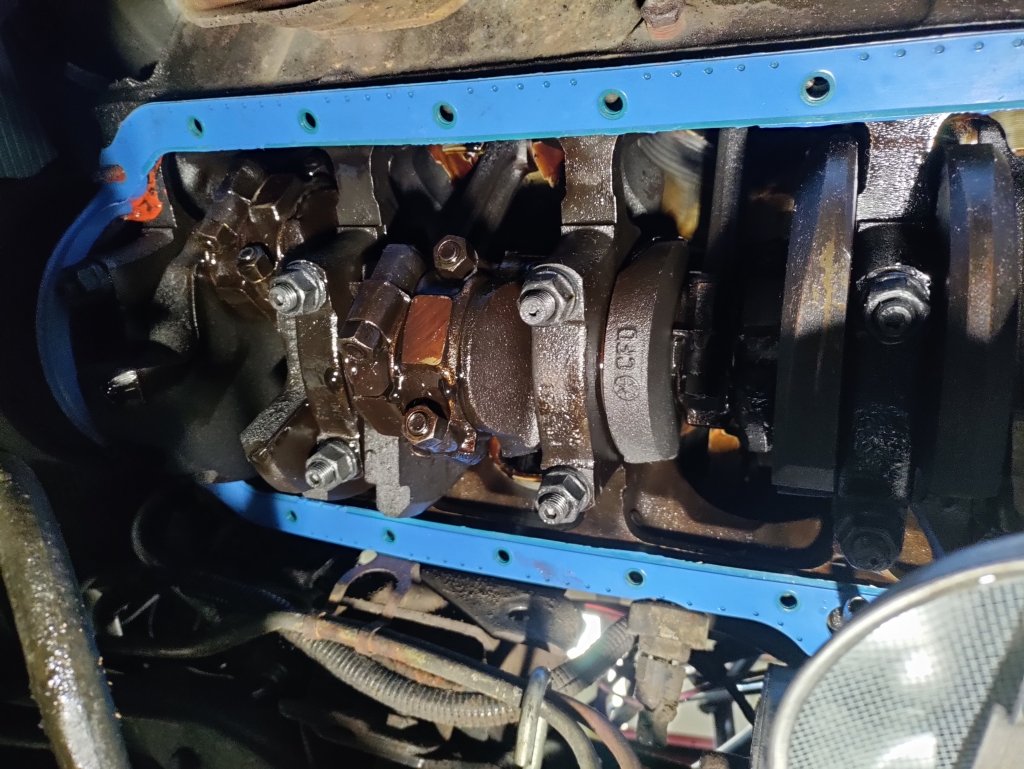

Has anyone had this happen? Dropped oil pan to put new pan gasket and oil pump in,and found bolt head in pan.Ends up it came from main bearing cap, cap still on with one bolt. I replaced all main bearing cap bolts with arp studs and a new oil pump, oil pressure is better due to crud removal and all seems fine

I'm glad it worked out. I've had a few motors change clearances after stud installs.
Typically you need to line hone with studs as they apply pressure differently than bolts and are only installed hand tight if I recall.

Did you roll new bearings in? Curious what the date stamps were.
Maybe someone has been into it?

no new bearings, only actually removed the one cap to get out broken bolt. all other caps stayed put while I changed from bolts to studs. I went ahead and changed all to studs just for peace of mind, maybe more could break. They are installed hand tight, then torqued to 80 ft. lbs. There was letters stamped on pan rail, random J,H and more, don't know the reason though.

It's amazing how forgiving the SBC really is. In most motors, losing a main bolt and essentially 20% of the total clamping force holding the crank would be catastrophic. I'm amazed the bearing didn't spin.
