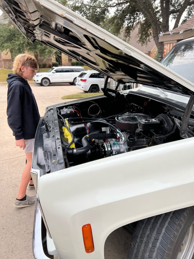

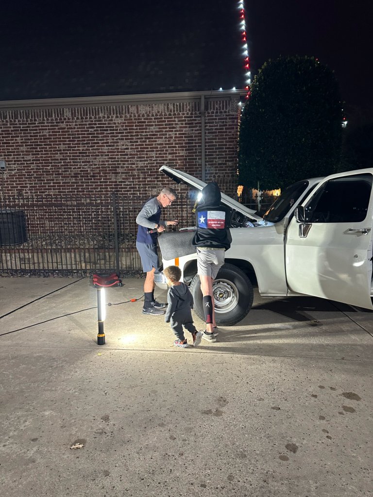

@kalger don’t beat yourself up at all. The guys here have saved us from ourselves a bunch of times ! missing something simple. It has been great messing something up and getting help to fix it. Easton (he’s 16 now but he bought truck when he was 14) has learned it’s ok to make a mistake and to ask for help, he has learned humility. Most of all he is learning to help others even when it may be inconvenient, which is a priceless trait to possess. The guys here have true servants hearts! We try to help others when we can, it’s just so great being part of this forum!

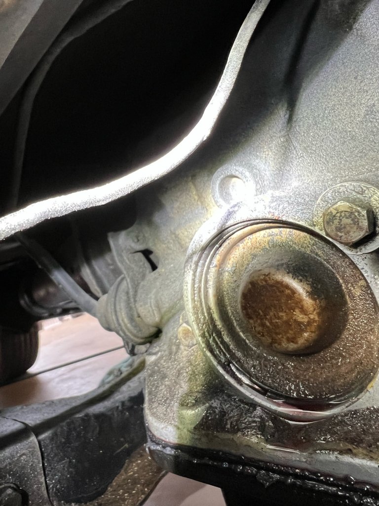

@kalger is that not the greatest feeling ever? we are on our last leak at the moment…. Plotting our strategy…
