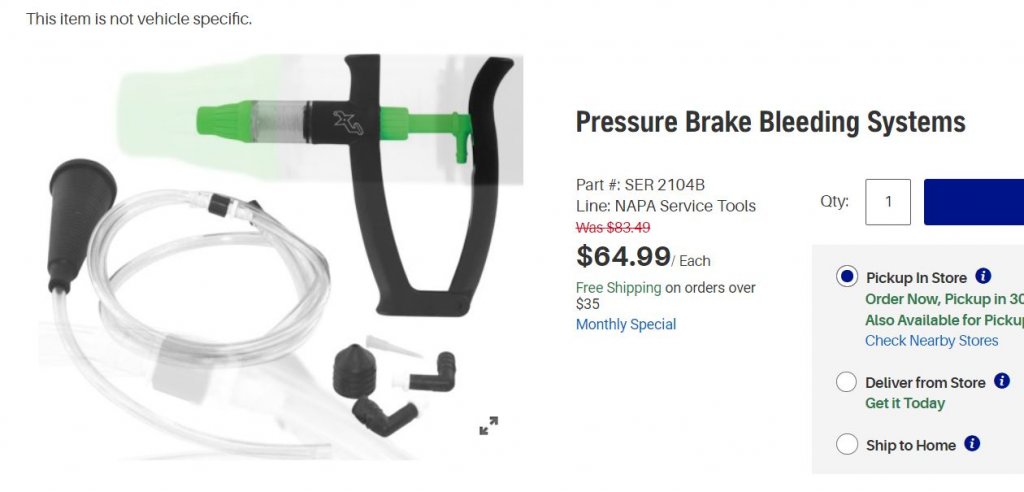

Exactly! Or do what I did and picked up this handy, one man job, easy-peasy, quick, no-cussing item from Napa. You can actually bleed a dry system, (incl the MC) if you take the time. It's worth its weight in gold, especially when it came time to bleed the hydraulic clutch. You think the brakes are a PITA? lol

Its important to note if you use the handy dandy tool, you will still need to actuate the brake pedal to get the air out of the piston in the MC(not constantly, but every once in a while after you pump the fluid up to the MC you should give it a pump). I agree this thing is worth its weight in gold and well worth having in any shop.

True. I just used a piece of 2x4 between the brake pedal and the steering wheel to keep the MC valve open.
