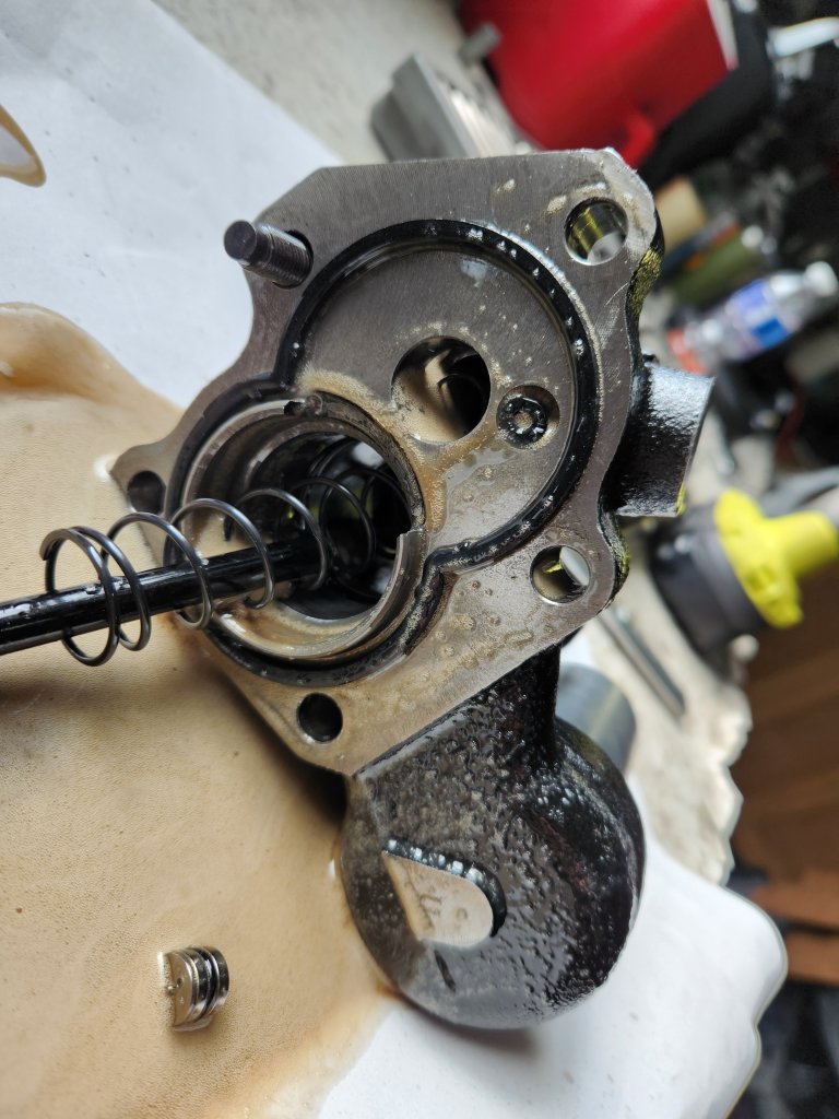

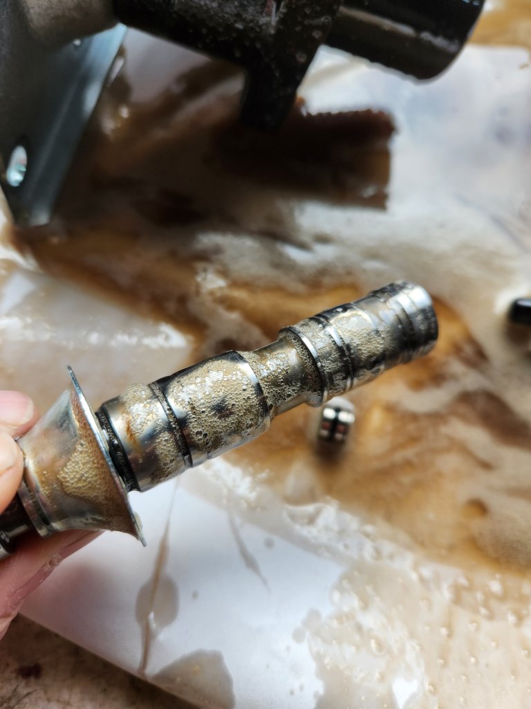

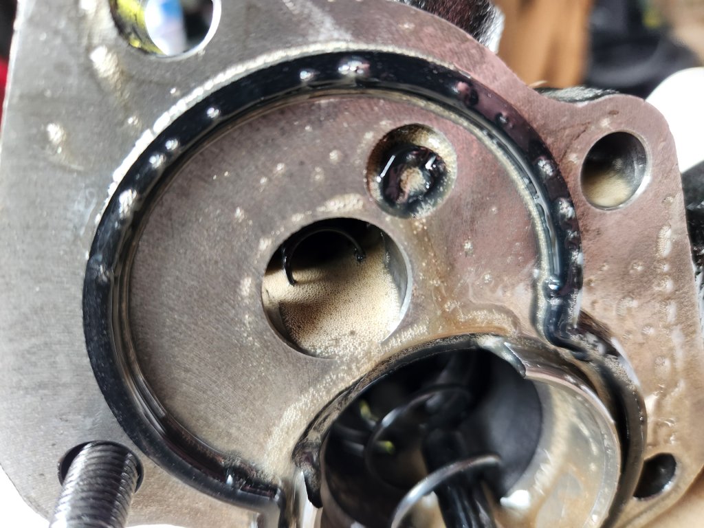

Update mostly for fun. Ran some errands in the beast and after 20 mins of city driving the brakes went to crap. So, I got a wild hair and tore apart the PS pump and did a rebuild on it just cause.
Didn't see anything wild that stood out. Very little derbis. Nothing was clogged. Lines were free and clear. Vanes in decent shape. Didn't notice any excessive wear or scoring on anything. Little mesh screen was clean.
Slammed it together and gave it a whirl.
Not much of a change in how things felt. Figured I'd pull the booster apart cause I got nothing to lose at this point.
I know it has a spring in it. Being gentle and slow to not let it launch apart it had some pressure behind it. Pulling the last bolt and trying to hold it together it physically out powered my meat claw and blew apart with a explosive "poof"!
Fluid and parts shot all over like a geyser (safety glasses kids). I left it overnight before taking it off. Guess the accumulator works.
Put everything together and went for a short drive. Steering still feels great as it has. Brakes...ehh. They feel just like when I put the new booster on two weeks.
When I have more time I'll zip it around for a longer time and see if anything has magically healed or not. If I'm a betting man, I'd say no.
Fluid and parts shot all over like a geyser (safety glasses kids). Do they keep residual pressure for a long time? I left it overnight before taking it off. Only reason I can see why is the flush after the rebuilt pump. Wasn't running it dry or low. Either way I assumed the air disapate after a few hours. Could've been me, or some random problem.
Hydroboosts have a pressure accumulator which usually needs to be drilled to vent accumulator pressure to make it safe.
I'm glad you didn't get hurt, but next time maybe RTFM. We also have the Internet these days, you know.

Thanks, me too.
I thought it might have something to do with not pressing the pedal to relieve the hydraulic pressure as one would do in an accumulator test. I looked around online a bit, read, watched what info was available. Dove in with both feet.
The gas charged chamber has to be drilled/vented for a reseal/gasket replacement on the unit?

Thanks, me too.
I'd have to crack the manual again. It's been a long time. My recollection is the accumulator is there to maintain some braking assist in case of an engine stall or hydraulic assist system failure. So you probably could have dumped the fluid pressure with multiple brake applications. The drilling may have been to remove the accumulator itself.
That was the impression I got in all my research leading up to this. Chalking it up to a bone head move by me.
