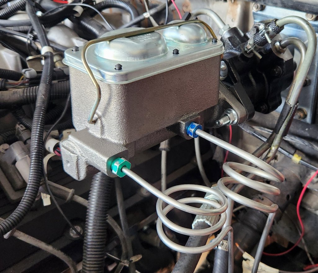

Below is the routing. Return from booster to upper PS port. Pressure from HB to PS box. PS box return to cooler. Cooler to lower PS pump port.
This is the cooler to PS return. Fluid leak was from taking the hose off to see if it was clean and open. Not collapsed, etc.
