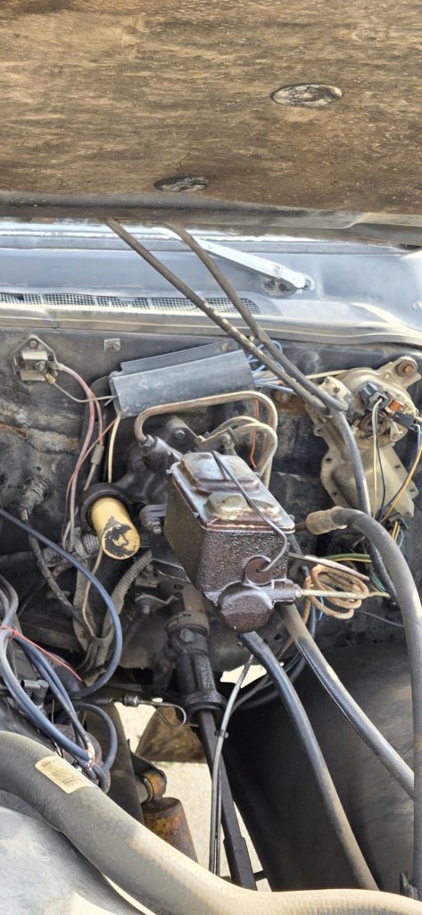

I live in small town nothing and want to learn to work on it myself if possible

Check the accumulator can on the booster...they get loose sometimes, and then the unit has NO reserve power. But it sounds more like a bad MC to me too. Also check all your lines for cracks, leakage, damage....
Not loose and no leaking

Uh; $3,000 for a master cylinder?
More like $75 bucks and 15 bucks of brake fluid.
Pedal doesn’t go to the floor because of a bad hydro boost. There’s a mechanical link from the brake pedal to the master cylinder that the hydro boost only amplifies. That’s either a busted brake line, a blown caliper or wheel cylinder, or bad master cylinder.
I just redid the entire brake system EXCEPT the hydro boost (rebuilt it) on a k35 and figure the cost of brakes was maybe $750, mainly because I bought new drums and rotors.
Can't find any leaks or anything broken
