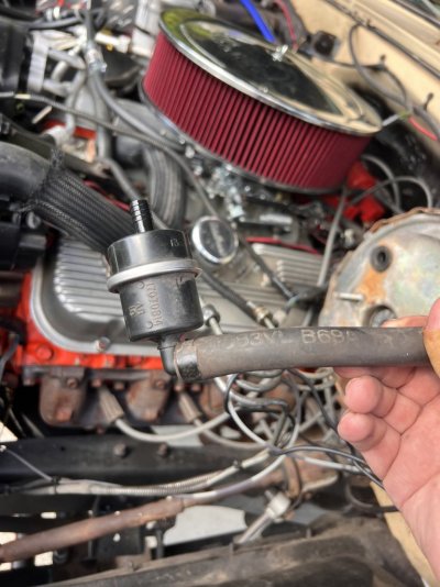

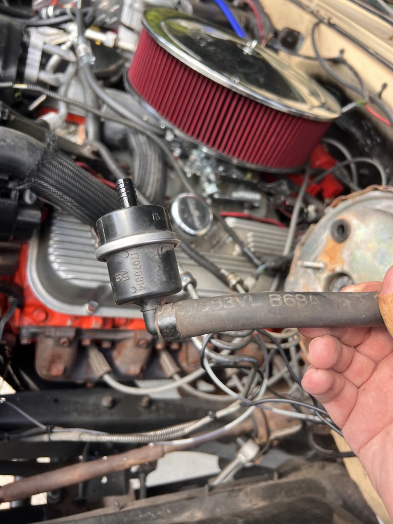

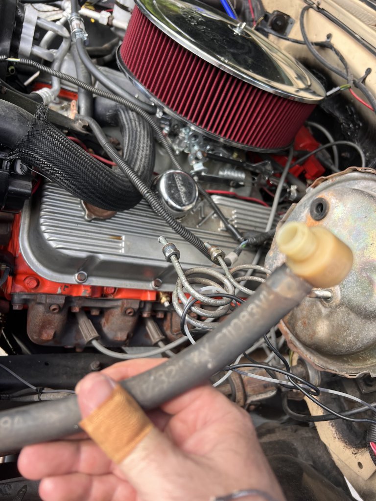

do you know what this is? It’s on the vaccume line before the booster check. Is kind of oily so maybe it’s in there to keep oil out of the booster?
I’m trying to decipher what the last guy did. Some things look solid others I’m suspect of. This one I don’t know
