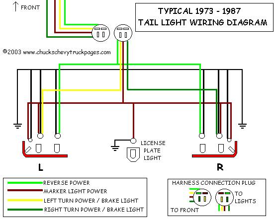

Hello all. New square body owner here; an 1981 C20 Silverado apparently with the "heavy duty" package or whatever it is. The truck spent much of its life in Southern Cali and was very well taken care of so there's NO rust and everything has been kept in good shape. The only issue I'm having is the brake lights; all the other lights work fine (tail lights, signals, etc.), but both darned brake lights aren't working. I do know that the truck had a camper on it a while back (it now has a cap on it) so maybe the wiring was messed with to accomodate the camper. Just looking for someone to point me in the right direction. I'm ok with wiring (not great....just ok) so this will take a little bit of head scratching on my part. Thanks guys. Love the board by the way.
