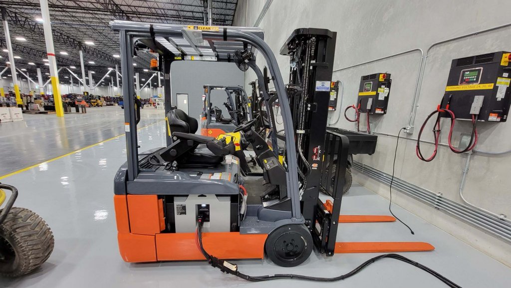

Most lead acid batteries fail due to lead sulfating that falls off the plates, lays across the bottom the battery essentially shorting out a cell. He most likely just rinses it out and reinstalls the acid then charges it correctly.
As a forklift tech, the equipment didn't have any suspension or cushioning except for their tires, if the floor of the plant wasn't flat with no bumps, the jarring of the battery would knock the sulfating off and kill the battery long before it's time. We would or have the battery company come in and change out the failed cell and get it back on the floor. Those batteries are $5-8k each and last about 3-6 years depending on maintenance.
