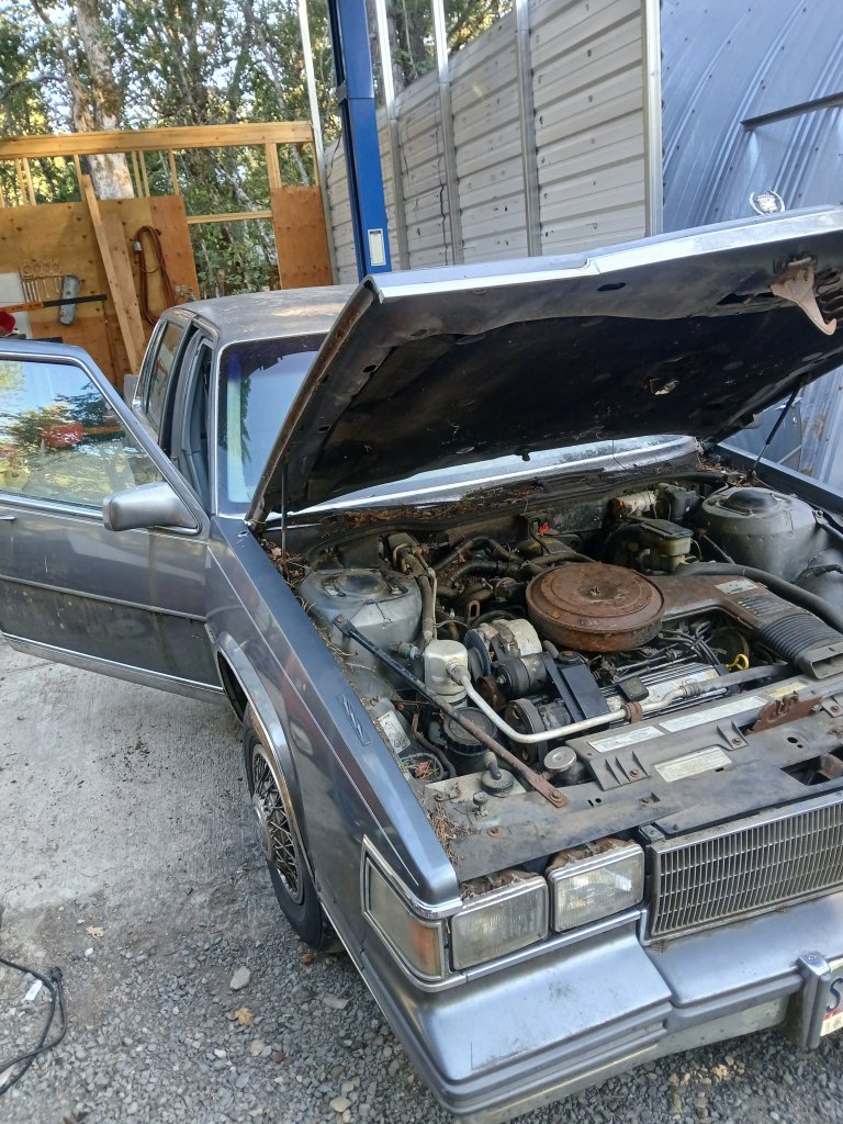

Look what followed me home

Yeah if you can get her purring and cleaned up, kick it down the road and find something that'll be more reliable and easier to work on than that thing. We call those 4100s the 8,6,4,0 for a reason lol
Hahaha and 24 years later the General is still having issues with multi displacement engines. Except they got the technology down now but have durka durka Temu valves and valve springs!

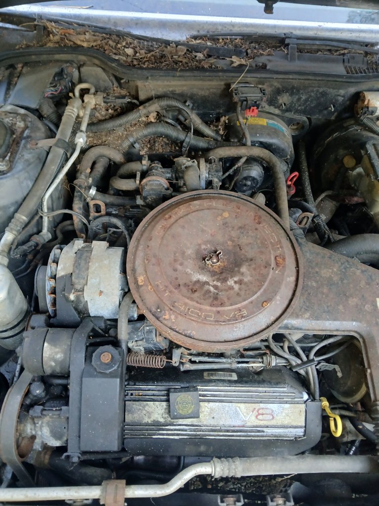

Thank you. Did the 4.9 have a plastic intake snorkel housing? Otherwise did all 3 of those engines basically look the same?
Also this transmission looks to be non electric like an R4?
They essentially looked the same, but they all had differences. 4.9 still had a central throttle body, but it was multi-port injected. From what I remember, yeah, it was a plastic snorkel arrangement.
Trans should be a 440T4, probably has one of the taller final drive ratios that were offered.

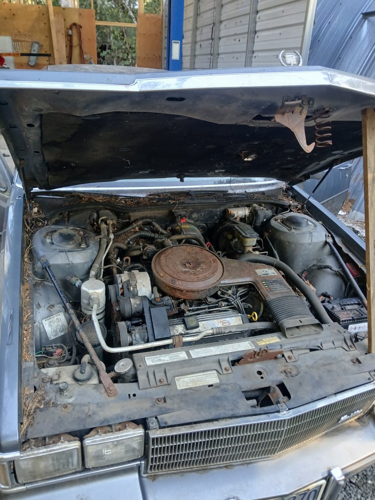

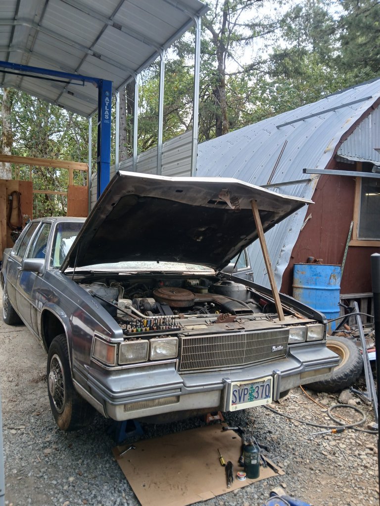

Me and my son have been working on it together. but Sunday night the back of the starter solenoid broke off. We got it pulled out so I can change out the solenoid when I can get one.

The 4100 was a different engine than the '81 4-6-8 motor though.
I don't remember the specifics of the 4100 issues. Pretty sure it was head gaskets and intake gaskets, along with electronic issues.
It was replaced by the 4.5 and was more reliable.
Then the 4.9 replaced the 4.5 and got even better.
Then the 4.9 was replaced by the Northstar.
But uhh...not a one of those is actually reliable in the long term lol

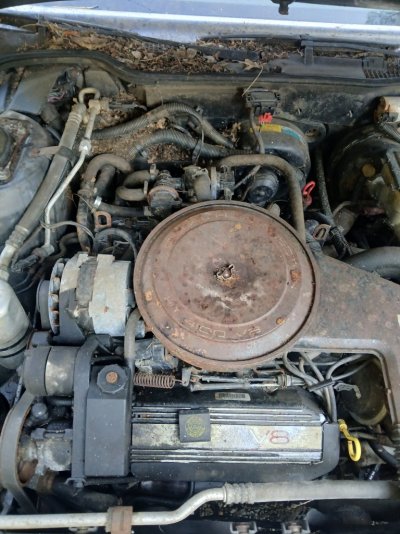

Couldn't i put in an hei distributor w/vacuum advance, or modify existing distributor and slap a carb on it?
35,426
44,736
On the 4100? Probably. But I've never tried converting an ESC HEI to vacuum advance.
